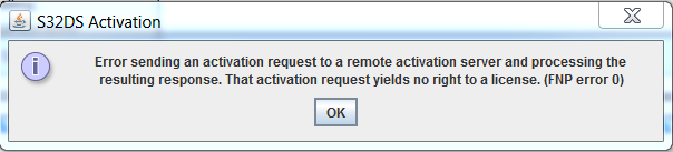

1) That activation request yields no right to a license
If you receive the following error message following an attempt to activate S32 Design Studio, this is a known issue and we have a solution.
This issue is due to a recent event. On October 1st, 2019, Flexera made this change. Since NXP uses Flexera for product activations, we were affected.
The solution to the issue is to enable support for TLS 1.2 within your Internet Properties.

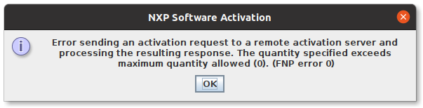

I'm getting the same error code with a different message for both online and offline registration:
The browser I'm using for offline registration is using TLS 1.2.
Are there any other components that need to be compatible with TLS 1.2, such as your installer when installing in online mode?
How do I configure that?
Hello [email protected]‌,
I sent you email directly as well. As our servers indicate a successful activation by you, could you please confirm if the issue is now resolved?
Mike
Yes, it is resolved. The activation code i was given was for another product.

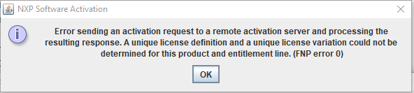

hello sir ,
I am facing same issue .I am using tls 1.2 supported browser.How to resolve this issue.help me regarding this
Could you please share the screen capture of the exact error message you received as well as the following log file?
"C:\NXP\S32DS.3.2\_S32 Design Studio 3.2_installation\Logs\S32_Design_Studio_3.2_Install_<date and time stamp>.log"
Mike
hi,I am facing same issue,and my windows TLS 1.2 is enable,but  it still won't install,the error information is the same “that activation request yields no right to a licence”
could you give me some help?
thanks very much!
I'd install S32DS before, but it showed error message occasionally, so I removed it.
Then I downloaded other S32DS again (S32DS.3.5_b220726_linux.x86_64.bin) from NXP website. Nevertheless, It showed above error message when I tried to install and input previous activation code. Pls help!
