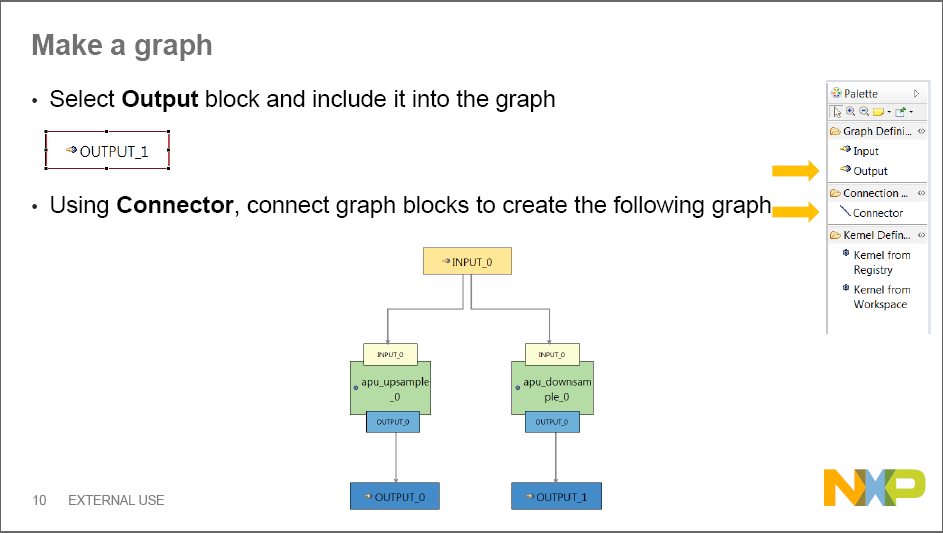

This tutorial walks a user through the steps to create a new application for the S32V234 MCU using S32DS for Vision and the built in APEX2 Visual Graph tool. The completed application will take a PNG image, upscale and downscale it using APEX engines and return the processed images.
Prerequisites:
  • Some knowledge of the S32V234 System on a Chip (SoC)
  • Have an understanding of the APEX architecture and APEX Core Framework (ACF)
    • Refer to UG-10267-03-14-ACF_User_Guide.pdf to learn about ACF
      • Path: s32ds_installation_directory\S32DS\s32v234_sdk\docs\apex\acf
  • Be familiar with the NXP Vision SDK software

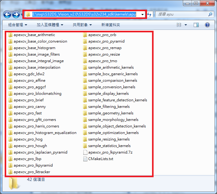

1. I would like to know how to add a custom Kernels. Is there any tutorials?
2. Our customer saw there are some Kernels under s32v234_sdk directory:
        \nxp\S32DS_Vision_v2.0\S32DS\s32v234_sdk\kernels\apu\
Are these Kernels avalible to use? If yes, how can I use them in my APEX2 Graph Project? e.g. apexcv_pro_lkpyramid

2. The kernels you identified are part of the Vision SDK. These can be used within a S32DS for Vision Application Project, but you will need to be sure to add the correct Contributed SDK as shown in:  S32 Design Studio for Vision, Version 2.0 > Reference Manual > Working with SDKs > Selecting SDK in New S32DS Project wizard.
There are examples of projects using kernels from this library in: C:\NXP\S32DS_Vision_v2.0\S32DS\s32v234_sdk\demos. However, while these examples are not S32 Design Studio projects, they do show how the kernel could be used within a project and the methods would be similar for S32 Design Studio. For now, the APEX CV libraries are not supported within the Visual Graph Tool of S32 Design Studio
