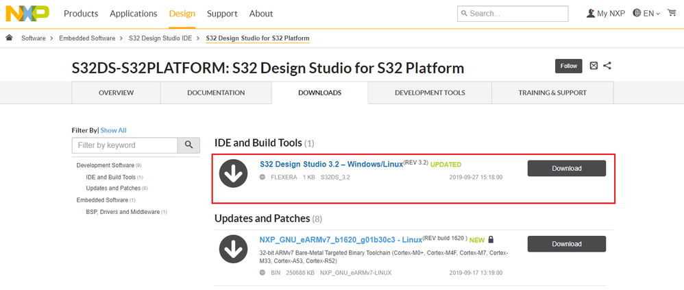

Installation
To download the installer please visit the S32 Design Studio product page download section or click the direct here.
The installer requires the Activation ID to be entered. You should receive a notification email including the Activation ID after the download of the installation package starts.
The installer installs just the base tools/package. In order to start development it is necessary to install at least one Development package. Currently the only application packages available are S32S2xxTV and S32V2xx. The application packages are managed by S32DS Extensions and Updates.
