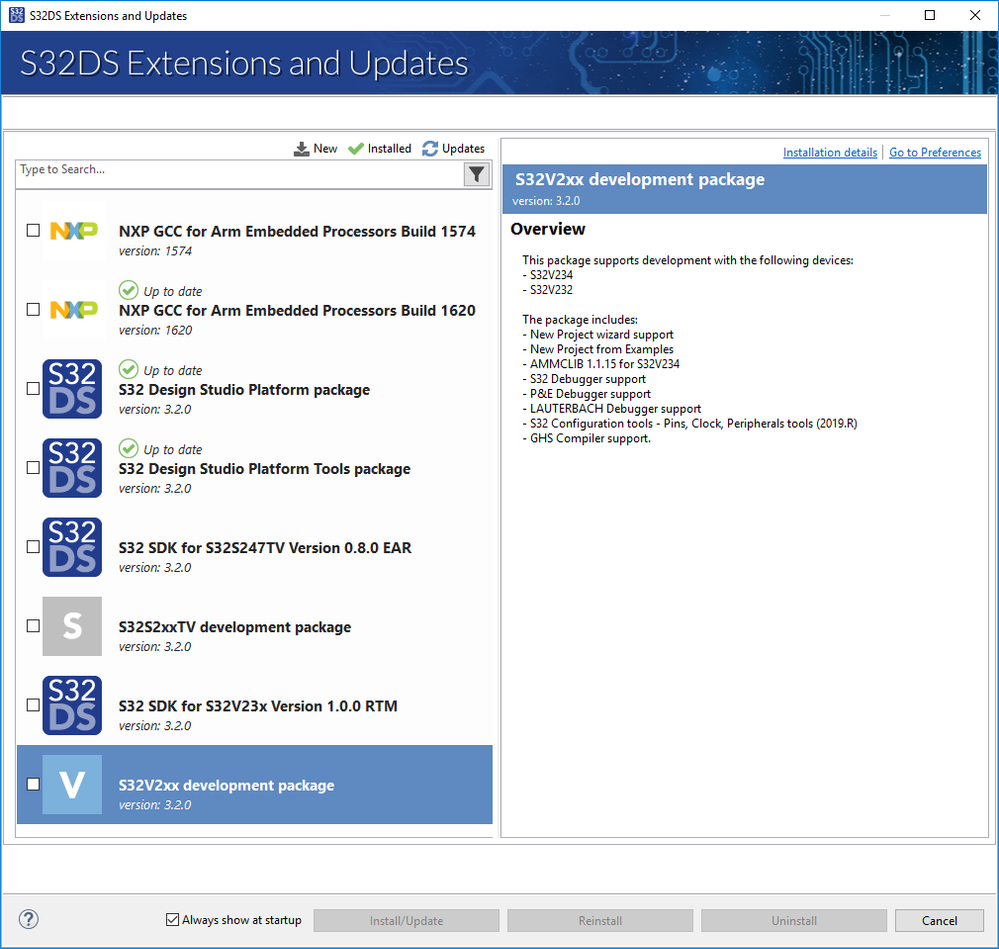

 The Automotive Microcontrollers and Processors' Embedded Tools Team at NXP Semiconductors is pleased to announce the release of the S32 Design Studio for S32 Platform v3.2.  Here are some of its major new features:
  • Multiple builds of the GNU tools can be installed.
  • The SDK integration is provided with additional software packages. The SDK packages can be installed and updated with the S32DS Extensions and Updates tool.
  • The GHS toolchain support is provided by the project wizard (available for particular devices).
  • The CMSIS-DAP debugging is supported by particular devices.
  • The UART communication speed of S32 Flash Tool is improved.
  • The latest versions of P&E debugger plug-in and drivers are provided.
  • S32 Debugger provides OS Awareness support for FreeRTOS and OSEK.
  • S32 Debugger provides preliminary support for secure debugging with the Password and Challenge/Response authentication methods.
  • New type of Launch Groups is defined for S32 Debugger, which allows you to create S32 Debugger specific configurations and use the new "Wait for stop on breakpoint" post launch action.
  • The SDK migration support is provided to upgrade an SDK version attached to the project.
  • The S32DS Extensions and Updates tool notifies about dependencies and incompatible packages.
  • The progress bar is displayed for the S32 Debugger flash programmer.

Installation
To download the installer please visit the S32 Design Studio product page download section or click the direct here.
The installer requires the Activation ID to be entered. You should receive a notification email including the Activation ID after the download of the installation package starts.
The installer installs just the base tools/package. In order to start development it is necessary to install at least one Development package. Currently the only application packages available are S32S2xxTV and S32V2xx. The application packages are managed by S32DS Extensions and Updates.

how to get the "Visual Graph Tools" installed in the "New" wizard in v3.2? The pic below was from S32DS 3.1.
jd
Hello Jim,
The Visual Graph Tools comes as part of Vision Extension Package for S32V2xx v.1.0.0, however, this package is NOT SUPPORTED for S32 Design Studio v3.2. Please continue to use S32 Design Studio v3.1 until we release an updated version of the Vision Extension Package.
Mike
