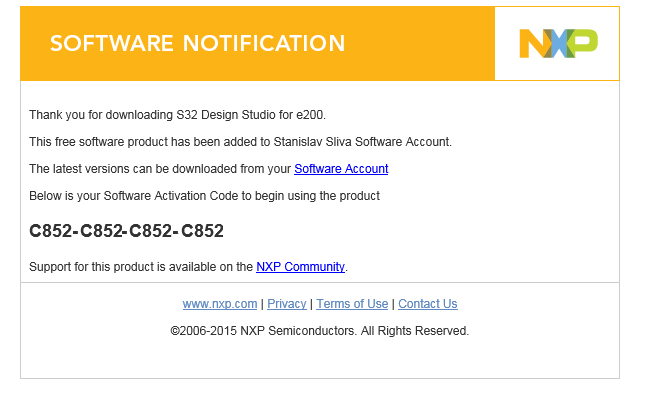

Installation Notes
The installer requires NEW Activation ID to be entered during the installation. You should receive an email including the Activation ID after starting the download process e.g:
