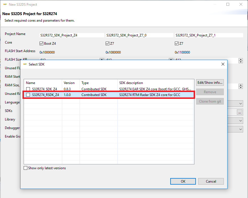

  • Radar SDK RTM 1.0.0. This is a cumulative update - it includes all of the content of previous updates (Update 1Update 2Update 3).

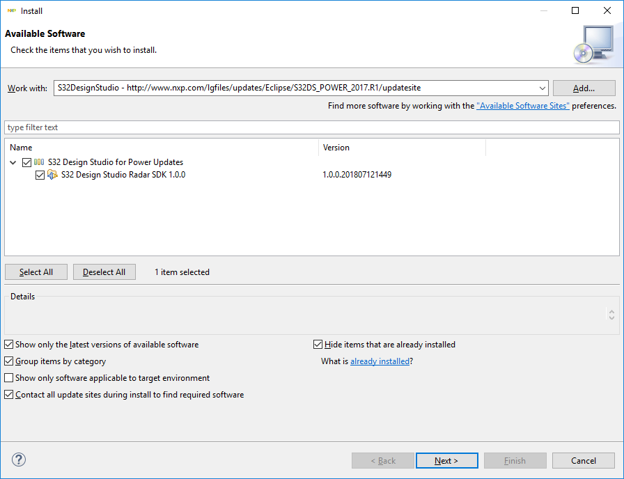

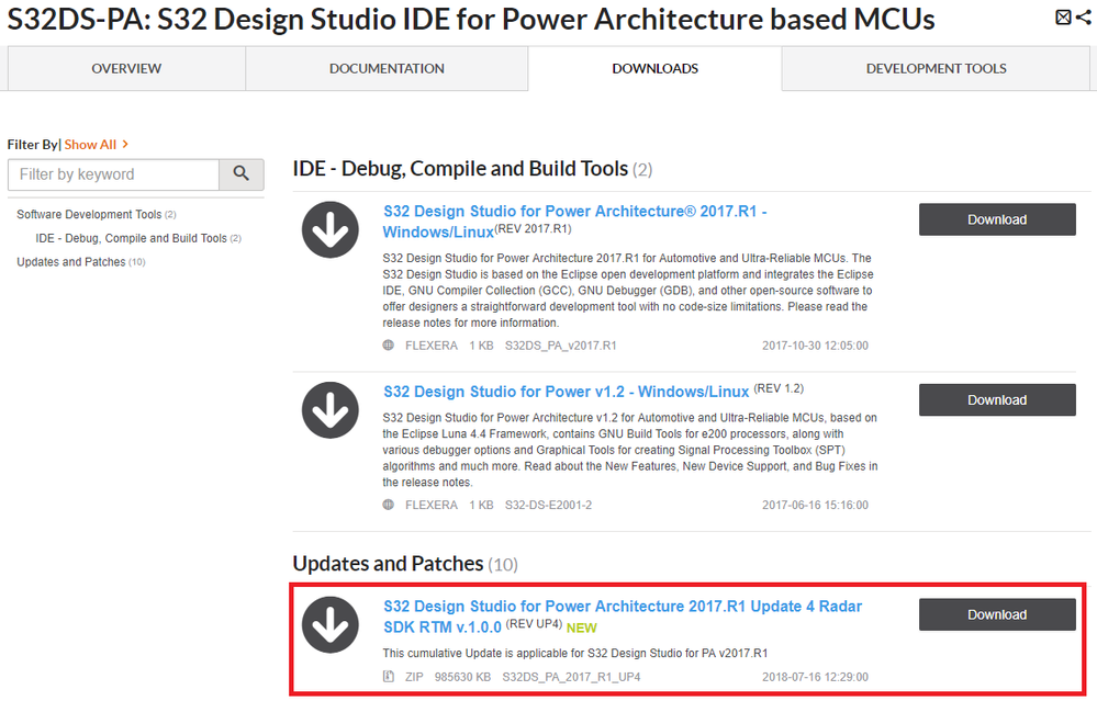

The update is available for online (via S32DS Eclipse Updater) or offline installation (direct download link)
  • offline installation:
    • go to S32 Design Studio for ARM product page -> Downloads section or use  direct link to download the update archive zip file pastedImage_121.png

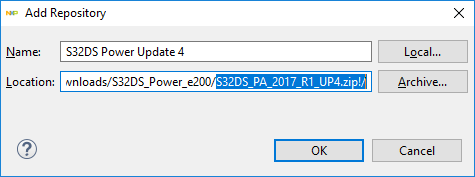

      • Start S32DS and go to "Help" -> "Install New Software..."
      • Add a new "Archive" repository and browse to select the downloaded update archive zip file you downloaded in the previous step
      • Select all available items and click "Next" button.
This will start the update installation process.
