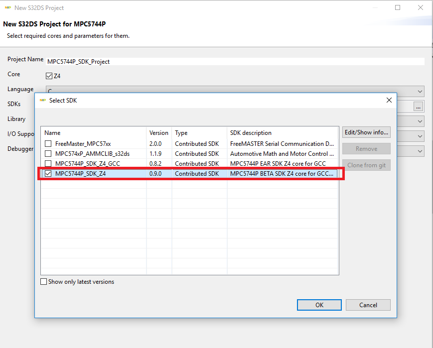

  • S32 SDK for Power Architecture 0.9.0 BETA for MPC574x-B-C-G and MPC574xP derivatives (see attached release notes for more details)
  • S32 SDK  Power Architecture v0.9.0  BETA Examples - "Create S32DS Project from Example"pastedImage_8.png

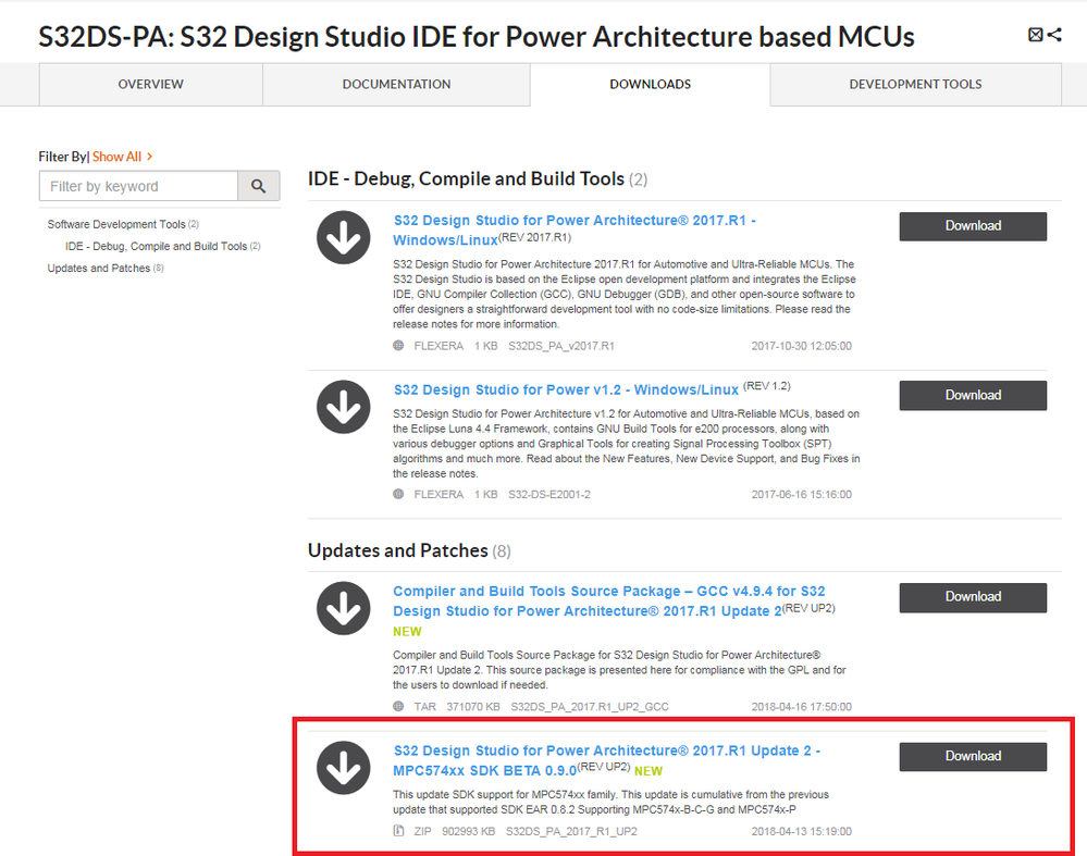

The update is available for online (via S32DS Eclipse Updater) or offline installation (direct download link)
  • offline installation:
    • go to S32 Design Studio for ARM product page -> Downloads section or use  direct link to download the update archive zip filepastedImage_2.png

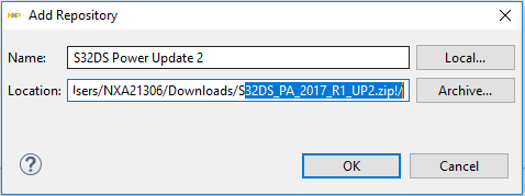

    • Start S32DS and go to "Help" -> "Install New Software..."
    • Add a new "Archive" repository and browse to select the downloaded update archive zip file you downloaded in the previous step

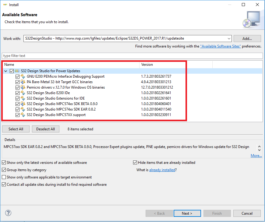

    • Select all available items and click "Next" button.
This will starts the update installation process.
