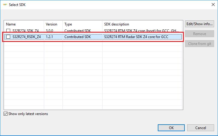

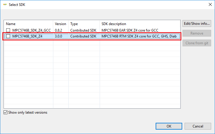

S32 Design Studio for Power Architecture 2017.R1 Update 11
What is new?

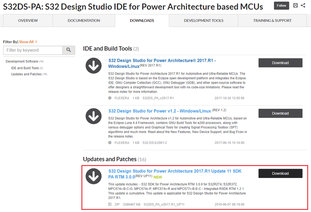

The update is available for online installation (via S32DS Eclipse Updater) or offline installation (direct download link)
  • offline installation:
    • go to S32 Design Studio for Power product page -> Downloads section or use direct link to download the update archive zip file pastedImage_2.png

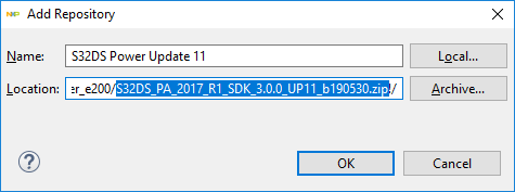

      • Start S32DS and go to "Help" -> "Install New Software..."
      • Add a new "Archive" repository and browse to select the downloaded update archive zip file you downloaded in the previous step

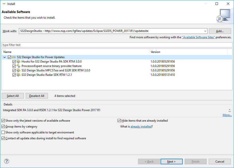

      • Select all available items and click "Next" button.
This will start the update installation process.
