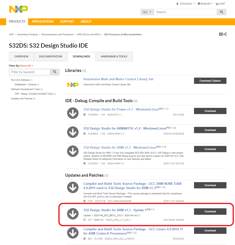

For online installation please select predefined NXP repository in "Help" -> "Install New Software..." dialog and proceed to installation.
For offline installation please go to S32 Design Studio product page -> Downloads section and download the "S32 Design Studio for ARM v1.3 - Update 1" file:

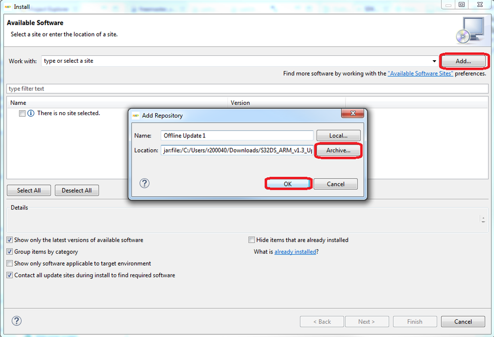

Then start S32DS and go to Help -> Install New Software...
Add a new "Archive" repository, browse to select the downloaded file:

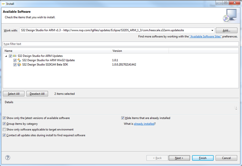

Tick all the update items and proceed to installation.
The main new feature is beta S32K SDK v0.9.0.
