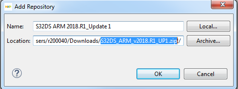

  • offline installation:
    • go to S32 Design Studio for ARM product page -> Downloads section or use direct link to download the update archive zip filepastedImage_1.png
    • Start S32DS and go to "Help" -> "Install New Software..."
    • Add a new "Archive" repository and browse to select the downloaded update archive zip file you downloaded in the previous step
    • Select all available items and click "Next" button.
This will starts the update installation process.

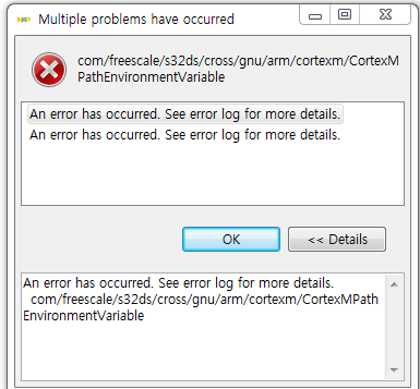

I called the sample code S32K116 by executing it in the way you suggested.
However, the following error persists. How can it be solved?
