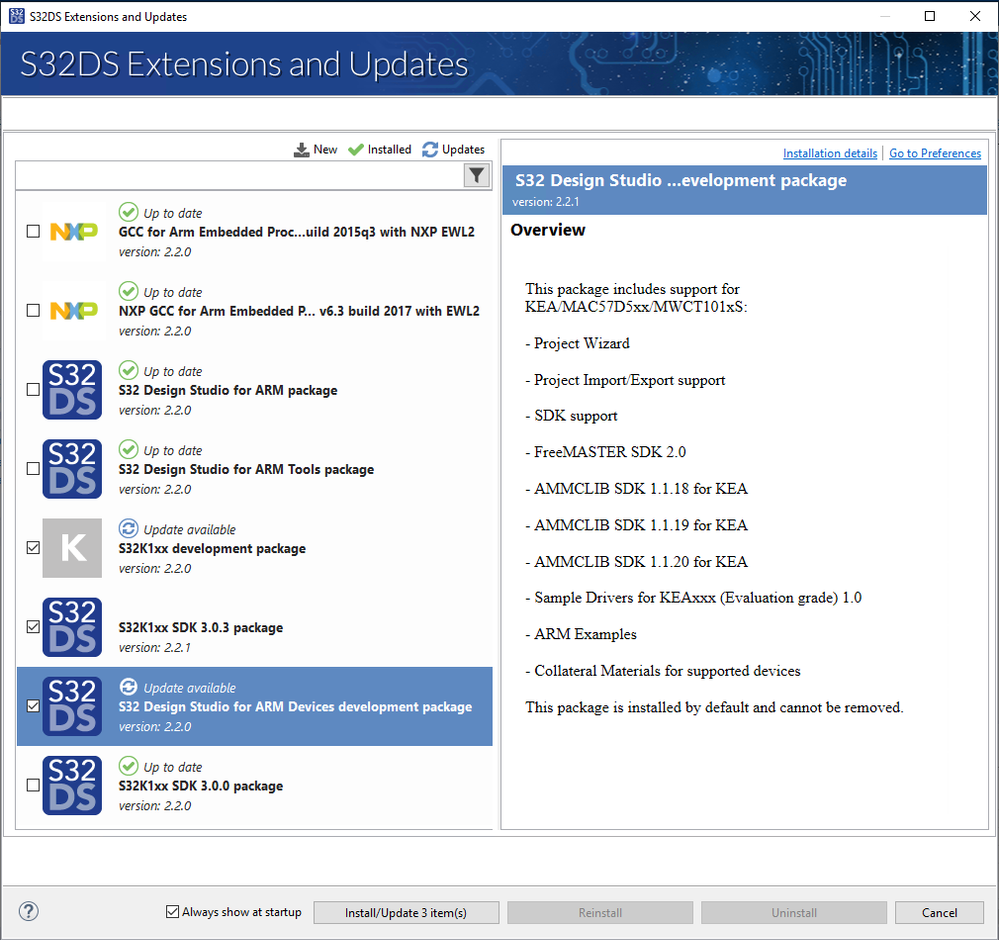

  • online installation:
    • go to menu "Help" -> "S32DS Extensions and Updates" dialog
    • check boxes next to "S32K1xx development package", "S32K1xx SDK 3.0.3 pakage" and "S32 Design Studio for ARM Devices development package"
    • click "Install/Update 3 item(s)"

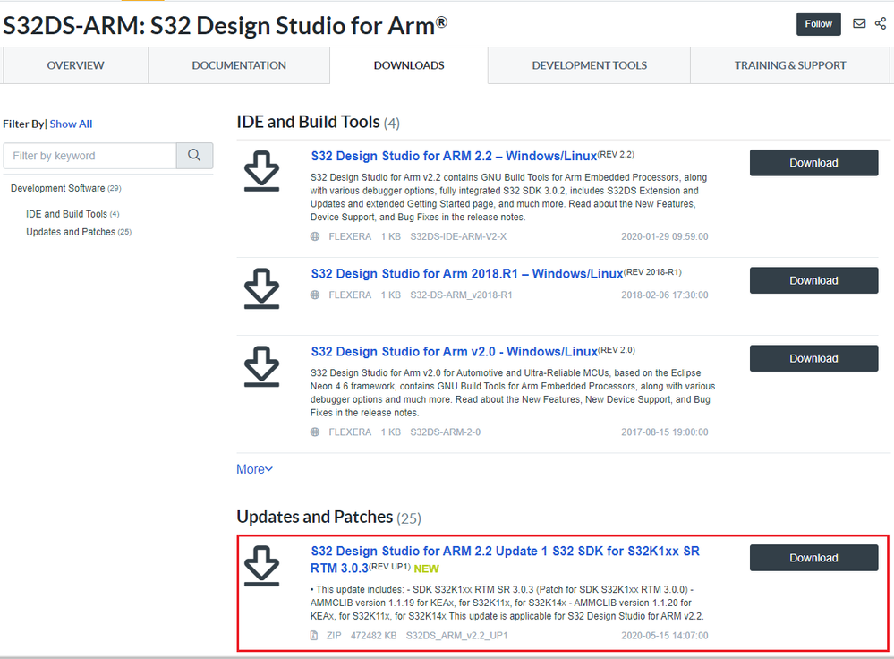

    • go to S32 Design Studio for ARM product page -> Downloads section or use direct link to download the update archive zip file

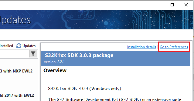

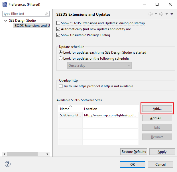

    • select "Go to Preferences"

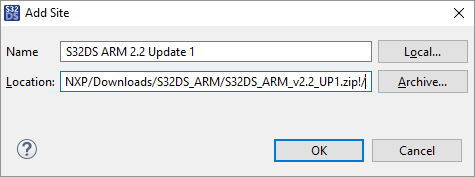

    • Add a new Software Site
    • Add a new "Archive" repository and browse to select the downloaded update archive .zip file you downloaded in the previous step
    • check boxes next to "S32K1xx development package" and "S32 Design Studio for ARM Devices development package"
    • click "Install/Update 2 item(s)"
