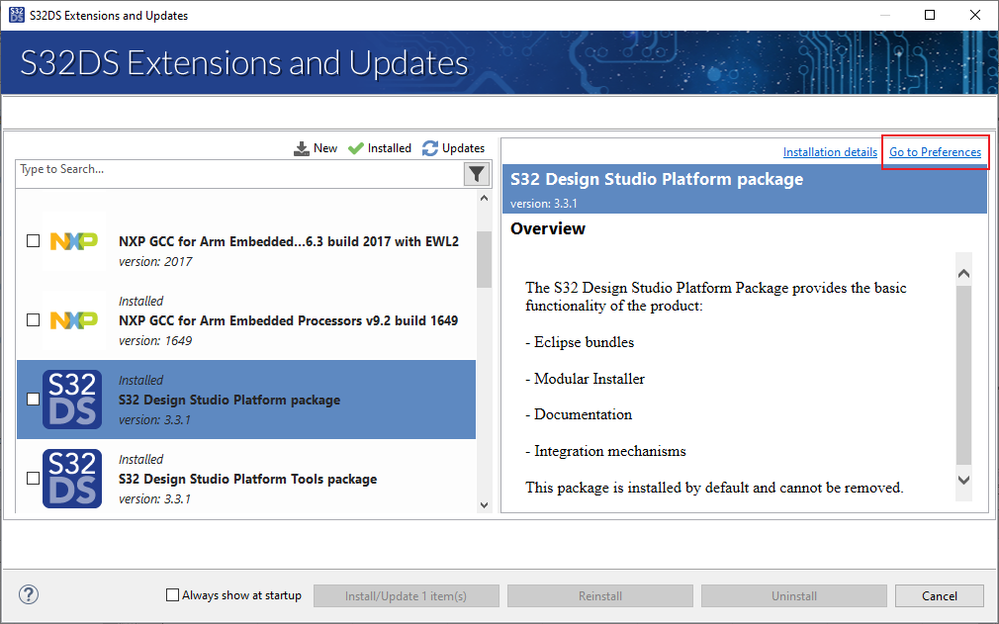

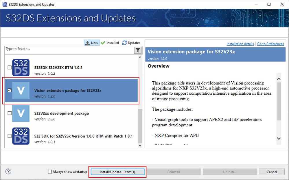

    • go to menu "Help" -> "S32DS Extensions and Updates" dialog
    • select from available items and click "Install/Update" button

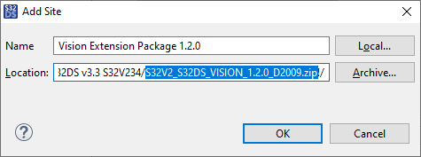

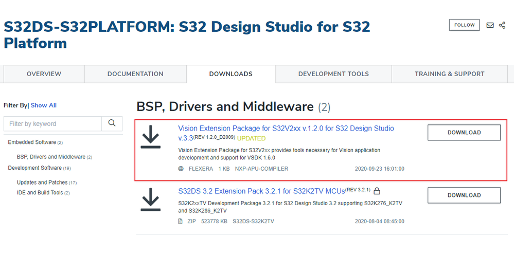

    • go to S32 Design Studio for S32 Platform product page -> Downloads section or use direct link to download the update archive zip file
    • Start S32 Design Studio and go to "Help" -> "S32DS Extensions and Updates", then click 'Go to Preferences' link
    • And add a new site "Add..." repository and browse to select the downloaded update archive zip file you downloaded in the previous step
      • Select the 'S32 Design Studio for Power Architecture Device Package' and 'Update with S32 SDK 3.0.2 for Power Architecture' packages and click "Install/Update" button.
