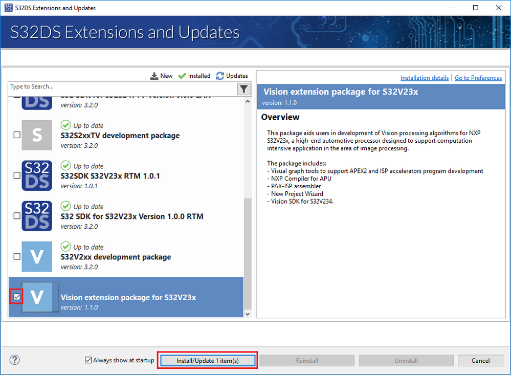

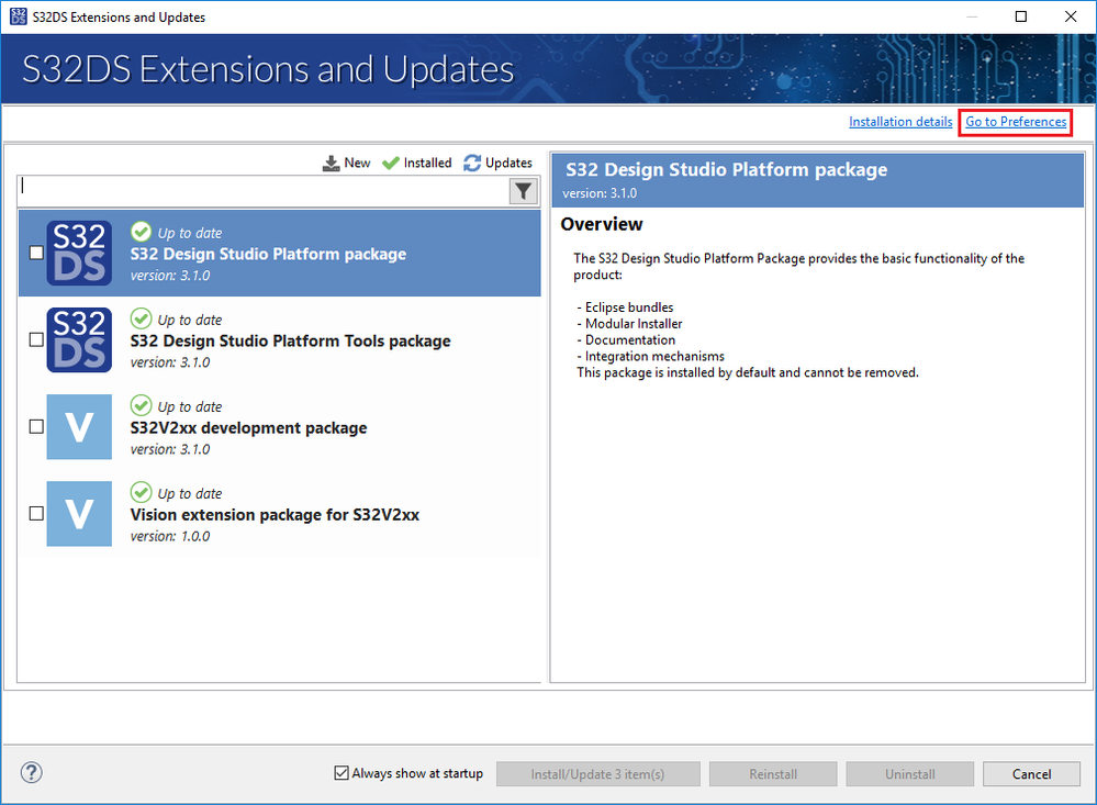

  •  online installation:
    • go to menu "Help" -> "S32DS Extensions and Updates" dialog
    • select from available items and click "Install/Update" button

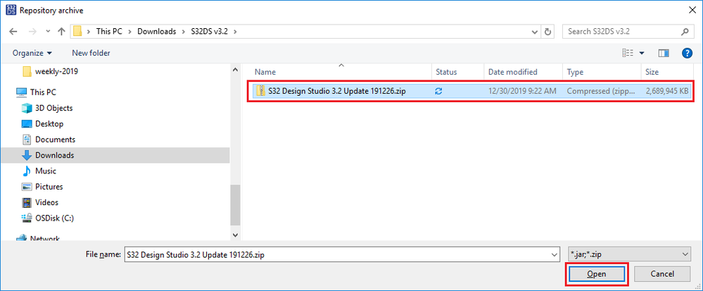

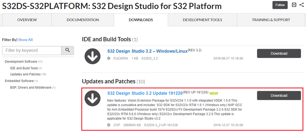

  • offline installation:
    • go to S32 Design Studio product page -> Downloads section or use direct link to download the update archive zip filepastedImage_1.png

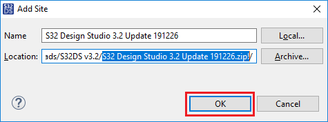

    • Start S32 Design Studio and go to "Help" -> "S32DS Extensions and Updates"pastedImage_12.png
    • Add a new "Add.." S32DS Software Site and browse to select the downloaded update archive .zip file you downloaded in the previous steppastedImage_6.png
    • Select from available items and click "Install/Update" button.pastedImage_8.png
This will start the update installation process.
