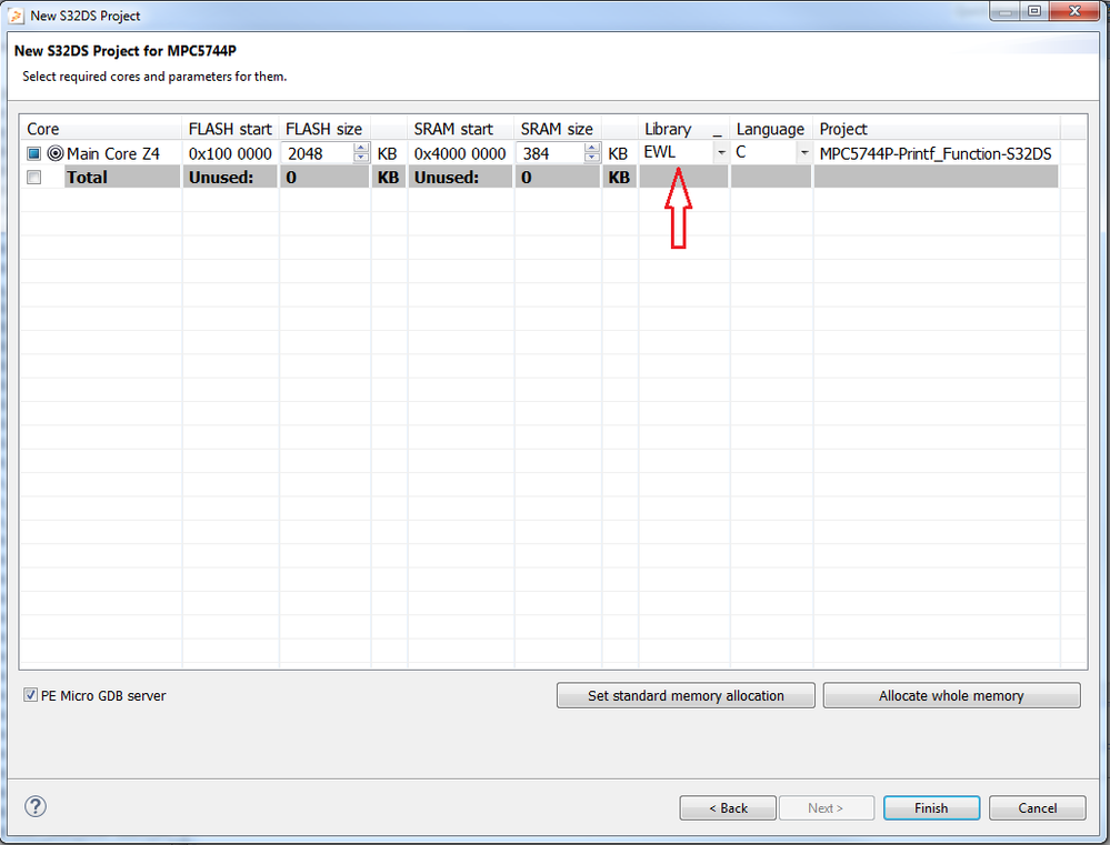

Create new project, choose EWL library and finish project wizard. Include stdio.h to the file, where you want to call printf function.

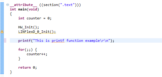

Now it is possible to use printf function. Important point is, that \n character triggers the data sending. Also, if you do not use this \n character, you will get compile error, but I will explain this further in this tutorial.

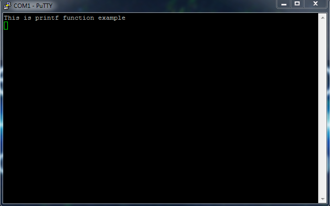

Run some terminal emulation, for example Putty and use the following settings:
Now open terminal and run the code in the microcontroller. This should be the result:

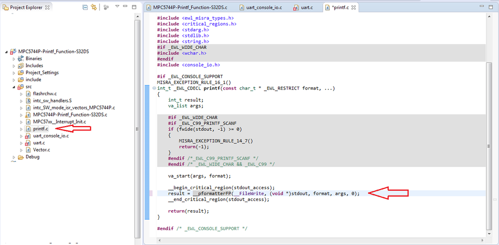

When you do not use any format characters in printf argument, function _EWL_CDECL puts(const char_t * s) from puts.c file is called on background. But when you use format characters in printf argument, function int_t _EWL_CDECL printf(const char_t * _EWL_RESTRICT format, ...) from printf.c file is called instead of puts.
Variable result saves value, which function __pformatter returns. But function __pformatter is not implemented. Instead of __pformatter, function __pformatterFP (placed in __printformat.c file) is implemented.

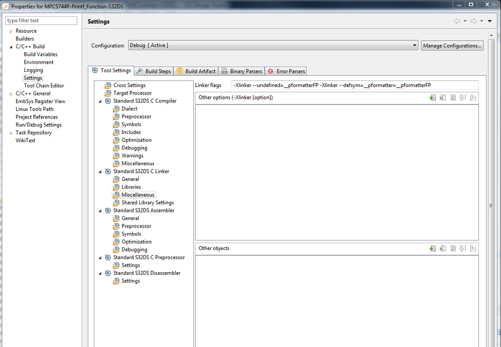

So there are two possible workarounds.
First workaround is place the following code to the Linker flags in project properties:
-Xlinker --undefined=__pformatterFP -Xlinker --defsym=__pformatter=__pformatterFP
The code says that there is undefined symbol __pformatterFP (part -Xlinker --undefined=__pformatterFP) and define symbol alias __pformatter=__pformatterFP (-Xlinker --defsym=__pformatter=__pformatterFP ). So from my point of view, symbol __pformatter is replaced by __pformatterFP. Now the correct function is called and the project could be successfully built.
Second workaround is add the printf.c file from S32DS installation folder S32DS/e200_ewl2/EWL_C/src/stdio to the project src folder and exchange __pformatter for __pformaterFP. Clean project and recompile.
