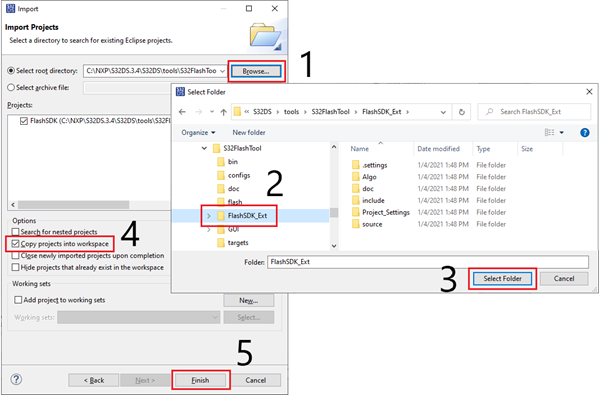

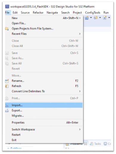

  2. Import the FlashSDK project, using copy to workspace option to preserve the original project.
    1. File -> Import
    2. Select 'Existing Projects from Workspace'
    3. Click 'Browse', locate and then select the 'FlashSDK_Ext' folder, check the box for 'Copy projects into the workspace'

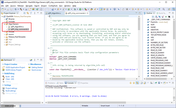

  3. Open source files. The files in the project which should be modified for a new flash device are: ...\FlashSDK\Algo\Generic\qSPI_Algorithm.c and qSPI_chip_commands.h
    Locate the files within the Project Explorer and double click them to open them in the editor.
  4. Edit source files. The header file 'qSPI_chip_commands.h' contains many #defines for the flash memory chip which should be adjusted to your new device. Please refer to the reference manual provided by the flash device manufacturer for details on the correct values. As you can see, it is currently setup for the MX25UM51245G device from Macronix.

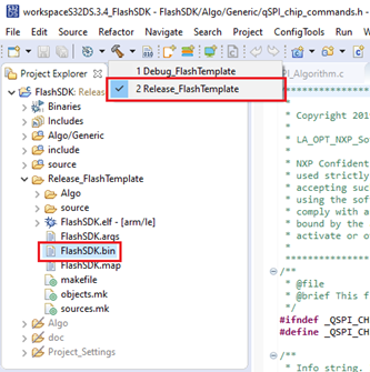

  5. Build the project. The project is setup for 2 build types for you, Debug and Release. The Release build type is more efficient and will run faster, and the Debug build type will allow you to run the debugger in attach mode to investigate issues with the changes you've made.
  6. Test new binary on the target and flash memory device. Follow the usual steps to use the S32 Flash Tool.
