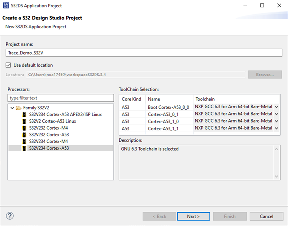

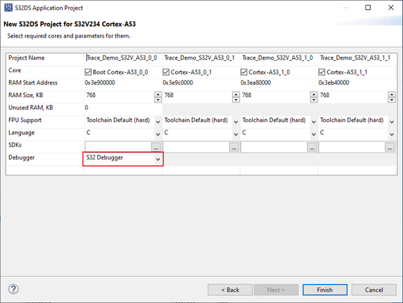

  1. Create a new application project, selecting the 'S32V234 Cortex-A53' processor and 'S32 Debugger' options.
  2. There should now be 4 new application projects in your workspace. One for each A53 core. The first core of the S32V234, A53_0_0, is also a possible boot core, so this project will have build configurations for RAM and FLASH. The other A53 cores (0_1, 1_0, 1_1) will not. Build all projects for Debug_RAM and check that they build clean before proceeding.

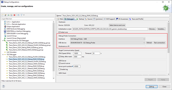

  3. Open 'Debug Configurations...' and select the 'Debug_RAM' configuration for the first core (A53_0_0_Debug_RAM_S32Debug). Select the 'Debugger' tab. Enter the Debug Probe Connection settings as appropriate for your hardware setup.

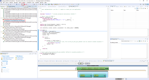

  4. Now select the Launch Group configuration for 'Debug_RAM'. It is important to use the launch group to start the debug for each core, not just because it makes it easier, but also because it is necessary to allow for some delay after the first A53 core is started before bringing the other A53 cores from reset to debug state. Press Debug

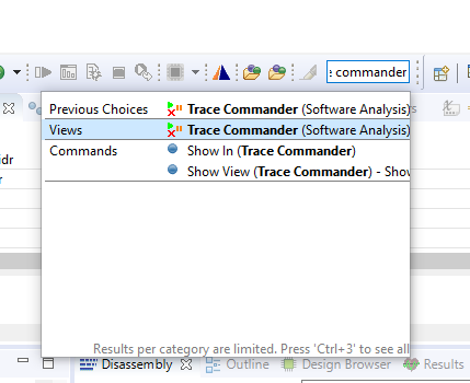

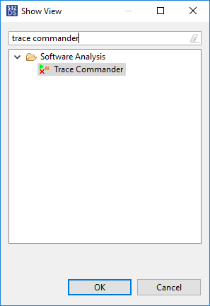

  5. Once the code is loaded to the target and the debugger has started each core and executed to the first line within main(), then it is ready to perform any of the standard debug functions including Trace. Trace does not start automatically, it must be turned on before it will start logging data. To do this, it is necessary to add the view 'Trace Commander'. It can be found by either Window -> Show View -> Other, then search for 'Trace Commander' or enter 'Trace Commander' in the Quick Access field of the toolbar and select Trace Commander from the list.

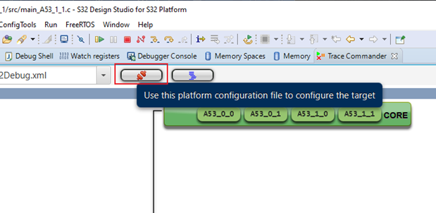

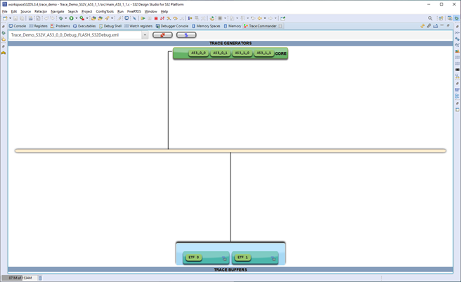

  6. The Trace Commander view will show in the panel with the Console, Problems, etc. Double-click on the tab to enlarge it.

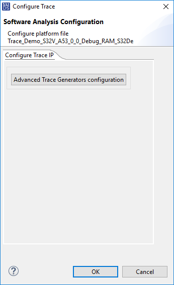

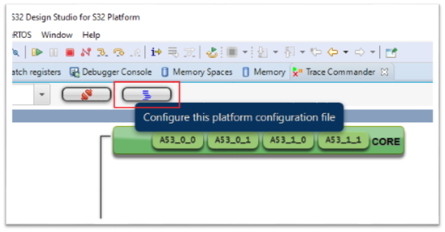

  7. Click on the configure button to change settings.
  8. Click on the Advanced Trace Generators configuration button

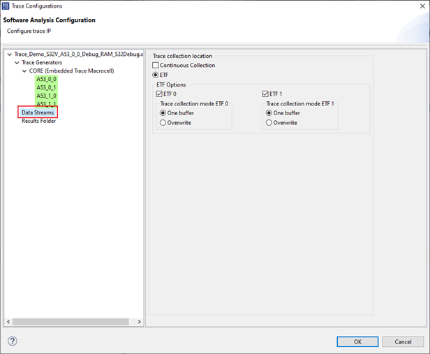

  9. For each core to be logged, set the associated ELF file. Select the core, click Add, then '...', and select the elf file for that core.
  10. Select Data Streams. Now it is possible to change how the data is captured. Since the buffers have finite memory, they can be set to collect data until full, or to overwrite. If set to One buffer, the data will be collected until the buffer is full, then data collection stops. It is useful to gather data when starting logging from a breakpoint to gather data during execution of a specific section of code. If set to Overwrite, the data collection continues and starts overwriting itself once the buffer is full. This is useful when trying to gather data prior to a breakpoint triggered by a condition.
  11. To turn on the Trace logging, click on the 'Close this trace stream' button.
  12. The Trace is now enabled. To collect trace data, the cores must be executing. First double-click the Trace Commander tab to return to the normal Debug Perspective view. Then, one by one, select the main() thread on each core and press Resume to start them all. If collecting from a breakpoint, start the code first with Trace disabled, wait for the breakpoint to be reached, then enable the Trace.

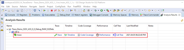

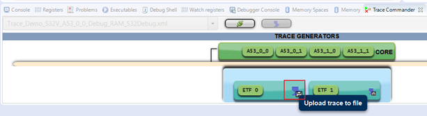

  14. Look to the Trace Commander tab to see that the data icon is no longer shaded and click on it to upload the trace data.

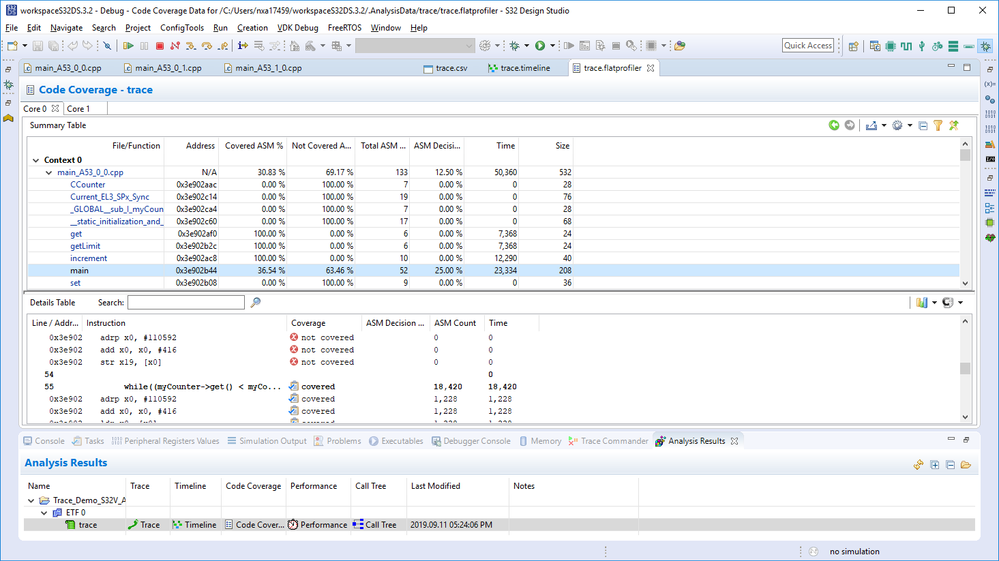

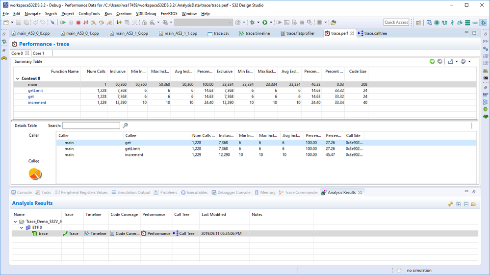

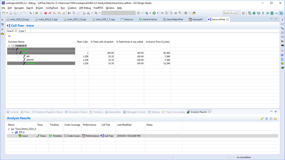

  15. A new tab, Analysis Results, has appeared. Double-click this tab to see it better. Click on the arrow next to ETF 0 to show the data collected in the trace buffer.

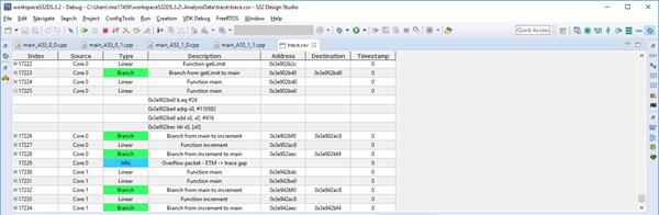

  16. Notice there are 5 separate views on the captured data: Trace (raw data), Timeline, Code Coverage, Performance, and Call Tree.
    1. Trace - this is the fully decoded trace data log

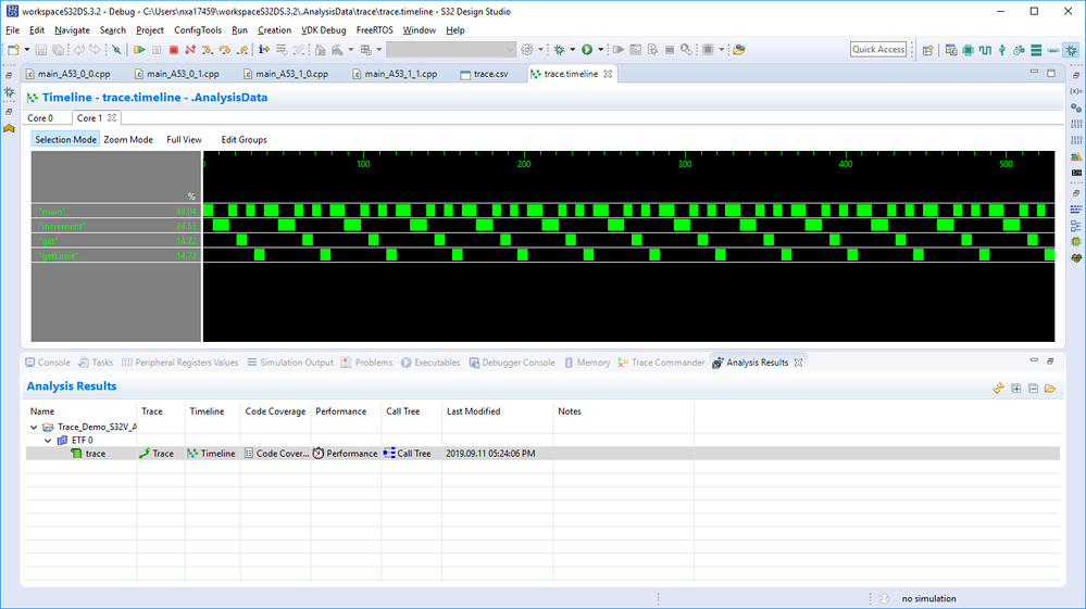

    2. Timeline - displays the functions that are executed in the application and the number of cycles each function takes, separate tabs for each core
    3. Code Coverage - displays the summarized data of a function in a tabular form, separate tabs for each core
    4. Performance - displays the function performance data in the upper summary table and the call pair data for the selected function and it's calling function
    5. Call Tree - shows the call tree for identification of the depth of stack utilization
