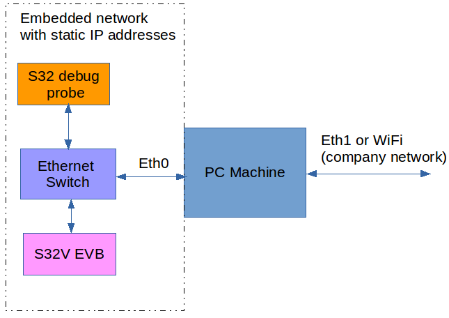

  • S32 debug probe connected to network (with DHCP server) and visible for your PC machine
  • separate network using static IP addresses (or direct connection between PC and S32 debug probe). The scenario is similar like on this picture:

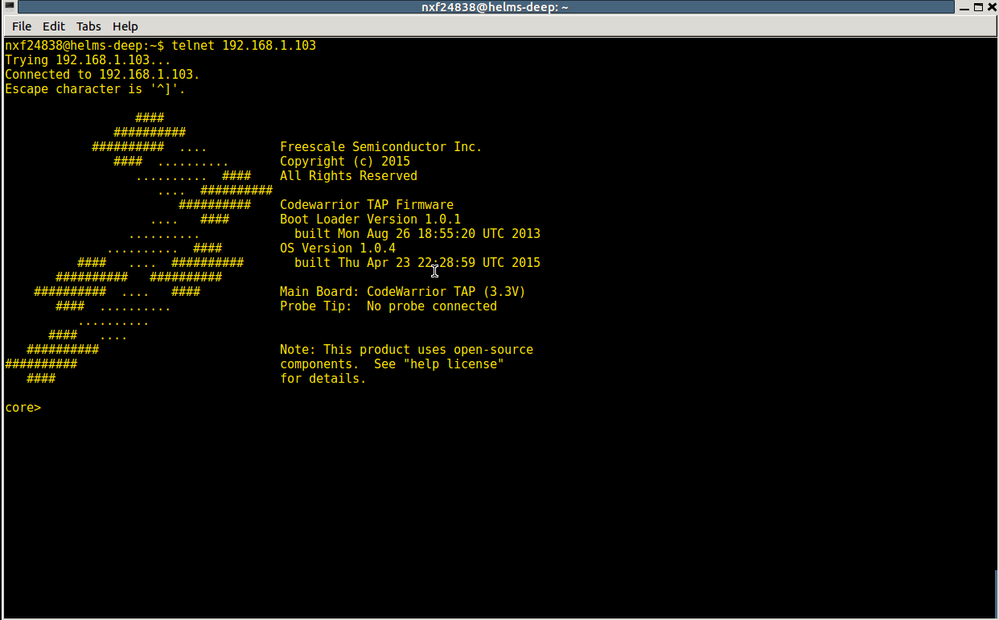

Connect power to S32 debug probe with already connected ethernet cable and wait until green LED (RX/TX) starts blink.Connect to S32 debug probe by telnet client. You can use default domain name FSLXXYYZZ where XXYYZZ are last 6 digits from S32 debug probe MAC address or assigned IP address:

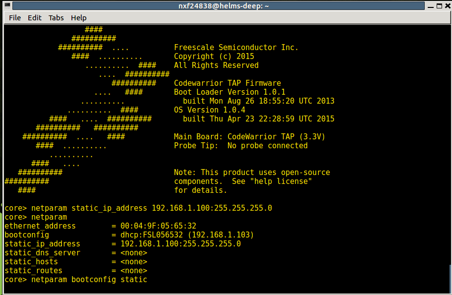

Static IP address can be set by netparam static_ip_address ADDRESS:NETMASK command. Make sure that you are choosing IP address from range of your Embedded network. My network uses standard 192.168.1.xxx here is mt setings:
netparam static_ip_address 192.168.1.100:255.255.255.0
You also need to set boot config from DHCP to Static:
netparam bootconfig static

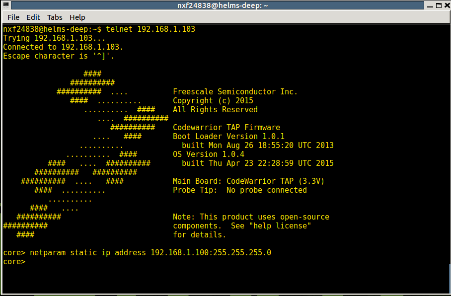

Turn OFF and ON again S32 debug probe and check the settings by telnet with static IP address - in my case 192.168.1.100:
We are done.
