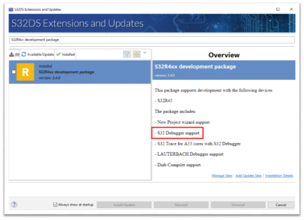

    1. Install S32 Design Studio for S32 Platform
    2. Install the Development Package for the device you are debugging. In this case, the S32R4xx development package. This package is important as it contains the S32 Debugger support component

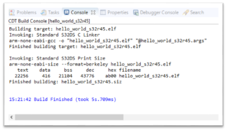

  3. Launch S32 Design Studio for S32 Platform

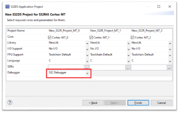

  4. Open existing project or create a new project and check that it successfully builds. If creating a new project, be sure the S32 Debugger is selected in the New Project Wizard.

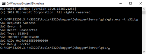

Check the state of the SoC
  1. Open a command window from the installation directory containing the GTA server:
    {S32DS Install Path}\S32DS\tools\S32Debugger\Debugger\Server\gta\
  2. Execute the following command:
    gta.exe -t s32dbg
    This will invoke a utility that launces a new GTA server instance and then communicates with the target via the S32 Debug Probe and will request a set of properties of the SoC. These properties are available to be read regardless of security state. The GTA server will close once the information is returned.
    As is shown above, the Debug state is ‘Locked’. This means it is secured and the secure debug steps outlined within this document must be used.
  3. There is no way to determine the security enabled on the SoC, so this should be known by the user in order to select the correct authentication scheme. Proceed from here using the method (Password or Challenge & Response) which applies for your SoC security configuration.

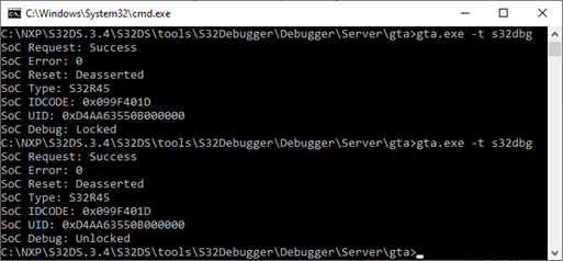

  5. Now the debug session initialization will complete and debug activities may be executed as with any SoC which is not secured. After terminating the debug session, the GTA utility can be used again to see the new state of the SoC.
    This utility cannot be executed while the debug session is running. It launches a new instance of the GTA server, which would be blocked by the already running debug session.

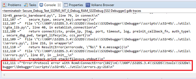

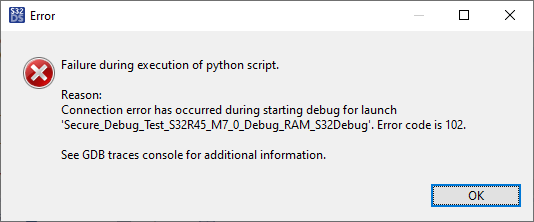

Debug session started when SoC is still secured
There is an error message reported in the S32 Debugger Console to indicate the SoC is still secure. To see this message the GDB Server log must be enabled in Debug Configurations -> Debugger tab, GDB Server section:
When this error is incurred, first indication is popup error message for Error code 102:

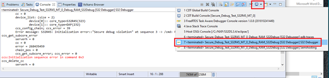

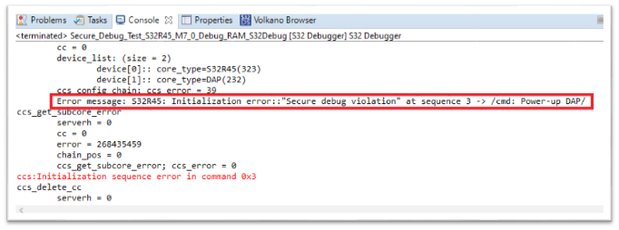

Next, the following text will be displayed in the S32 Debugger console window:
If needed, select this view from the menu:

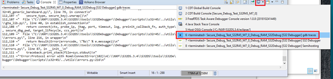

In addition, if GDB Traces log is enabled, the following error message can be found in the gdb traces console view:
Enable the GDB Traces log in Window->Preferences, then search on GDB:
To select the view from console:

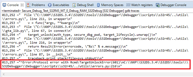

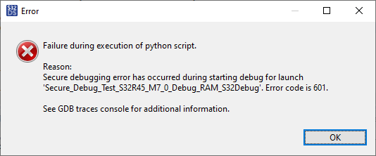

Incorrect Challenge/Response Or Password
If the SoC is setup for Challenge & Response security scheme, but Password security scheme is selected in Debug Configuration, or Challenge & Response is correctly selected but the wrong ADKP value is provided, below are the expected error messages. The result is same if the SoC is setup for Password and either Challenge & Response or wrong password is used.
First error message is Error code 601:
Next, the gdb traces console displays the following error:
There is no error displayed in the S32 Debugger console.
