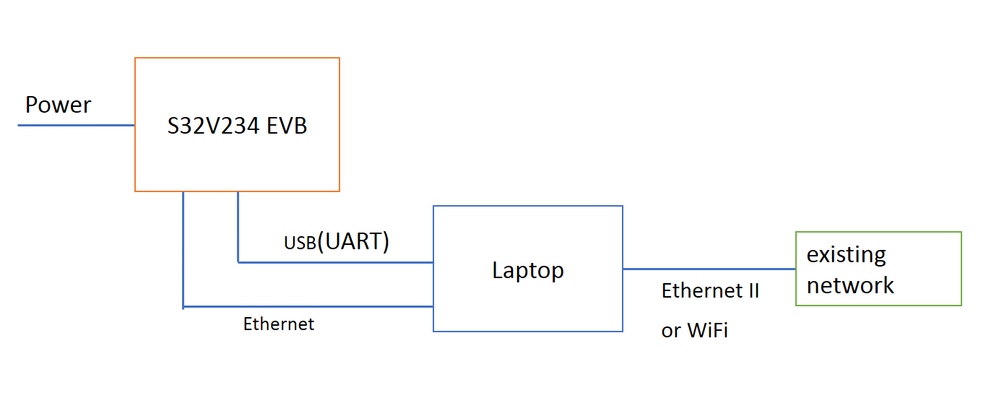

Use case:
This settings is useful when you don't have DHCP server available or for some reason you can't connect EVB into existing network - like on this scenario:

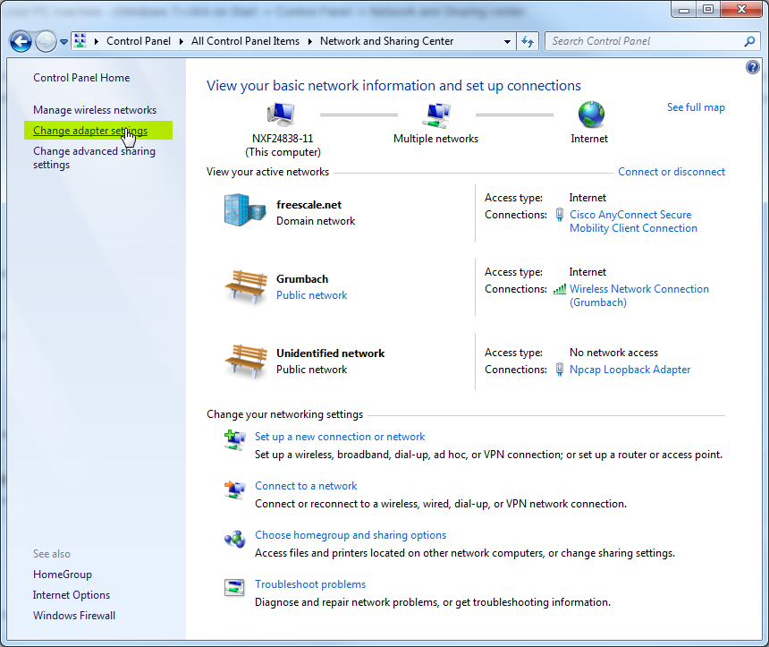

Setup static IP address on your PC machine - (Windows 7) click on Start -> Control Panel -> Network and Sharing center. On the left side click on "Change adapter settings"

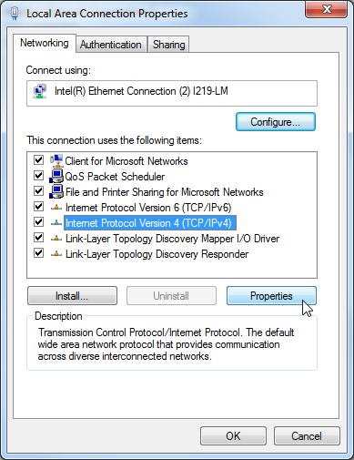

Select network interface connected to EVB ( Local area connection ) and choose "Internet protocol Version 4 (TCP/IPv4)" option and click on Properties button.

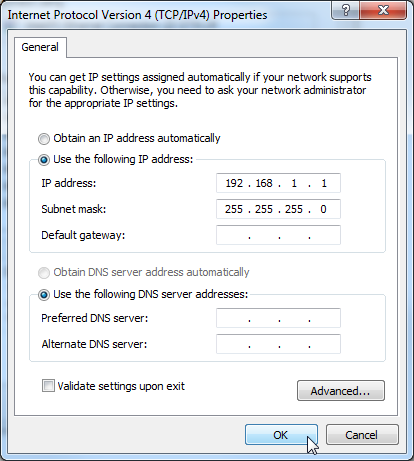

Select "Use the Following IP address" radio button and enter IP address for PC side of network connection and click on OK button.

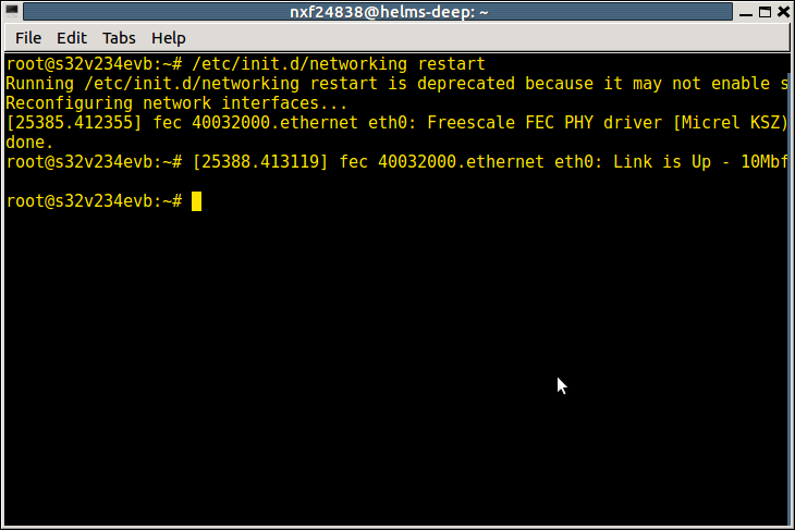

Save new settings by :w command (press ESC key to switch vi editor to command mode) and exit from vi by :q command. Restart network by command
/etc/init.d/networking restart

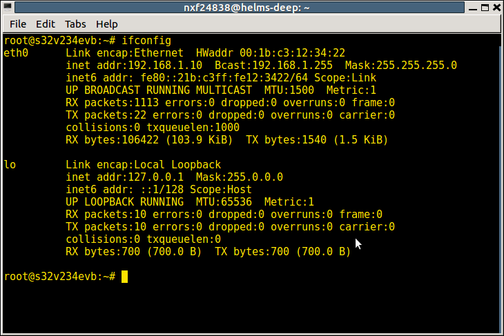

Check the IP address by command ifconfig and try ping to your PC machine.

  • ifconfig
root@s32v234evb:~# ifconfig
eth0 Link encap:Ethernet HWaddr 00:1b:c3:12:34:22
inet addr:192.168.1.10 Bcast:192.168.1.255 Mask:255.255.255.0
inet6 addr: fe80::21b:c3ff:fe12:3422/64 Scope:Link
UP BROADCAST RUNNING MULTICAST MTU:1500 Metric:1
RX packets:0 errors:0 dropped:0 overruns:0 frame:0
TX packets:8 errors:0 dropped:0 overruns:0 carrier:0
collisions:0 txqueuelen:1000
RX bytes:0 (0.0 B) TX bytes:648 (648.0 B)
