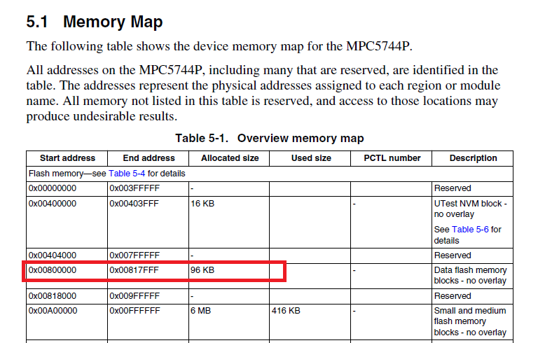

  •  Check the memory map of the target device in the reference manual to figure out where DFLASH is mapped into. Add DFLASH memory segment/section into the linker file  (MPC57xx_flash.ld).

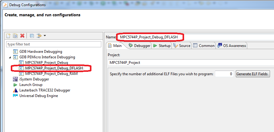

If you need to control DFLASH programming separately from code flash you would need a separate debug configuration for DFLASH.
  • You can use "Duplicate" feature on an existing Debug configuration. This creates a new configuration with pre-populated fields so you don't have to enter them all manually.pastedImage_6.png
  • Change the debug configuration name and press "Apply"

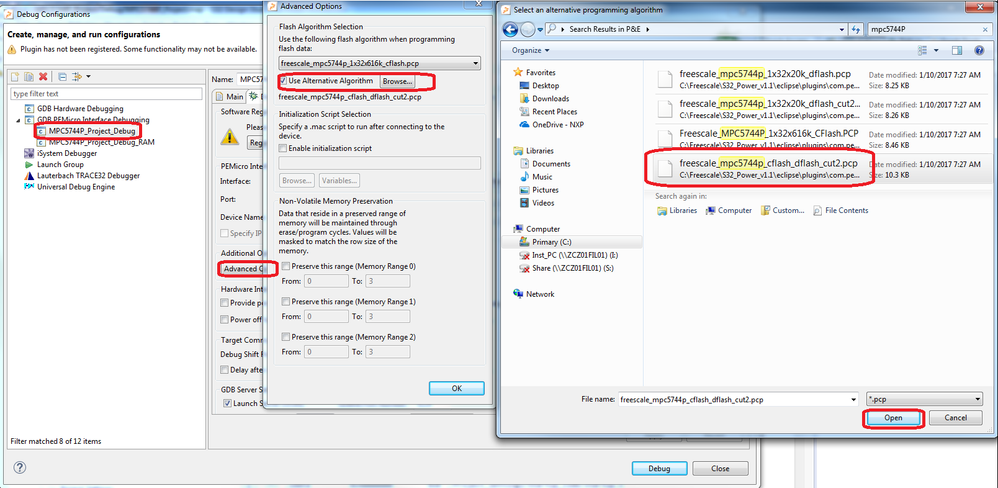

  • Switch to the Debugger tab -> Advanced Options and tick "Use Alternative Algorithm" option. Open Browse dialog and go to the folder below where all flash programming algorithms are located (*.pcp) and  select the appropriate DFLASH programming algorithm e.g. for this example: freescale_mpc5744p_1x32x20k_dflash_cut2.pcp
         "<S32_Power_v1.x>\eclipse\plugins\com.pemicro.debug.gdbjtag.ppc_1.5.6.201703011834\win32\gdi\P&E"
Folder name "com.pemicro.debug.gdbjtag.ppc_1.5.6.201703011834" may differ depending on the latest version of Pemicro GDB plugin version installed on your machine.
It's recommended to enter the latest version folder if there are multiple plugin versions available.
If you want to program DFLASH and code flash at once you can just adjust the existing debug configuration. In this case you should select combined cflash+dflash flash algorithm such as e.g. freescale_mpc5744p_cflash_dflash_cut2.pcp
