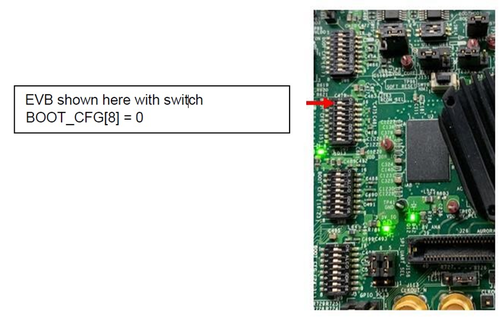

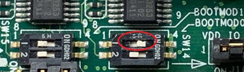

  1. Connect the S32 Debug Probe to the EVB and the host PC containing S32 Design Studio installation.
  2. Set BOOTMOD pins to boot from RCON
  3. Set BOOT_CFG[8]=1 on the EVB, for serial RCON mode

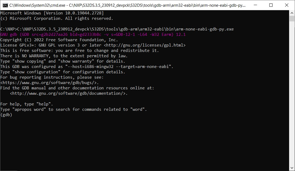

  1. Set Python path so correct version is used (if not already set in env vars)
set
PYTHONPATH=C:\NXP\S32DS.3.5\S32DS\build_tools\msys32\mingw32\lib\python2.7;C:\N XP\S32DS.3.5\S32DS\build_tools\msys32\mingw32\lib\python2.7\site-packages

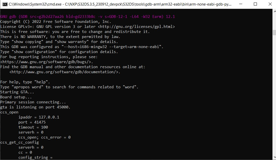

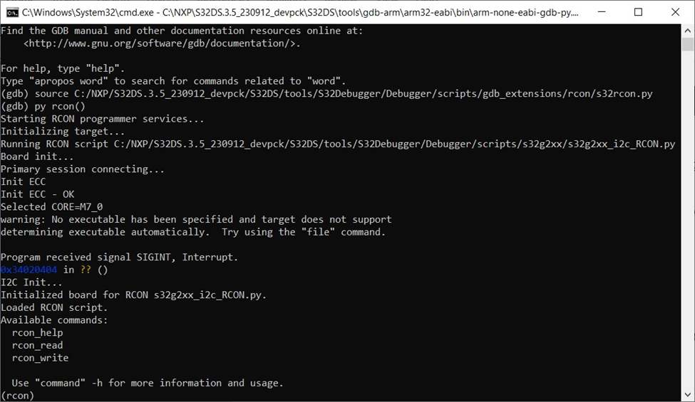

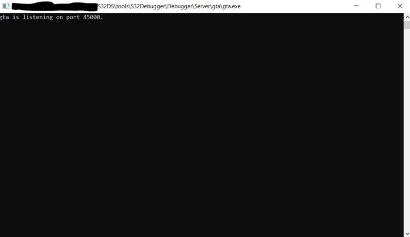

  1. Start GDB Server. (…\S32Debugger\Debugger\Server\gta\gta.exe)
  2. Start Command Prompt and enter the command to start GDB with python:
Example:
C:\NXP\S32DS.3.5_230912_devpck\S32DS\tools\gdb-arm\arm32eabi\bin\arm-none-eabi-gdb-py.exe
Linux OS: arm-none-eabi-gdb-py

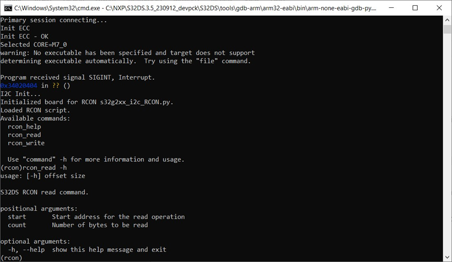

  1. In s32rcon.py
( C:\NXP\S32DS.3.5_230912_devpck\S32DS\tools\S32Debugger\Deb ugger\scripts\gdb_extensions\rcon\s32rcon.py
  1. Edit connection parameters (Probe IP, GDB server port, JTAG speed, etc.)
  2. Edit _RCON_SCRIPT parameter with absolute path to the desired I2C RCON script for the desired board:
Example:
_RCON_SCRIPT = "
C:/NXP/S32DS.3.5_230912_devpck/S32DS/tools/S32Debugger/Deb ugger/scripts/s32g2xx/ s32g274a_i2c_RCON.py"
     c. Source s32rcon.py in GDB.
Example:
source
C:/NXP/S32DS.3.5_230912_devpck/S32DS/tools/S32Debugger/Deb ugger/scripts/gdb_extensions/rcon/s32rcon.py

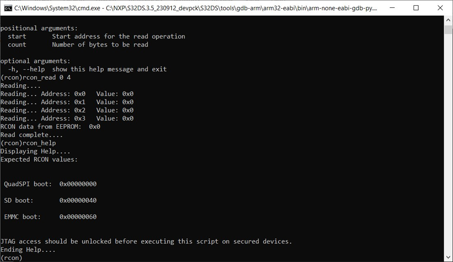

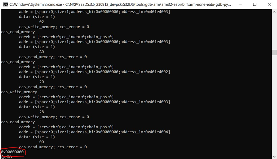

    d. Run command py rcon() in GDB.
OBS:  Steps a, b can be done after c directly from GDB, using GDB py commands:
Examples:
py _GDB_SERVER_PORT=45000  py
_RCON_SCRIPT="C:/NXP/S32DS.3.5_230912_devpck/S32DS/tools/S32Debugger/Debu gger/scripts/s32g2xx/ s32g274a_i2c_RCON.py"
  1. User can now use the available commands, like rcon_help, rcon_read, rcon_write to interact with the EEPROM.
  1. User can write [command] -h for more information and mandatory parameters of the command.
