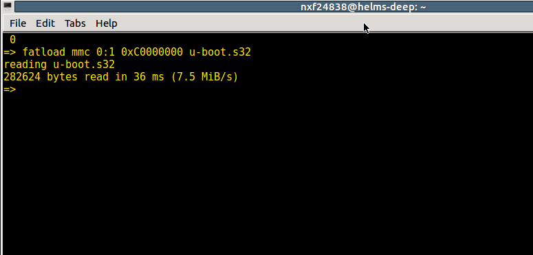

First - we need to write u-boot.s32 file to eMMC. Unfortunately - there can be active only one storage - SD Card or eMMC. We need to copy u-boot.s32 from SD Card to RAM (use RAM address 0xC0000000), deactivate SD Card and connect eMMC. In u-boot console use
fatload mmc 0:1 0xC0000000 u-boot.s32
command. Write down the size of loaded file - you will need it later for counting number of sectors. In my case - the file size is 282624 (0x45000).

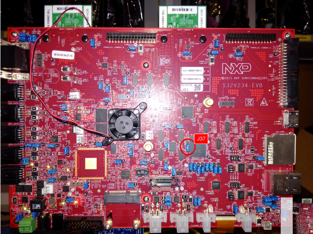

Once is u-boot.s32 in the RAM, we can disconnect SD card and connect eMMC by switching J37 jumper from 1-2 to 2-3 (there may be different name for other board vesions - but the location is same).

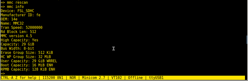

After switching from SD to eMMC you need to rescan mmc device by command:
mmc rescan
You can verify if eMMC is  mapped correctly by
mmcinfo

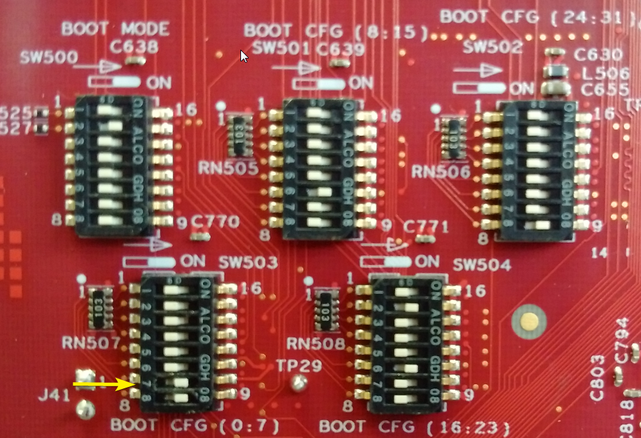

Now we can switch boot source from SD to eMMC by switches located on rear side of EVB. The switch name may vary across board version but location is again the same. Turn OFF EVB and remove SD card. For booting from eMMC switch SW503 - BOOT CFG (0:7) 7'th switch from OFF to ON. Switches position for eMMC boot:

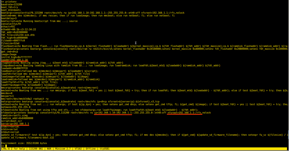

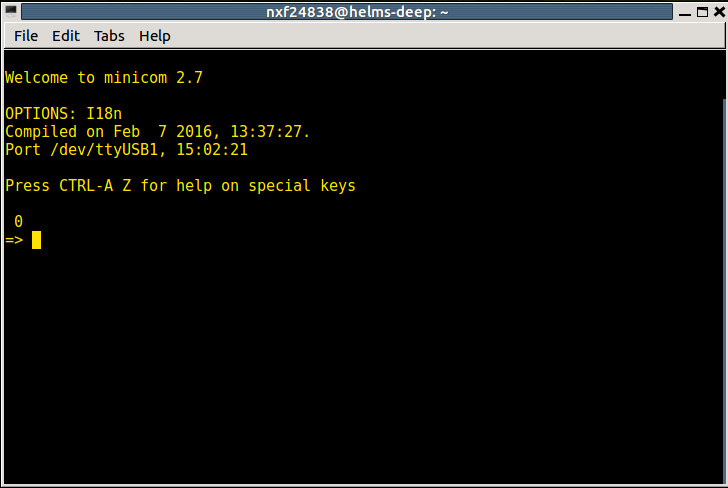

Turn ON EVB and stop again boot in u-boot console. Now we need to configure u-boot for booting from NFS. You can check u-boot variables by
printenv
command.
Make sure that nfsbootargs has correct EVB ip address, NFS server IP address and path to root file system. In my case - EVB IP is 192.168.1.10, NFS server is 192.168.1.1 and root file system on host PC machine is located in /rfs directory. You can also test network connectivity to PC Host machie by ping command.
You can change any of system variables by setenv command. For example - IP address can be changed by:
setenv ipaddr -f ipaddr 192.168.1.10
Here is printenv output on my EVB:

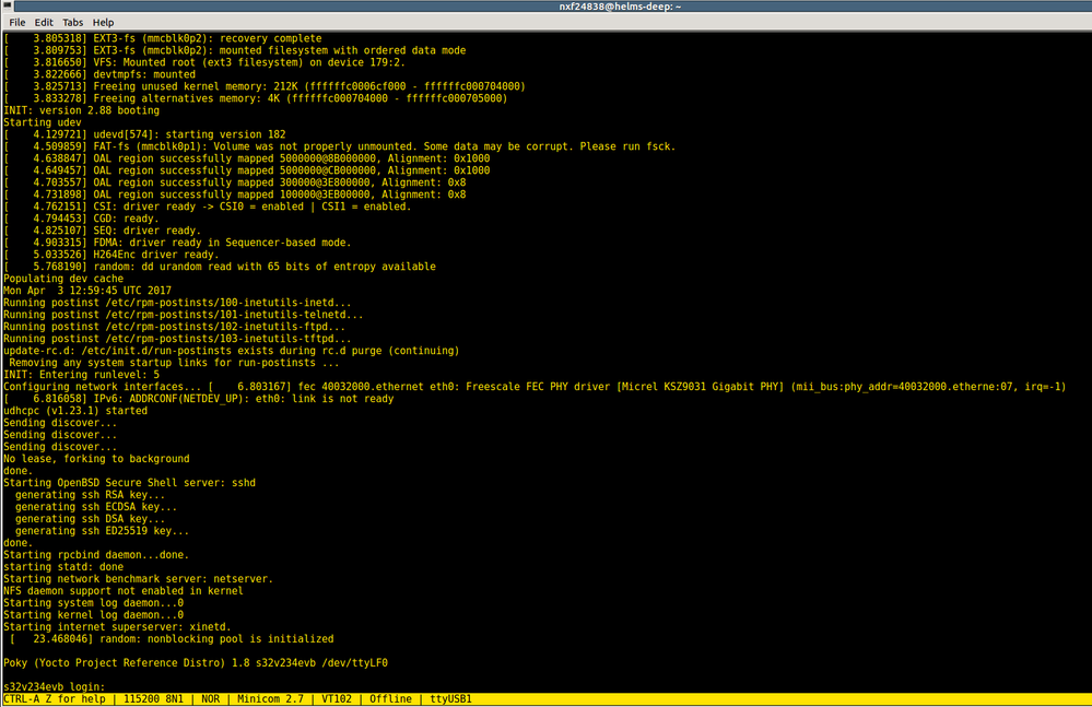

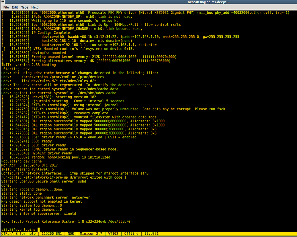

We are done with configuration - let's boot from NFS by:
run nfsboot
It takes a while. At the end you can see login prompt:

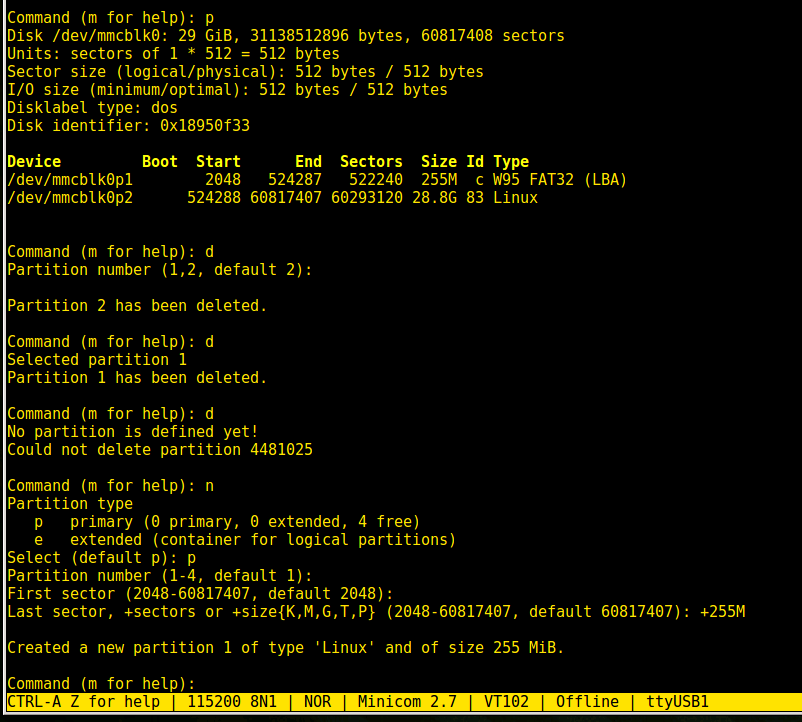

Login as root user. Now we need create boot and root file system partition on eMMC by fdisk.
Boot partition
fdisk /dev/mmcblk0
check if there are already some partitions by
p
command in fdisk. If there are partitions - delete all of them by
d
command. If done - let's create new boot partion with 255 MB size:
n
p
1
[ENTER] key for default selection
+255M

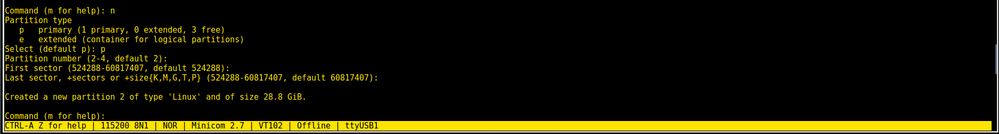

Root FS partition
in fdisk continue with:
n
p

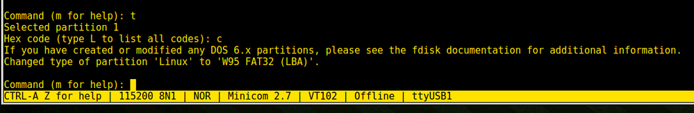

Change boot partition type from Linux to FAT32.
t
1
c

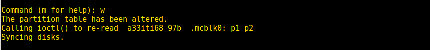

Write all changes by
w

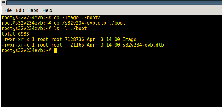

Copy Image and s32v234-evb.dtb files from root to already mounted mmcblk0p1 partition:
cp /Image ./boot
cp /s32v234-evb.dtb /boot

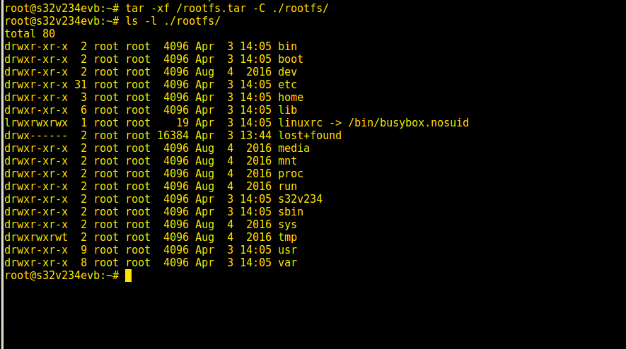

And now - the final step - untar root file system to mmcblk0p2:
tar -xf /rootfs.tar -C ./rootfs
We are done. Disconnect Ethernet cable, reboot and wait for login prompt:
