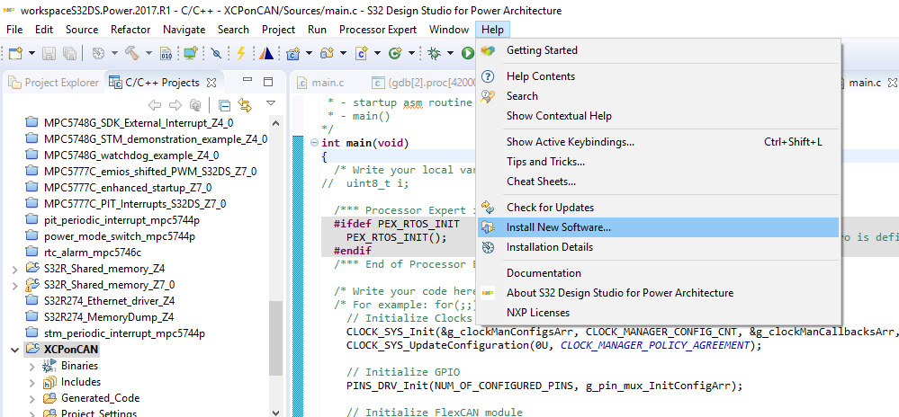

1) In S32DS, click Help->Install New Software

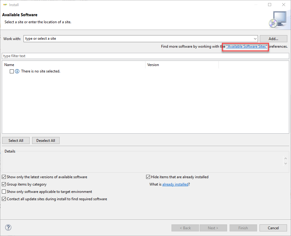

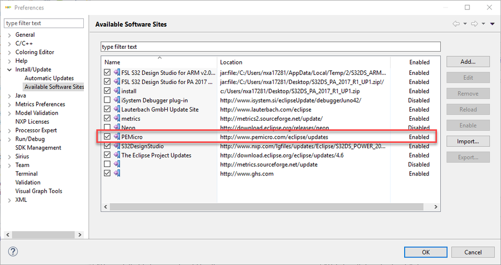

2) Click Available Software Sites.
3) Select required site, if available.

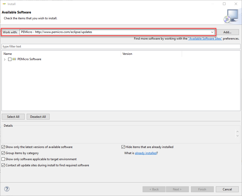

4) Select required site in Work with line:

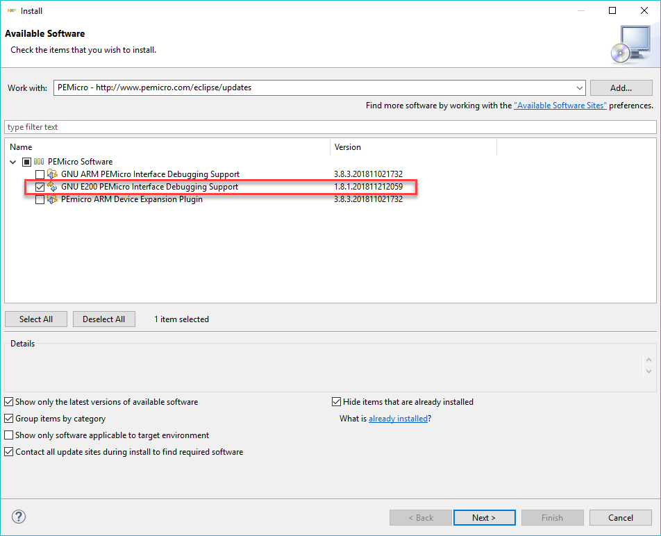

5) Available updates will appear in the window below. Check GNU E200 PEMicro Interface Debugging Support

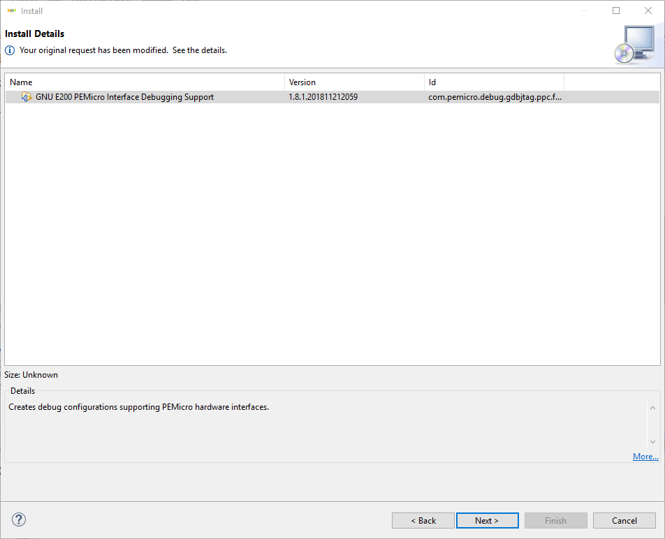

6) Click Next and new window will appear. Select required software and click Next.
7) Accept the license terms and click Finish. New software will be downloaded and installed.
