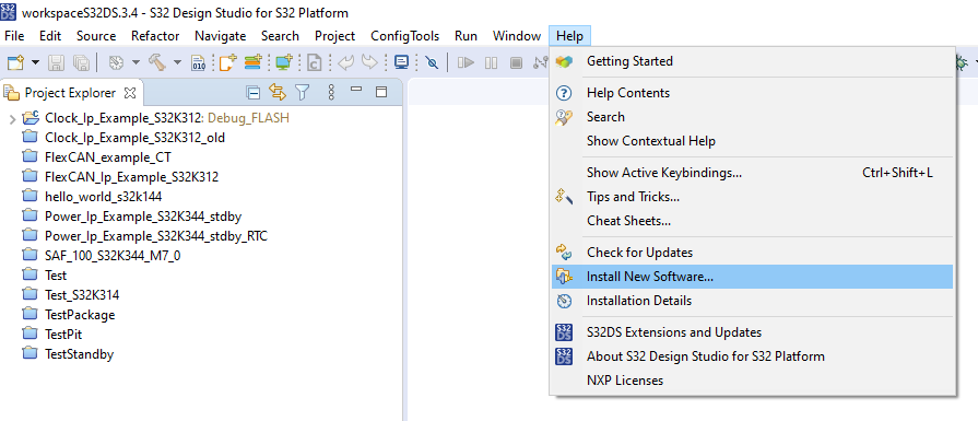

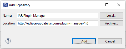

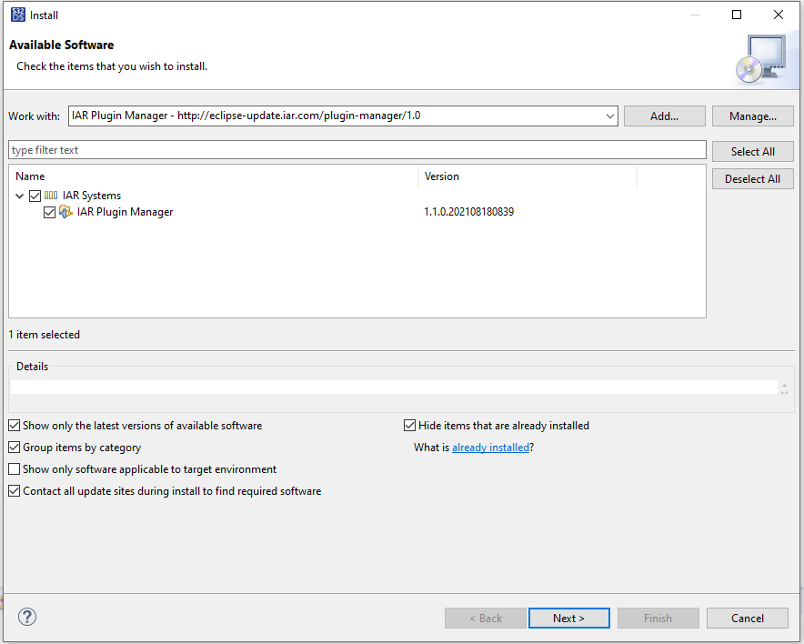

1. Install IAR Plugin manager
  • Go to menu "Help" -> "Install New Software"
  • Tick "I Accept the terms of the license agreement" and click "Finish" to accept unsigned content software
  • Finally you proceed to the installation. When the plugin is installed you will be asked to restart S32DS

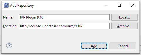

  • Again, go to menu "Help" -> "Install New Software" and  click on "Add..." button to add a new IAR repository located here: http://eclipse-update.iar.com/arm/9.10/

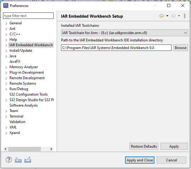

  • Anytime you create a new workspace you will be asked to enter path to IAR Embedded Workbench IDE. Go to menu "Window" -> "Preferences", click on "IAR Embedded Workbench" menu, select “IAR Toolchain for Arm – (9.x)” in the “Installed IAR Toolchains”, and then input the IAR Embedded Workbench IDE installation path.

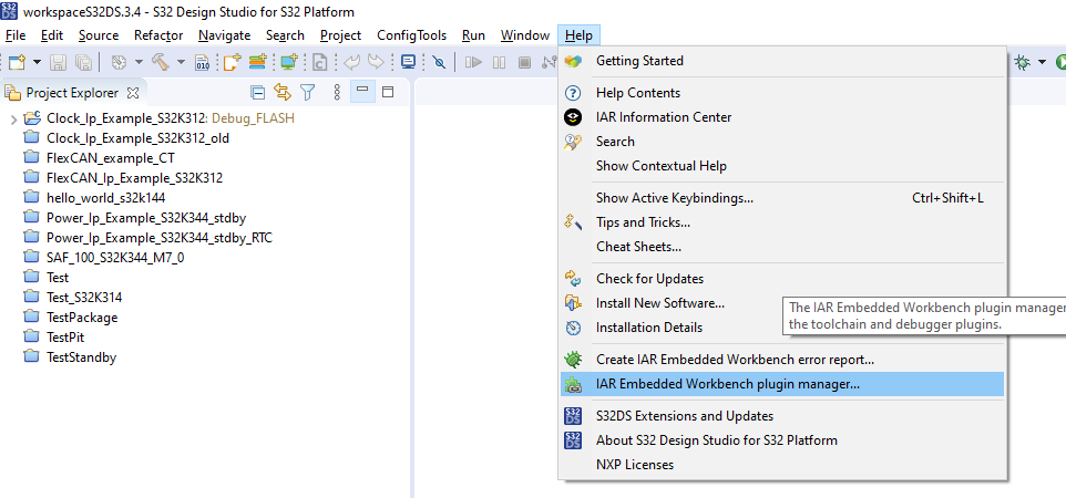

2. Configure IAR plugins in IAR Embedded Workbench plugin manager

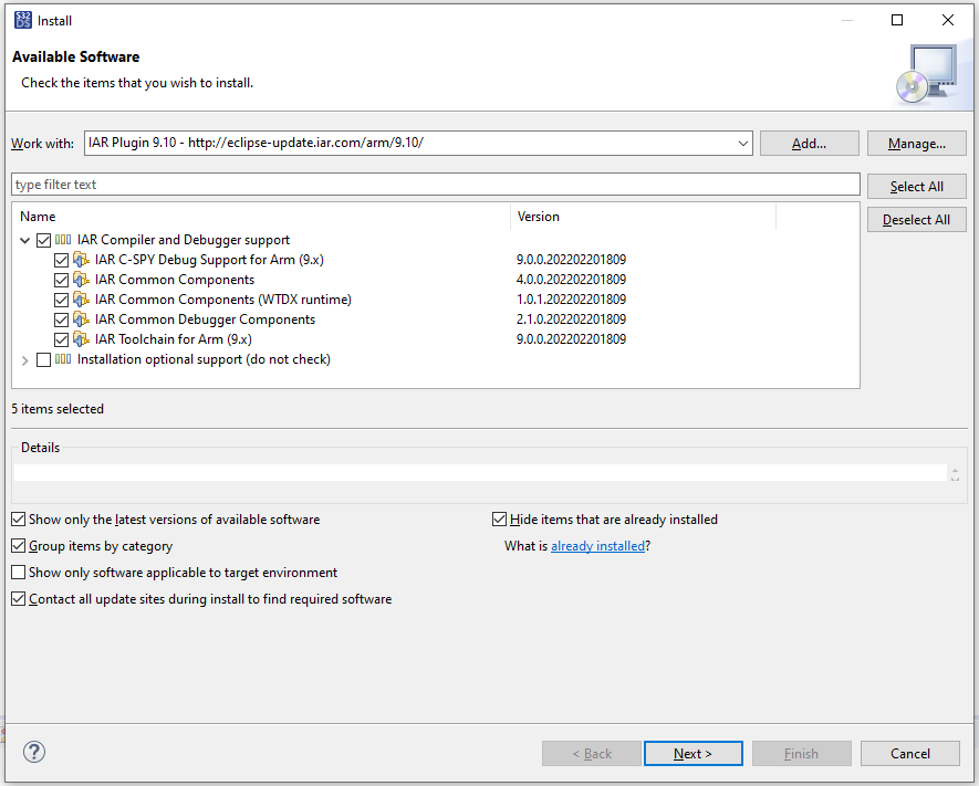

  • Start the IAR plugin manager (Menu "Help" -> "IAR Embedded Workbench plugin manager")
  • Select the ARM version (9.10-) and click "Install" button.
  •  Select all the IAR components displayed and proceed to installation by clicking "Next" button.

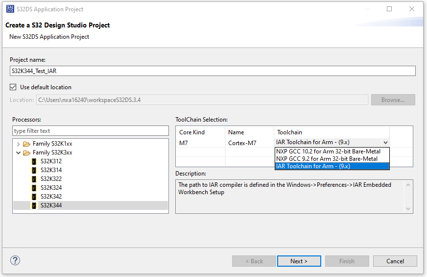

  • You can now create a new project in S32DS and select IAR toolchain for ARM instead of default GCC compiler.

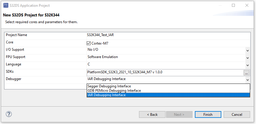

  • There should appear a new item it the Debugger selection - "IAR plugin Debugger". Please choose this option if you intend to debug using IAR supported probes (e.g. I-jet)

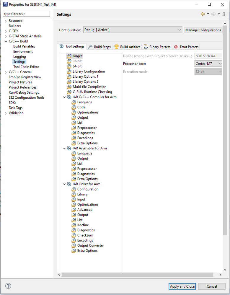

  • IAR specific panels and settings are now displayed in the project properties for a new S32DS project with the IAR options enabled (see below).

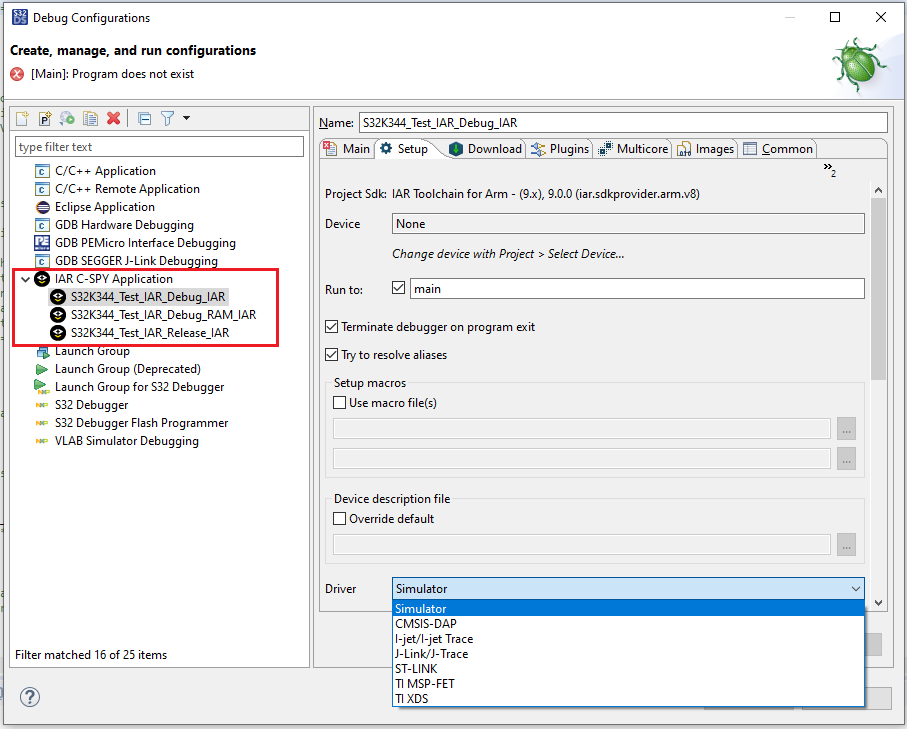

  • There is a new category "IAR C-SPY Application" in the debug configurations panel that contains all the debug configurations for projects with IAR debug plugin option selected.
