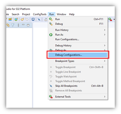

  1. With the existing project selected in Project Explorer, open the Debug Configurations Menu: Run -> Debug Configurations

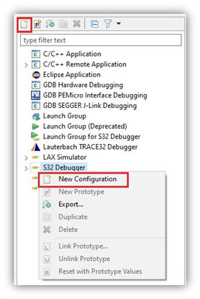

  3. To create the new configuration, either click on the ‘New launch configuration’ button from the toolbar at the top and to the left, or right-click on the ‘S32 Debugger’ and select ‘New Configuration’ from the menu.

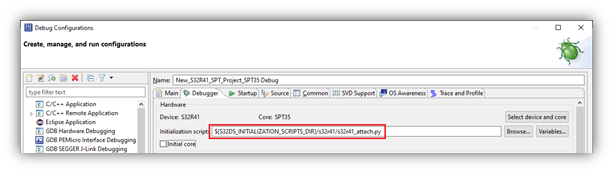

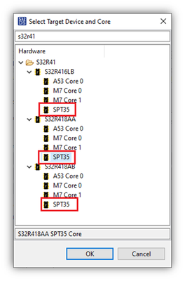

  5. There is an error showing that the Device core ID is not specified on the Debugger tab. Switch to the Debugger tab and click on the button ‘Select device and core’.
  6. From the Select Target Device and Core window, expand the listing until all cores are listed. Notice that all supported cores on the S32R41 are listed. Select the SPT35 core and click OK.
  7. Now that the device and core are selected, the attach script is selected automatically. The attach script will allow to start debugging on a core that is already initialized. This is correct for the SPT core as it is always launched in multicore scenario. Refer to the document 'README.txt' located in the same folder as these script files for details on all of the provided scripts.

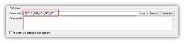

  9. Check that the GDB Client section has the correct path to the SPT GDB executable. It should point to the variable ‘S32DS_R41_GDB_SPT_PATH’.

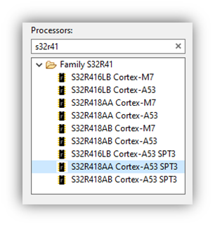

For convenience, the S32DS Application Project wizard was used to create a new project for demonstrating multi-core A53/SPT debugging. The SPT core does not support standalone debugging. For instructions on loading this example project to your workspace, see ‘HOWTO: S32 Design Studio - Create New Application Project’, selecting instead the Processor option Family S32R41 -> S32R41xxx Cortex-A53 SPT3 from the wizard menu.

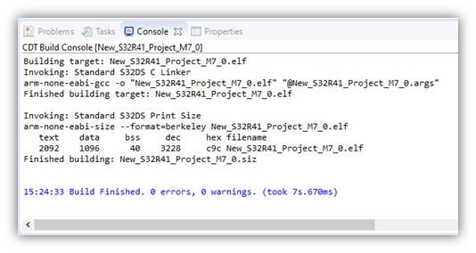

  1. Before beginning the debug sessions, be sure each project is built clean.

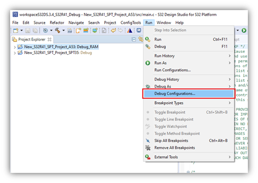

  2. Start A53 debug. From the menu at the top, select Run -> Debug Configurations…

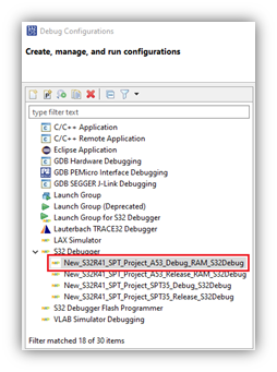

  3. In the Debug Configurations menu, from the configuration list, look for the ‘S32 Debugger’ group and select the A53 Debug_RAM configuration for the project to be debugged. In the case of our example, the ‘New_S32R41_SPT_Project_A53_Debug_RAM_S32Debug’ configuration.

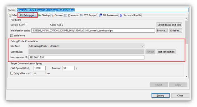

  4. On the Debugger tab, check that the Debug Probe Connection settings match with the current hardware connection configuration for the S32 Debug Probe.

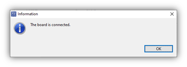

  5. Use the ‘Test connection’ button to confirm.

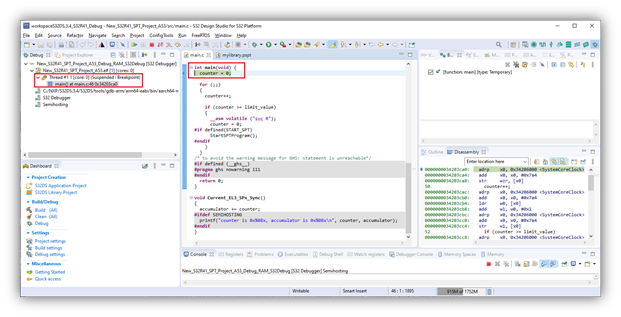

  7. The debugger will launch and execute until the first executable line in main(). See Debugger tab in Debug Configurations menu to adjust this setting.

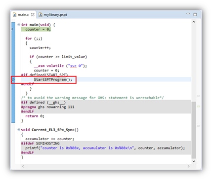

  8. Once the A53 debug session is running, advance the program counter to a line after the desired SPT kernel is loaded to memory but before the SPT kernel is launched. In the example here, this would be in ‘main.c’, line 57, where ‘StartSptProgram()’ function is called. This can be done by setting a breakpoint on the line and clicking Resume.
  9.  After the breakpoint is reached, the SPT debug session can be started.

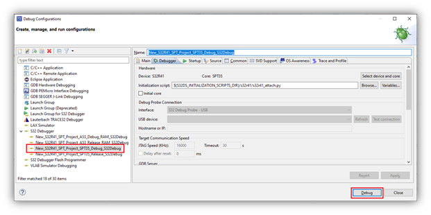

  10. Return to the Debug Configurations menu, select the SPT debug configuration. In the case of this example, ‘New_S32R41_SPT_Project_SPT35_Debug_S32Debug’, and click Debug.

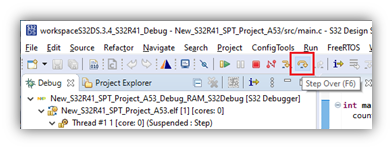

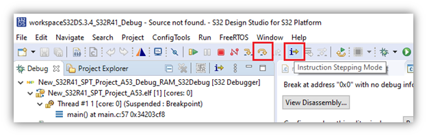

  11. Wait for the SPT debug session to launch and stop in the disassembly. Use the Step Over command one time in the A53 debug thread to complete the SPT launch.

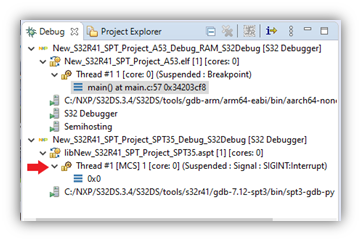

  12. Select the SPT debug thread to change the context of the Disassembly, Registers and etc.views.
    Notice the SPT code is not loaded yet.

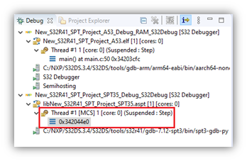

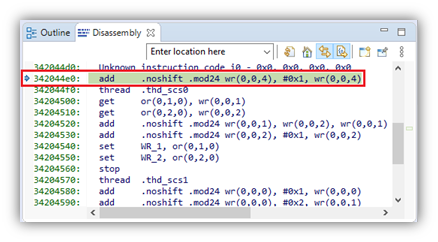

  13. Enable Instruction Stepping Mode and step one time. Notice the SPT code is now loaded.
  14. Now you can step through the assembly code, access registers, etc.
