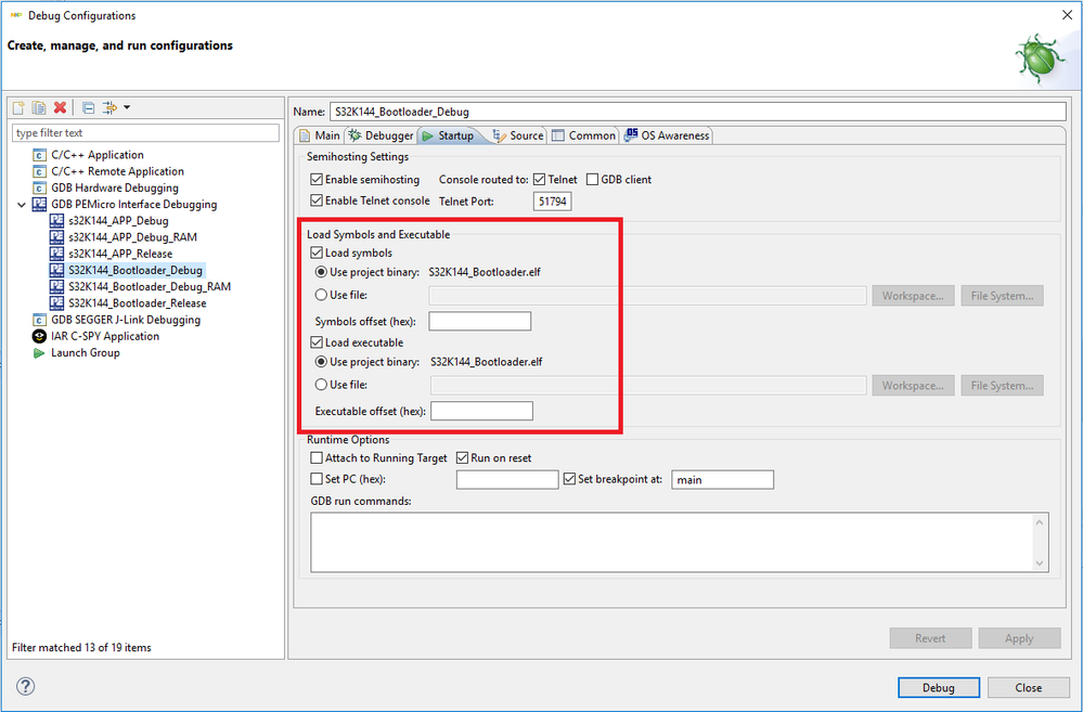

Each debug configuration in S32 Design Studio supports loading or ignoring debug information.
"Load symbols" loads just the debug information whereas "Load executable" basically loads program/code/data sections into MCU memory without debug information. Both options are enabled by default.

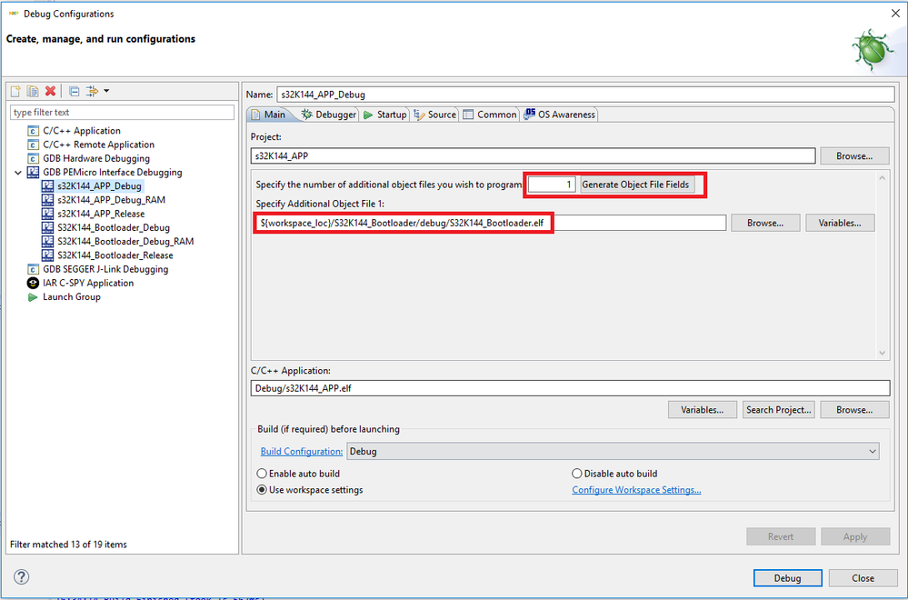

Before starting the debugger it's necessary to load both executable files into your MCU memory. This could be easily achieved in S32DS (GDB) debug configuration where you specify to add the additional object files.
In this specific case we need just 1 additional file - bootloader elf. The bootloader project in this example is actually another project in the same workspace (workspace relative path to elf file entered).

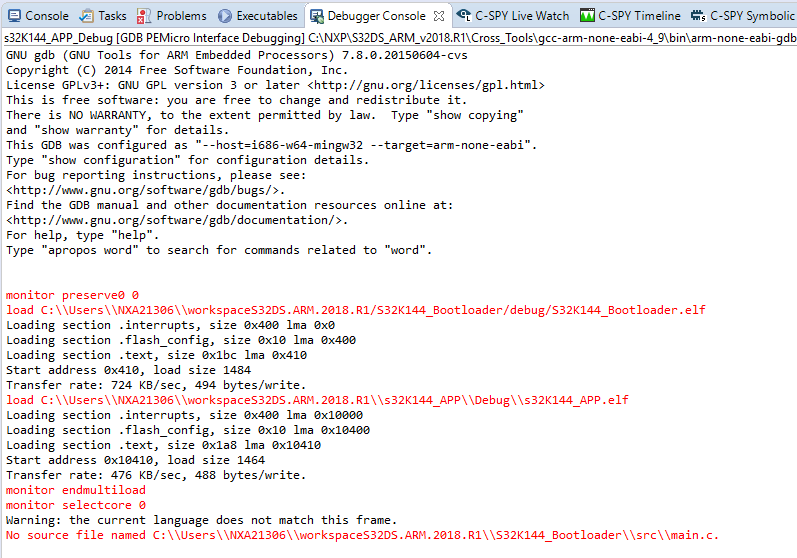

After starting debugger the Debugger Console view now shows the details about programming of two elf files instead of one including load address of each section.
When loading is finished the debug information for bootloader is not yet available ("No source available..." message displayed in the source level debug view)

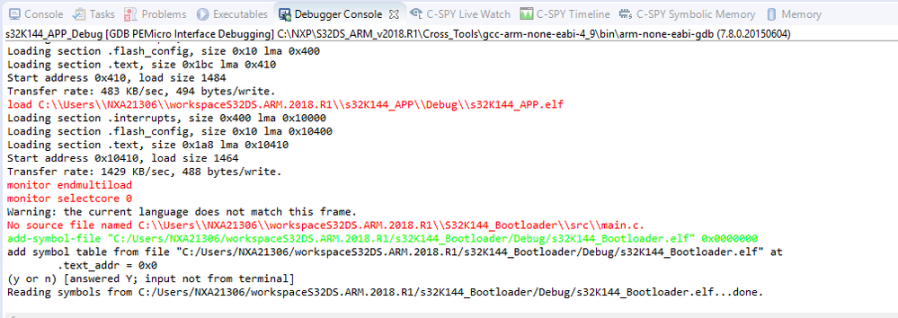

In order to display source and symbols for the bootloader elf please enter "add-symbol-file"  GDB command into Debugger Console View:
add-symbol-file "C:/Users/NXA21306/workspaceS32DS.ARM.2018.R1/s32K144_Bootloader/Debug/s32K144_Bootloader.elf" 0x0000000‍‍‍‍
The GDB client command could be executed automatically when launching a debug session:

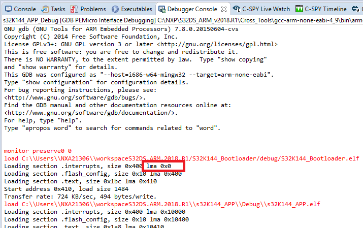

The first argument is path to the elf file and the second argument (0x00000000) is the load address of the elf file (see the first bootloader load address ).
Finally the debug session needs to be refreshed in order to display changes from just added symbol file. The refresh can be forced by performing a single step or issuing the target reset from the debugger.
