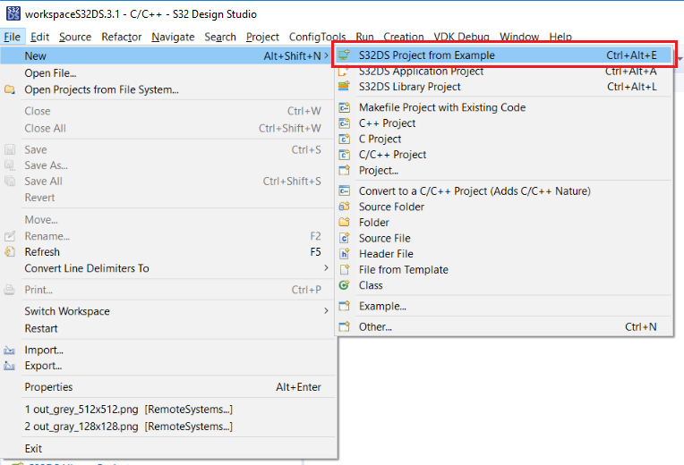

2) Select "New S32DS Project from example"

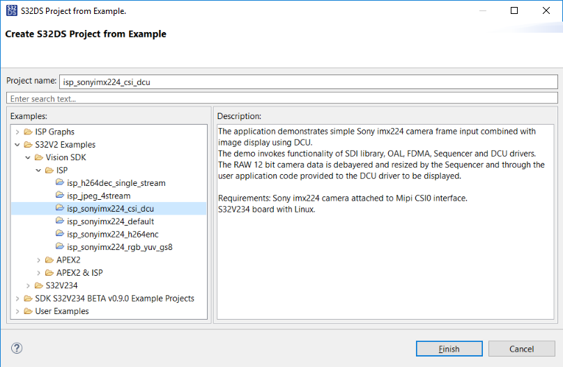

3) Select isp_sonyimx224_csi_dcu project and click Finish.

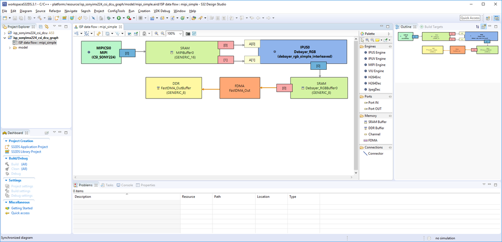

   In this particular project, the ISP graph diagram is included. If you wish to view it, go to the Project Explorer panel and expand 'isp_sonyimx224_csi_dcu_graph'. Then double click on 'ISP data flow : mipi_simple'. The ISP graph diagram will appear in the editor panel.

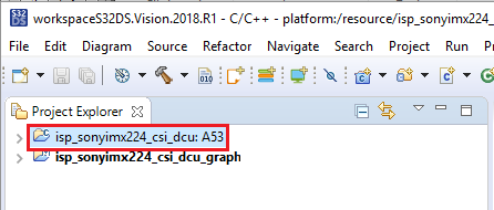

5) We are ready to build the project, but first, select isp_sonyimx224_csi_dcu: A53 in the Project Explorer panel

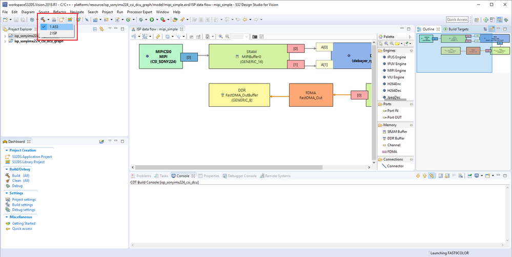

6) Build project for A53
7) Start a debug session using method as described in HOWTO: Create S32V234 Cortex-A53 Linux Project in S32DS, beginning at step 10.

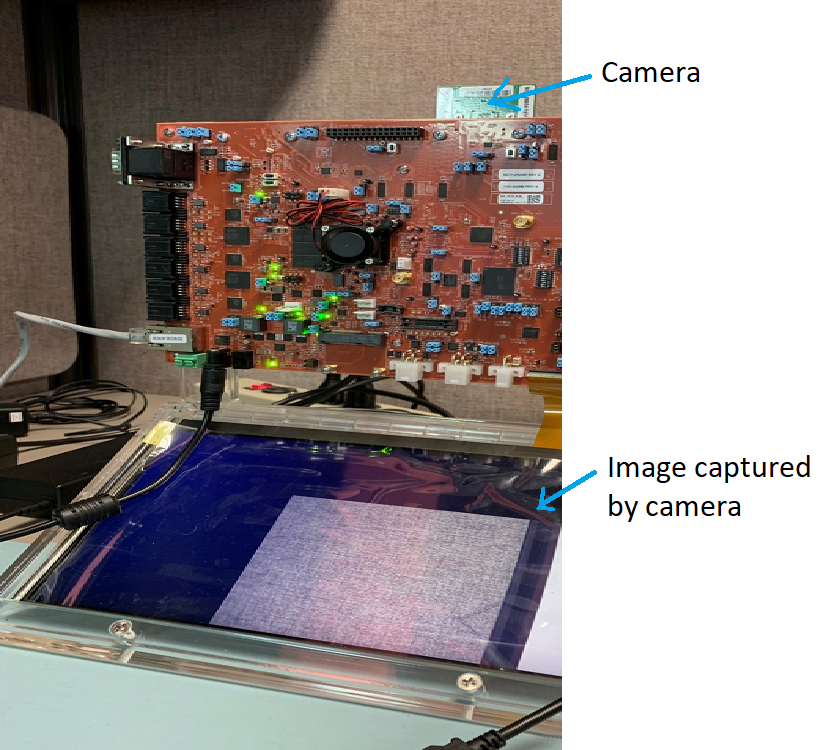

8) Should get results similar to this:
