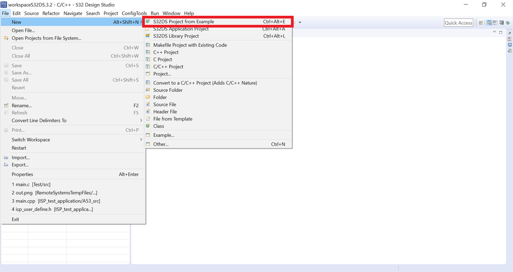

2) Select 'File -> New -> S32DS Project from Example'

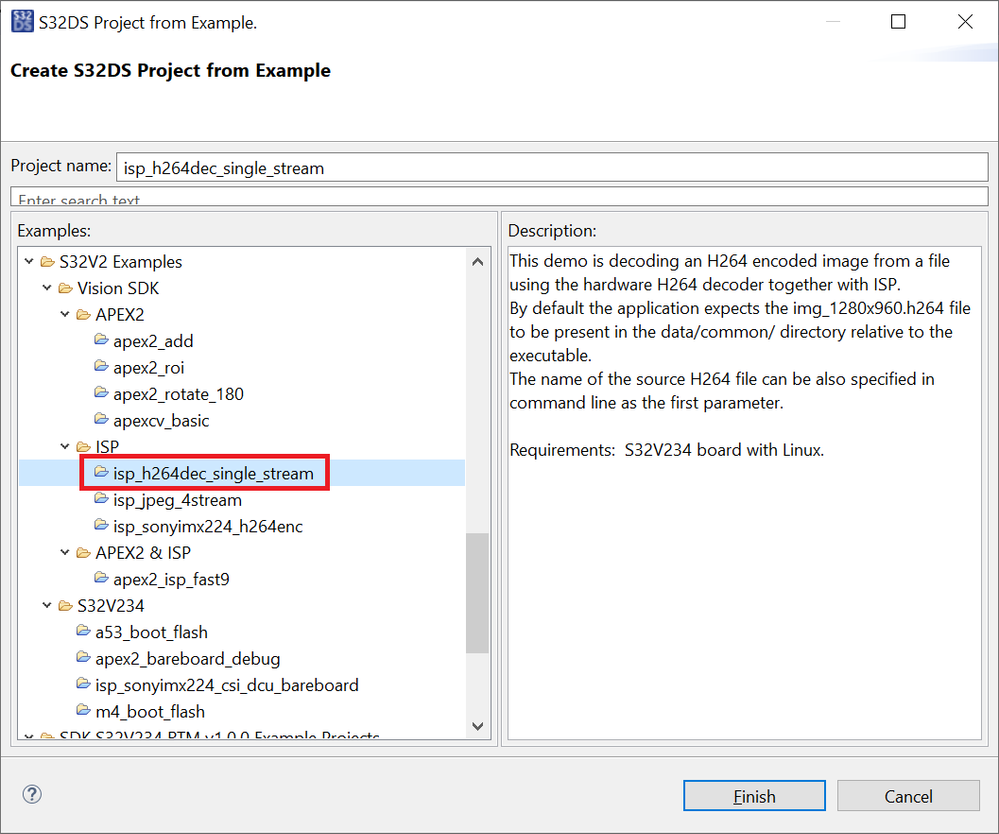

3) Select 'isp_h264dec_single_stream' project

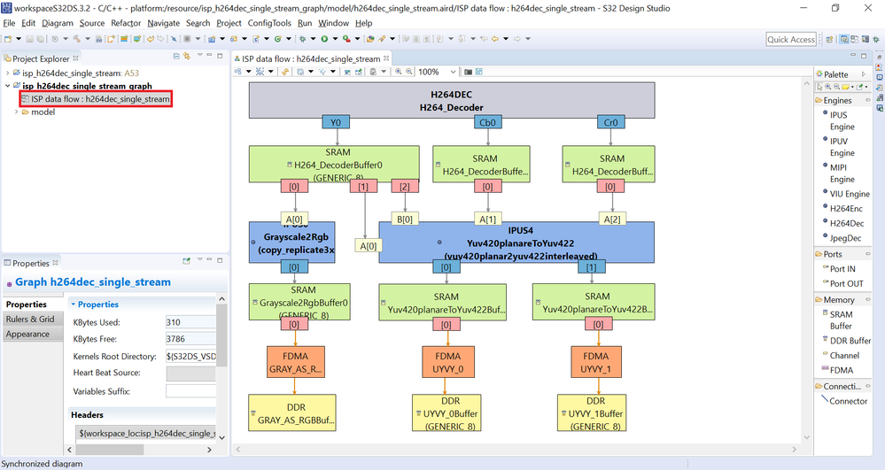

   In this particular project, the ISP graph diagram is included. If you wish to view it, go to the Project Explorer panel and expand 'isp_h264dec_single_stream_graph'. Then double click on 'ISP data flow : h264dec_single_stream'. The ISP graph diagram will appear in the editor panel.

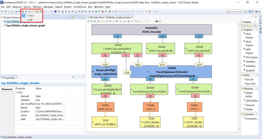

4) If not in the C/C++ Perspective, switch over by clicking on the icon showed below (Hovering over the correct icon should display 'C/C++'). The current perspective is displayed on the top bar.
5) Select isp_h264dec_single_stream: A53 in the Project Explorer panel
