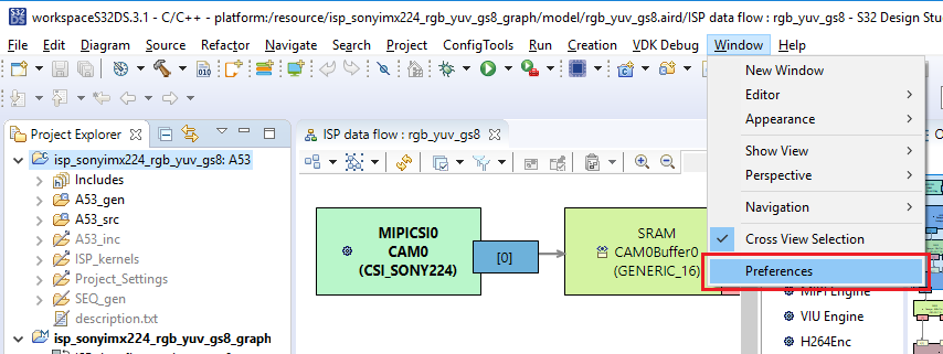

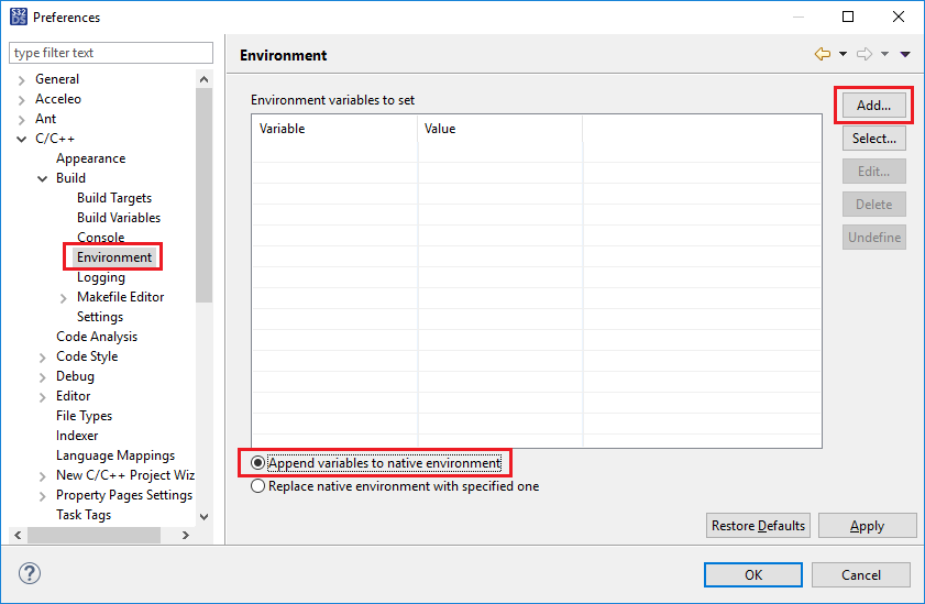

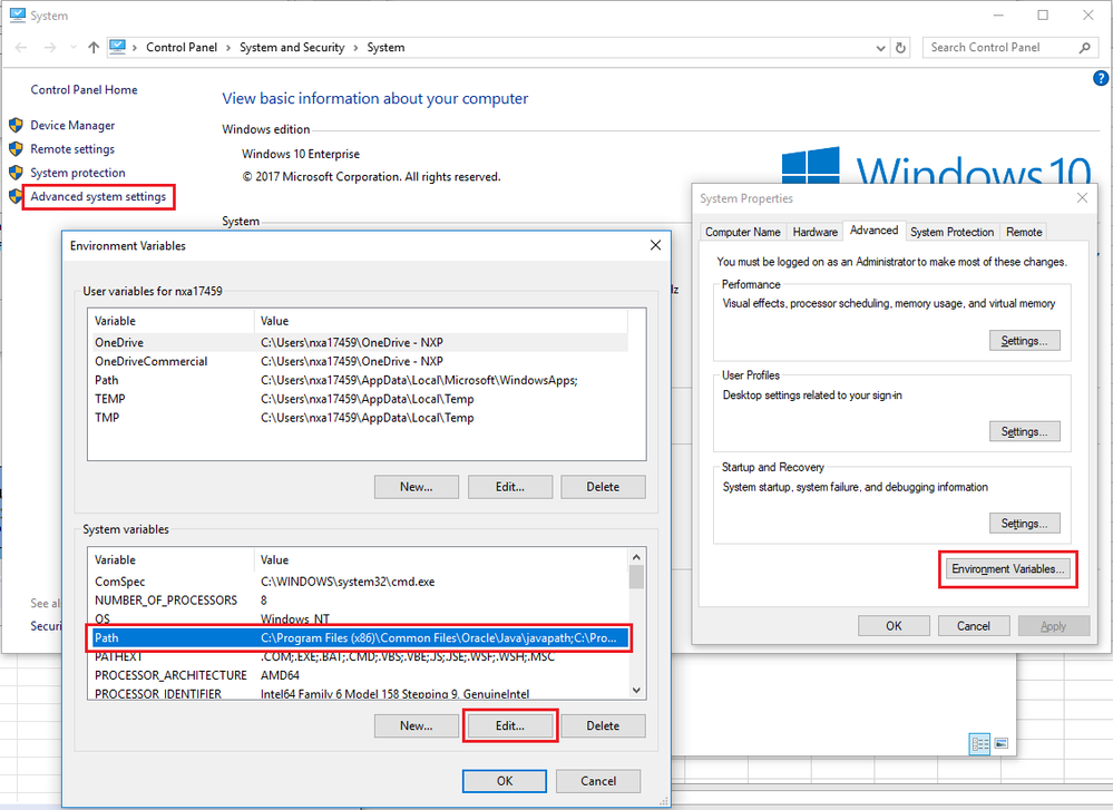

The paths and variables can be added to the entire workspace within S32DS . These will not be visible outside of S32DS and therefore will not affect the entire Windows environment. This is useful if you have a large number of projects with common requirements for paths and variables and do not want them visible any tools outside of S32DS.
Method 3
The paths and variables can be added globally to the Windows environment and will affect all installed tools. This method is not recommended.

It is also necessary to add the following Windows system variables:
Variable Name: S32V234_SDK_ROOT
Variable Value: C:\NXP\S32DS_Vision_v2018.R1\S32DS\s32v234_sdk
Variable Name: APU_TOOLS
Variable Value: C:\NXP\S32DS_Vision_v2018.R1\S32DS\APUC

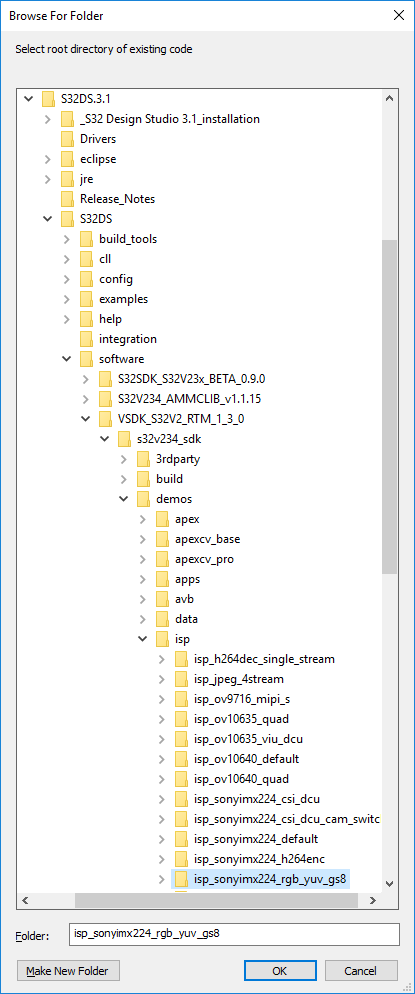

6) For 'Existing Code Location',
   a) Select 'Browse...' and then select the directory  C:\NXP\S32DS.3.1\S32DS\software\VSDK_S32V2_RTM_1_3_0\s32v234_sdk\demos\isp\isp_sonyimx224_rgb_yuv_gs8
   b) Click OK

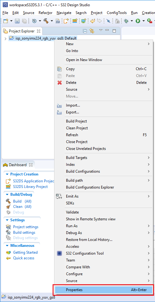

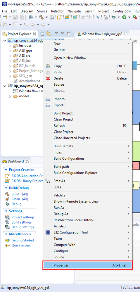

9) Right-click on the project from the Project Explorer. Select Properties

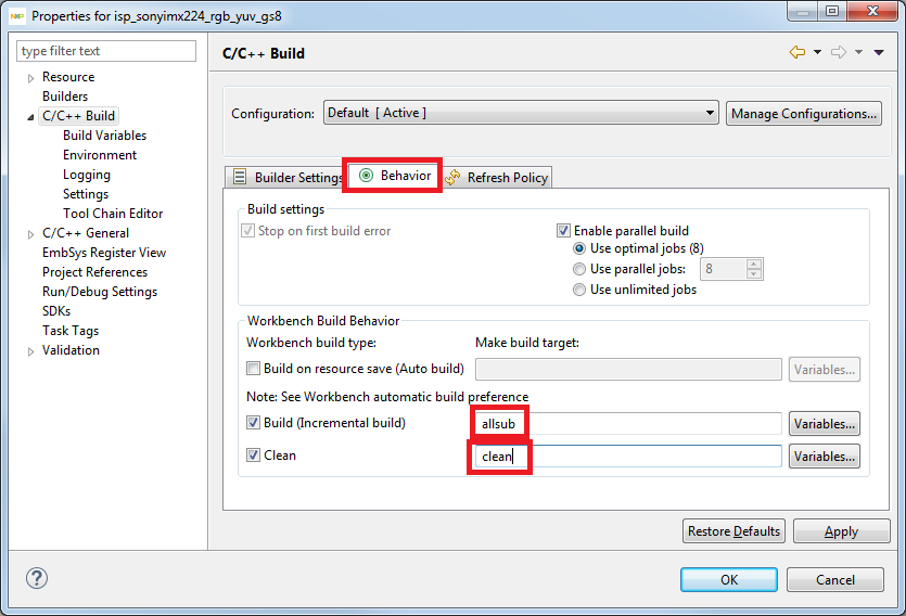

10) Go to section 'C/C++ Build'
11) Go to the 'Behavior' tab and in the field next to 'Build', enter:
   ISP examples: 'allsub'
   APEX examples: 'APU_COMP=nxp allsub'

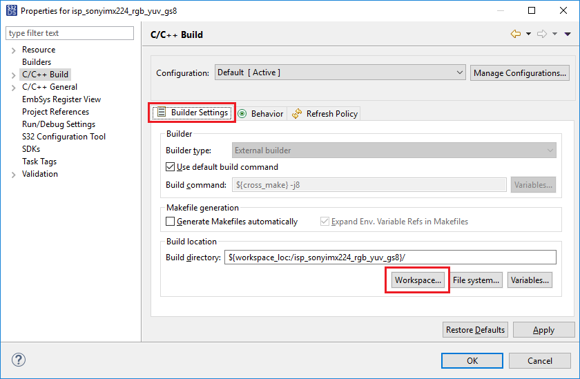

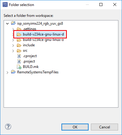

12) Go to 'Builder Settings' tab, in 'Build location' section change the path for the 'Build directory'. Click on 'Workspace...' button
13) In the Folder selection menu, select the subfolder 'build-v234ce-gnu-linux-d' and click OK

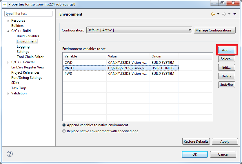

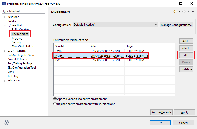

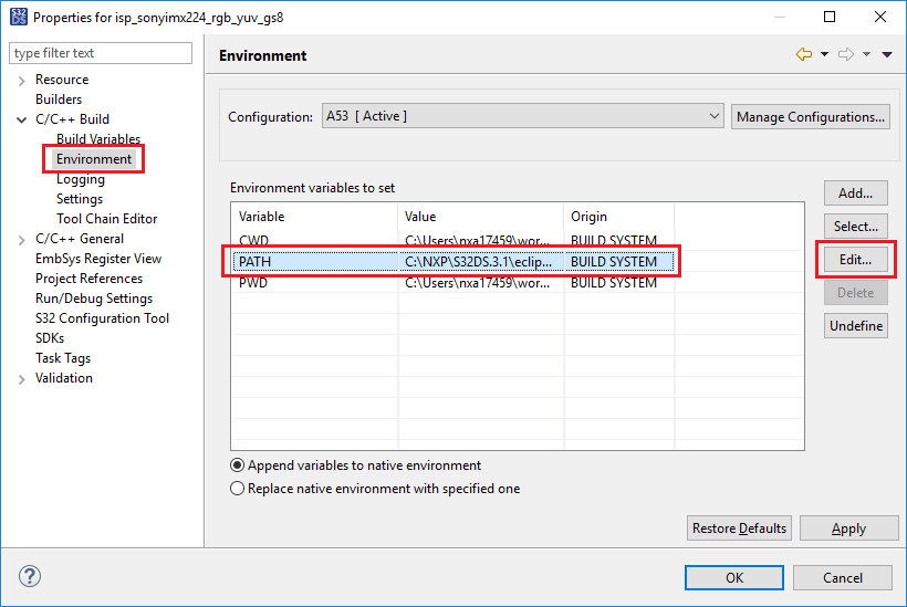

14) Go to section 'Environment'

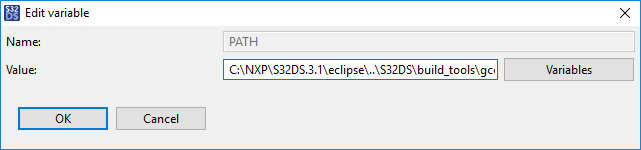

15) Select the environment variable 'PATH' and click 'Edit...'

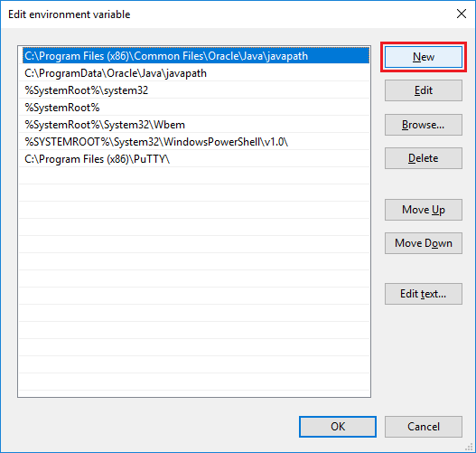

16) Add the path variables to the value field, each separated by a comma ';'
${S32DS_ARM32_TOOLCHAIN_DIR}
${S32DS_ARM64_LINUX_TOOLCHAIN_DIR}
${S32DS_ARM64_TOOLCHAIN_DIR}
${S32DS_GCC_TOOCHAIN_DIR}
Click OK

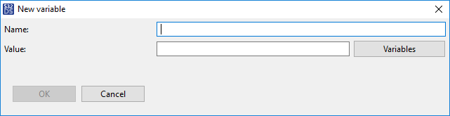

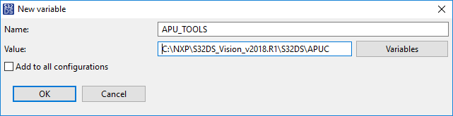

17) Click 'Add...'
18) Click 'Add...' and enter variable name 'APU_TOOLS' and value '${S32DS_APU_TOOLCHAIN_DIR}'
Click OK

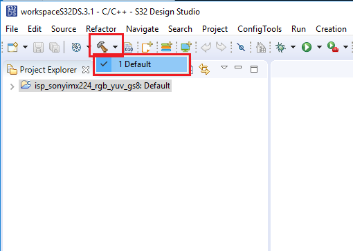

20) Click on 'Build'
21) Once the build is complete, the binary file (ELF) will be created
