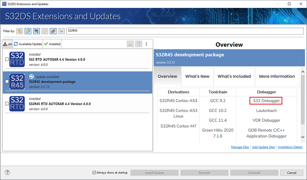

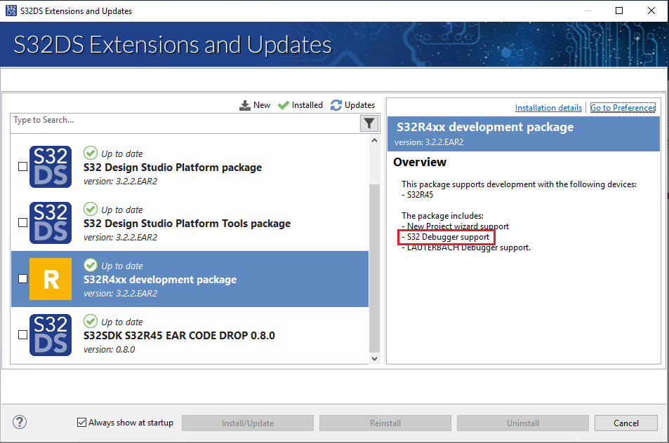

  1. Install S32 Design Studio IDE
  2. Install the Development Package for the device you are debugging. In this case, the S32R4xx development package. This is important as the S32 Debugger support within it contains the device-specific Python scripts required for initialization of the cores.

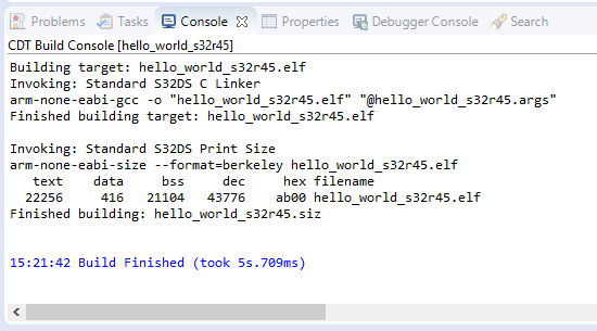

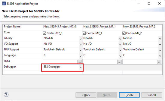

  4. Launch S32 Design Studio for S32 Platform

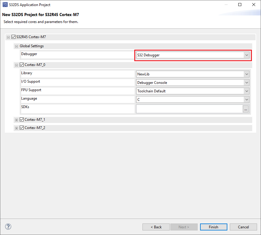

  5. Create new or open existing project and check that it successfully builds. If creating a new project, be sure the S32 Debugger is selected in the New Project Wizard.

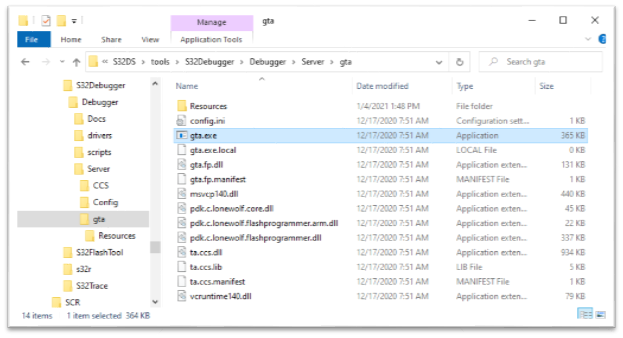

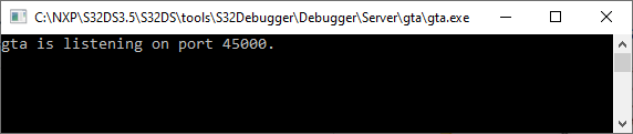

  1. Launch GTA server. From command prompt or Windows File Explorer run the command:
    {S32DS Install Path}\S32DS\tools\S32Debugger\Debugger\Server\gta\gta.exe
    Should see a window appear like this:

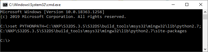

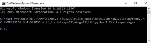

  2. Ensure Environment Variable for Python is set. From command prompt, run the command:
    set PYTHONPATH={S32DS Install Path}\S32DS\build_tools\msys32\mingw32\lib\python2.7;{S32DS Install Path}\S32DS\build_tools\msys32\mingw32\lib\python2.7\site-packages

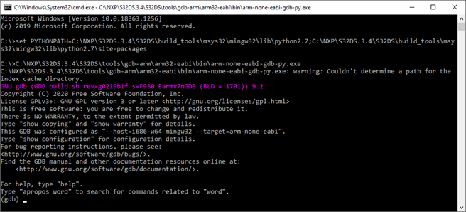

  3. Start GDB. In a command window, run the command:
    Windows OS:
    {S32DS Install Path}\S32DS\tools\gdb-arm\arm32-eabi\bin\arm-none-eabi-gdb-py.exe (for arm32)
    OR
    {S32DS Install Path}\S32DS\tools\gdb-arm\arm64-eabi\bin\aarch64-none-elf-gdb-py.exe (for arm64)
    Linux OS: arm-none-eabi-gdb-py
    A (gdb) prompt should now be displayed in the command window:

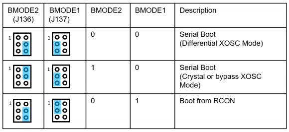

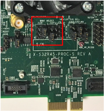

  4. Configure the EVB's Boot Mode switches for Serial Boot.
