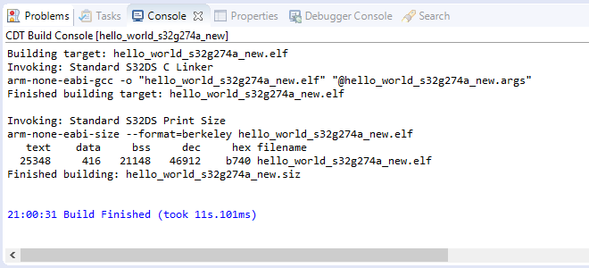

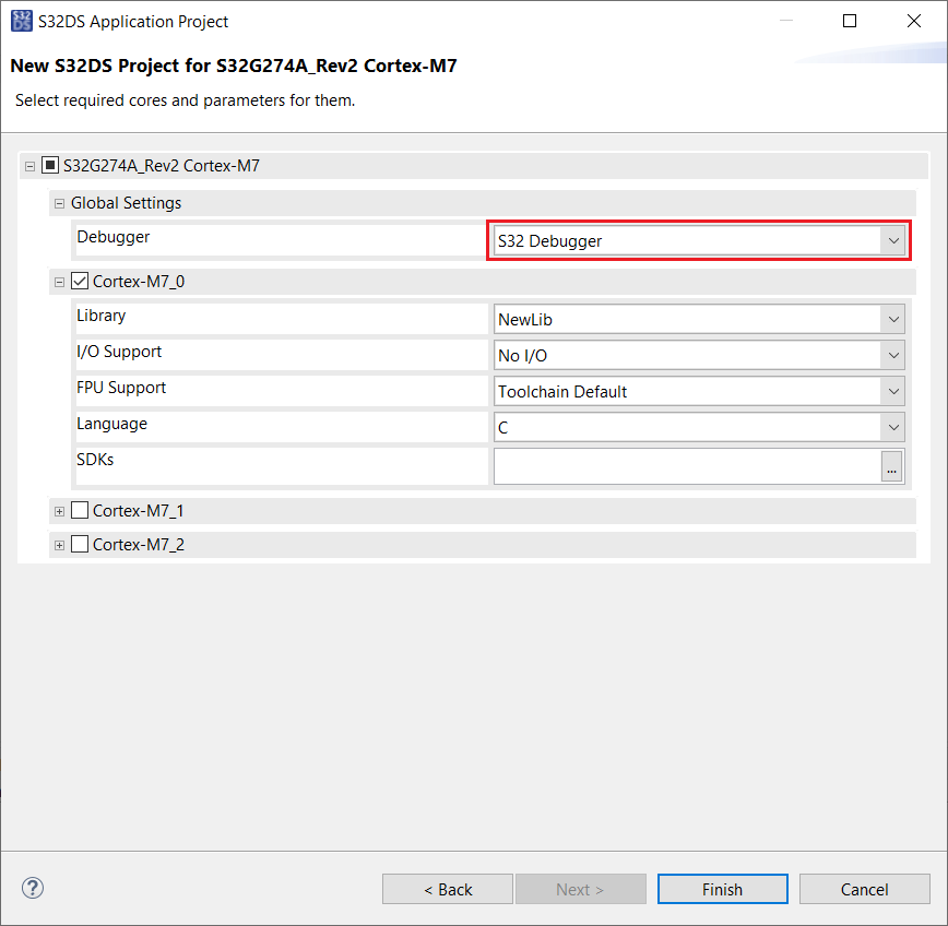

  5. Create new or open existing project and check that it successfully builds. If creating a new project, be sure the S32 Debugger is selected in the New Project Wizard.

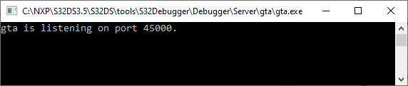

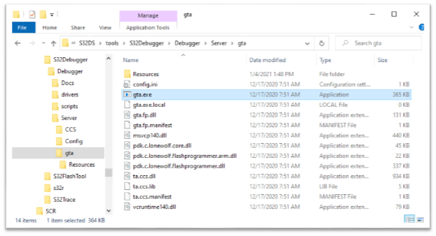

  1. Launch GTA server. From command prompt or Windows File Explorer run the command:
    {S32DS Install Path}\S32DS\tools\S32Debugger\Debugger\Server\gta\gta.exe
    Should see a window appear like this:

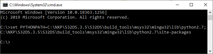

  2. Ensure Environment Variable for Python is set. From command prompt, run the command:
    set PYTHONPATH={S32DS Install Path}\S32DS\build_tools\msys32\mingw32\lib\python2.7;{S32DS Install Path}\S32DS\build_tools\msys32\mingw32\lib\python2.7\site-packages

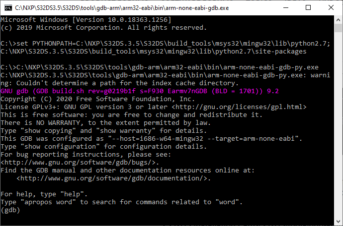

  3. Start GDB. In a command window, run the command:
    Windows OS:
    {S32DS Install Path}\S32DS\tools\gdb-arm\arm32-eabi\bin\arm-none-eabi-gdb-py.exe (for arm32)
    OR
    {S32DS Install Path}\S32DS\tools\gdb-arm\arm64-eabi\bin\aarch64-none-elf-gdb-py.exe (for arm64)
    Linux OS: arm-none-eabi-gdb-py
    A (gdb) prompt should now be displayed in the command window.

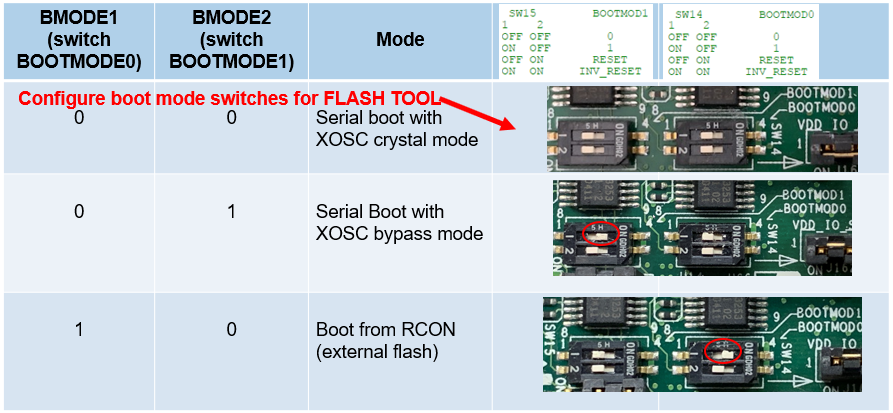

  4. Configure the EVB's Boot Mode switches for Serial Boot.
