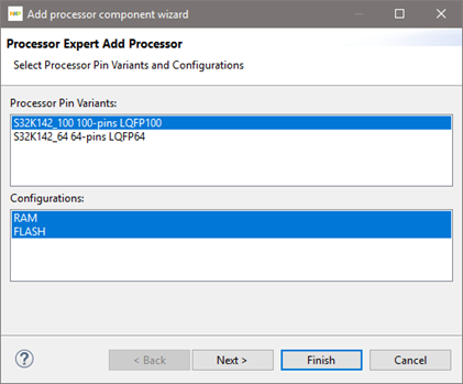

2) From the Components Library, Processors tab, select the new MCU derivative
3) Either double-click OR right-click and select 'Add to project', to add the new processor to your components list for your project. Be sure to select just one of the pin packages, whichever is appropriate for you application.

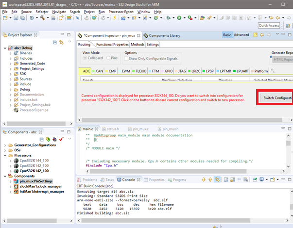

4) From the Component Inspector*, you will see a message in red text asking if you would like to switch into the configuration for the new processor. Click on the button 'Switch Configuration'.
*may have to select pin_mux:PinSettings in the Components view for the project to see the message

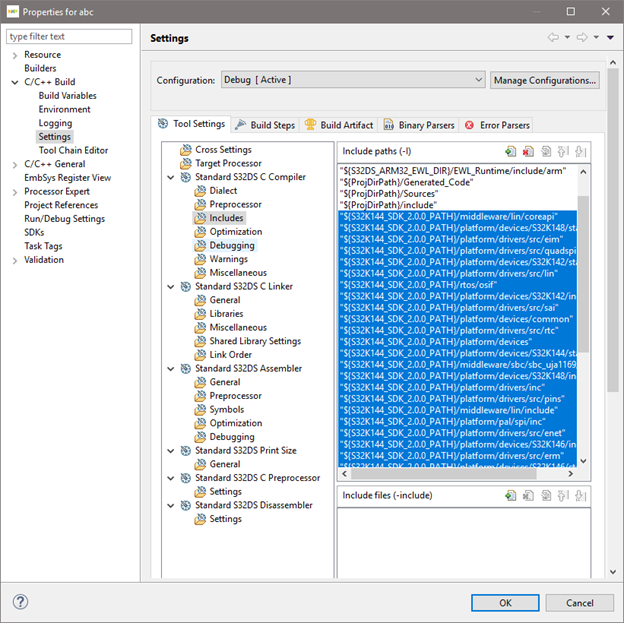

5) Open the Project Properties, either select from File menu or right-click on project name and select from the menu. Then go to C/C++ Build -> Settings -> Standard S32DS C Compiler -> Includes and delete all include paths starting with $(S32K1**_SDK_VER_PATH). Repeat this step for the Standard S32DS Assembler -> General include paths. Note: For all changes in C/C++ Build -> Settings, make sure to repeat for all build configurations (RAM, FLASH, Debug, Release, etc.).
6) The paths to the SDK should now be gone. The result should look similar to this:

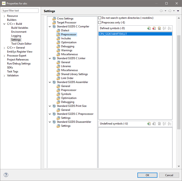

7) In Standard S32DS C Compiler -> Preprocessor settings, change the defined symbol to the one which is appropriate for the new MCU and click OK. (e.g. CPU_S32K142 for S32K142, CPU_S32K148 for S32K148, etc.) If you are not sure what should be here, then create a new empty project for the new MCU and refer to the settings there.
8) The Preprocessor setting after the change

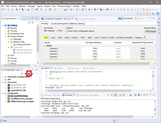

9) Click on the 'Generate Processor Expert Code' button in the Components view for your project

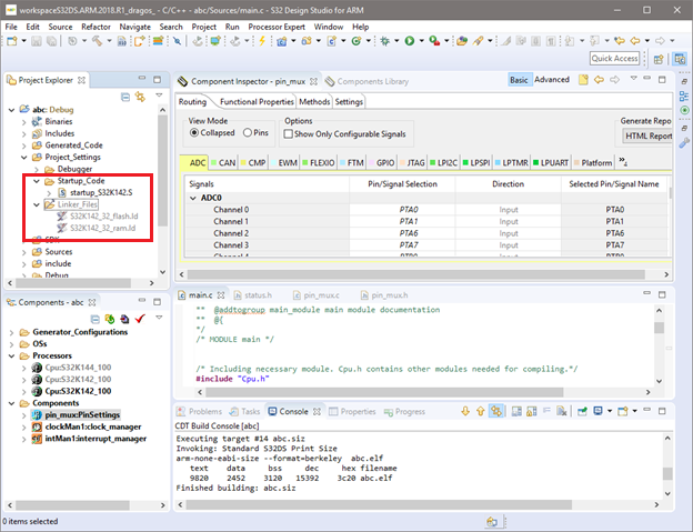

10) From Project Explorer, remove the startup and linker files from Project Settings folder
11) Copy startup and linker files for the new MCU from <SDK_PATH>/platform/devices/<CPU>/startup/<Compiler> and <SDK_PATH>/platform/devices/<CPU>/linker/<Compiler>

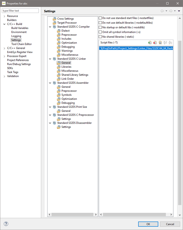

12) Open the Project Properties, then C/C++ Build -> Settings -> Standard S32DS C Linker -> General and update the linker file path to reflect the new filename and click OK. (in this case: S32K144_64_flash.id to S32K142_32_flash.id)
13) After the change

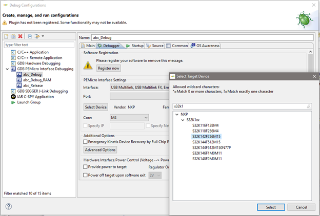

15) Update the device in the debug configurations

hello,Mike Doidge .
I encountered some problems, about the project settings file linker_files and starup_code is S32K144, did not replace with S32K142. How can I replace it, please?Thank you!
Hello wangaoyuan@glb-auto.com‌,
To replace the files, you should first remove the existing files. Right-click on each one and select 'Delete' from the menu. After you have removed the files, then you can use Windows Explorer to locate the new ones. Once you have located the new files, you can drag and drop them onto the appropriate folders within Project Explorer in S32 Design Studio.
