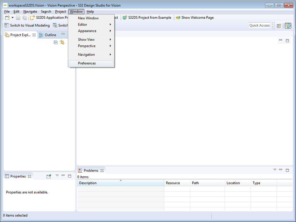

1. Go to the main menu "Window -> Preferences"

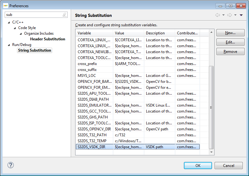

2. Filter the preference dialog with "sub" keyword or just navigate to "Run/Debug -> String Substitution node.

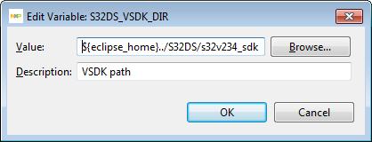

3. Edit Variable "S32DS_VSDK_DIR" to assign another value to be substituted as Vision SDK root
