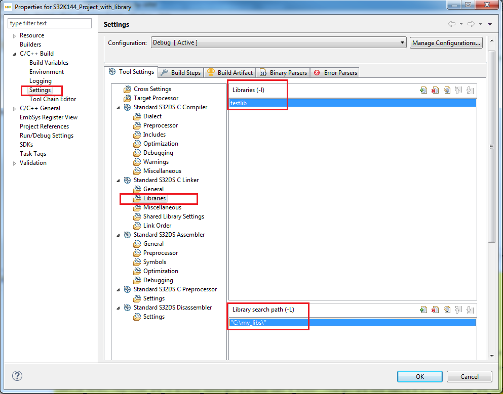

Adding a static library WITHOUT dependency to executable (elf) file
This approach assumes a library does not change. An update of the library does not trigger project rebuild process. If the library changes the project needs to be manually cleaned (assuming no other source file has changed) and next build links the updated library.
The path to the library and the library name shall be entered into Project Properties -> C/C++ Build -> Settings -> Standard S32DS C Linker -> Libraries
Please note that GCC adds prefix "lib" and the extension ".a"  to the library name entered into the above dialog by default.
GCC linker will search for the library file named: "libtestlib.a" in the folder "c:\my_libs" In the example above.

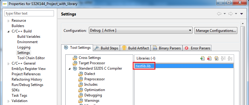

For a custom library name add colon character ":" at the beginning of the library name to disable the default prefix/extension expansion.
GCC linker now searches for file name "testlib.lib" in the example below:

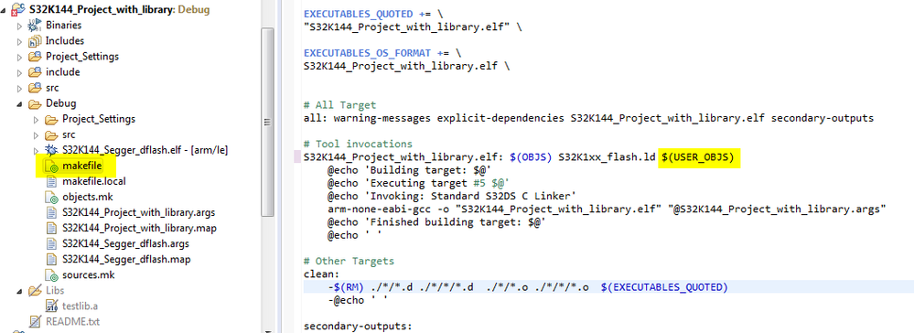

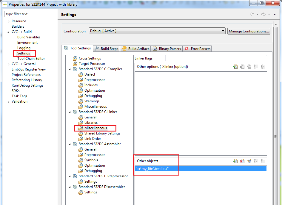

If a static library has changed - "touched"  it is sometimes desired to trigger project rebuild. In this scenario the library shall be added into a different project dialog:
Project Properties -> C/C++ Build -> Settings -> Standard S32DS C Linker -> Miscellaneous -> Other objects
The items from "Other objects" list is propagated into USER_OBJS makefile variable which is prerequisite for auto-generated makefile rule that build the target (elf):
