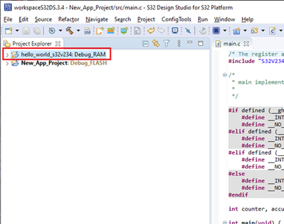

  1. Load the existing project. For this demonstration, the SDK project ‘hello_world_s32v234’ will be used.
  2. Select the project so it appears highlighted in blue.
    Notice that the other project, ‘New_App_Project’, is bold text. This is because the main.c file open in the editor window to the right is the currently selected source file and is from this project. This has no effect on the process detailed in this document.

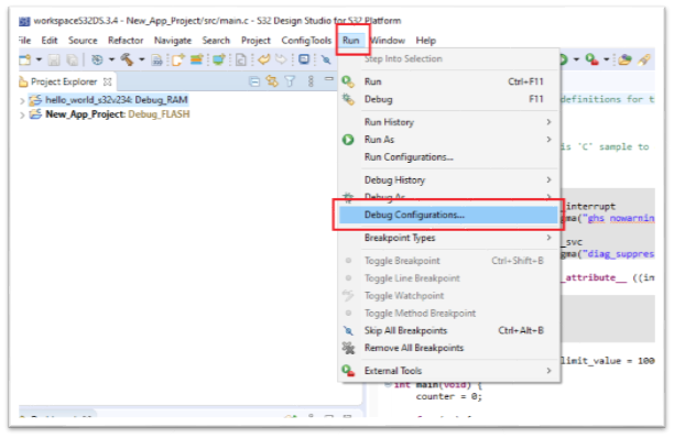

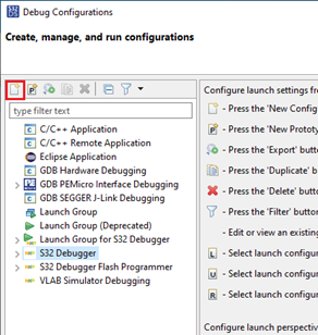

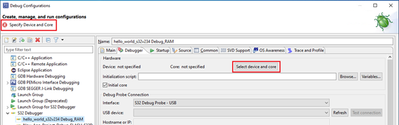

  4. Open the Debug Configurations menu. Run -> Debug Configurations

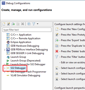

  5. Now select the Debugger Group for which you wish to create the new configuration. In this case, we will select ‘S32 Debugger’.
  6. Next, click ‘New Launch Configuration’

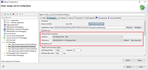

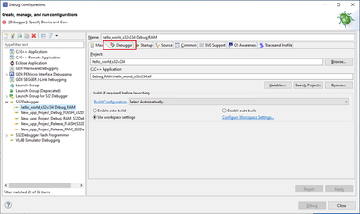

  7. Now a new Debug Configuration has been created for your project and for the S32 Debugger. Most of the fields are already completed for you. Select the Debugger tab to see the source of the error message.
  8. The error message indicates ‘Specify Device and Core’. So click on ‘Select device and core’.

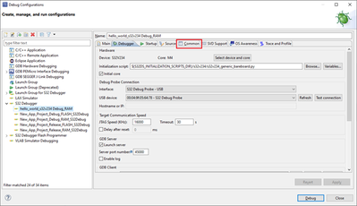

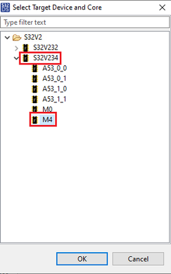

  9. Now expand the lists until the Device and Core are visible. Select the correct core for your project. In the demonstration example, the correct Device and Core are ‘S32V234’ and ‘M4’, respectively. Click OK, when done.

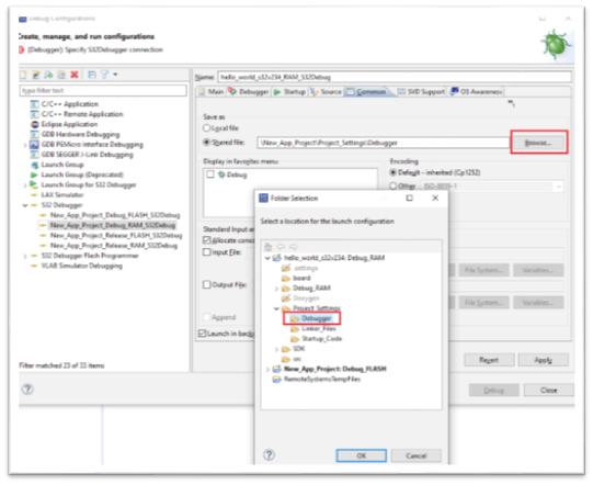

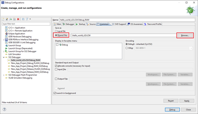

  10. If you have a debug probe connected, it may have been detected. If not, the Debug Probe Connection section will need to be completed. Now select the ‘Common’ tab to setup the storage location for this new Debug Configuration.

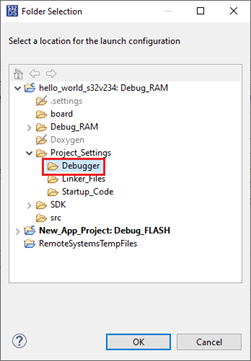

  11. Select ‘Shared file’ and then ‘Browse…’
  12. Expand the lists until ‘Project_Settings/Debugger’ is open. Select ‘Debugger’, then click OK.

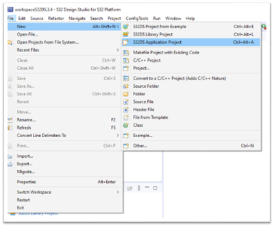

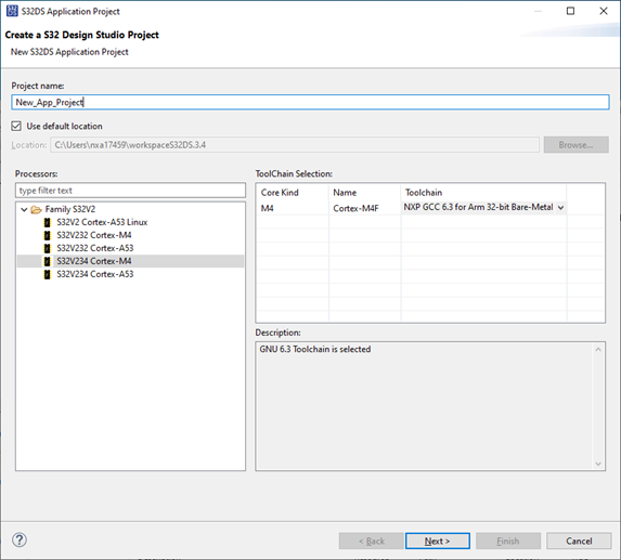

  1. Create new project
    1. New -> S32DS Application Project
    2. New Project Wizard, processor and toolchain page
      1. Enter a project name
      2. Select the device and core to match the existing project
      3. If necessary, select the toolchain to match the existing project
      4. Click Next

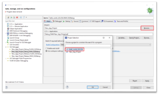

      3. Main tab
        1. Project field
          1. Click Browse...
          2. Select existing project

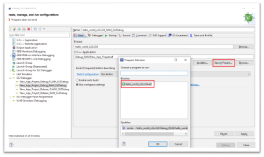

        2. C/C++ Application
          1. Click Search Project...
          2. Select the Elf file
      4. Common tab
        1. Save as field
          1. Click Browse...
          2. Select {existing_project_name}\Project_Settings\Debugger
      5. Debugger tab, Debug Probe Connection
        1. Setup connection parameters
