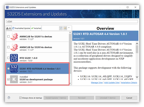

  1. Setup the software tools
    1. Install S32 Design Studio for S32 Platform
    2. Install the S32K1xx development package and the S32K1 RTD AUTOSAR 4.4. Both of these are required for the S32 Configuration Tools.
      S32DS Extensions and Updates S32K1 RTD 101.pngS32DS Extensions and Updates S32K1 RTD 101.png

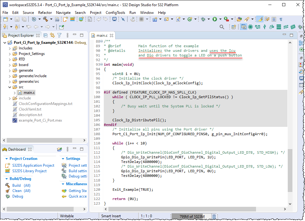

1. Import Port_Ci_Port_Ip_Example_S32K144 example
File->New->S32DS Project from Example
import Port_Ci_Port_Ip_Example_S32K144.pngimport Port_Ci_Port_Ip_Example_S32K144.png
Although the main function mentions the example use the Icu and Dio drivers to toggle a LED on a push button, it actually just waits in a loop for a delay to blink the LED. Not sure why the implementation of GPIO interrupts(Port_Ci_Icu) is missing.

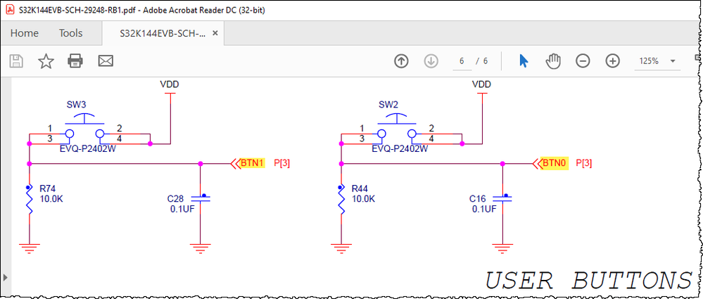

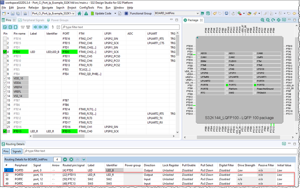

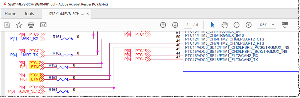

2. Add push button and LED in Pins tool
Add the pins for user buttons (SW2 PTC12 and SW3 PTC13) and LEDRGB_RED (RGB_RED PTD15) according to the S32K144EVB schematic RB1.
USER BUTTONS S32K144EVB.pngUSER BUTTONS S32K144EVB.pngBTN0 PTC12 BTN1 PTC13.pngBTN0 PTC12 BTN1 PTC13.png

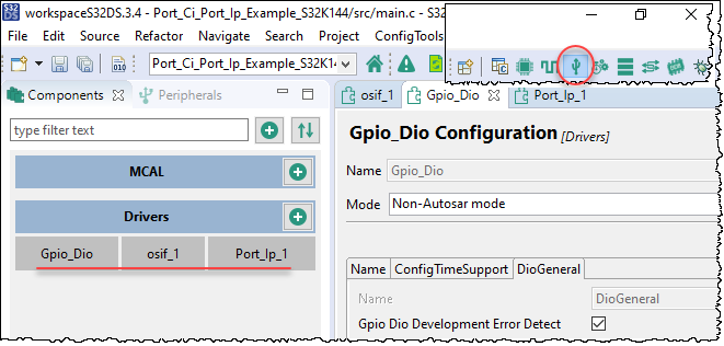

Go to Peripherals tool. Here we can see that the ‘Gpio_Dio’ and ‘Port’ components are already added.

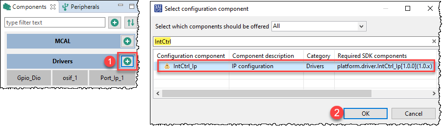

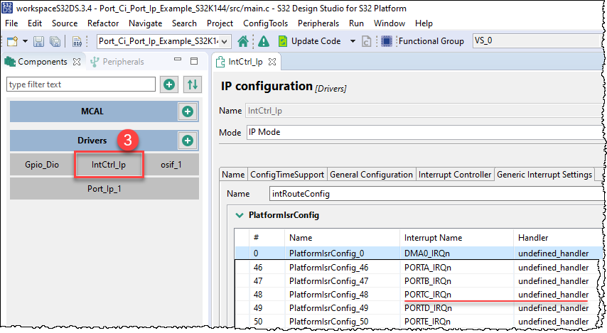

From the Components view, click on ‘Add a new configuration component…’ button from the Drivers category. This will bring up a list of non-AUTOSAR components. Locate and then select the ‘IntCtrl_Ip’ component from the list and click OK.
Keep the default setting after add ‘IntCtrl_Ip’ component, we will call IntCtrl_Ip_InstallHandler and IntCtrl_Ip_EnableIrq those two APIs to install and enable the PORTC IRQ separately. (Here we didn't change the settings of ‘IntCtrl_Ip’, nor use IntCtrl_Ip_Init and IntCtrl_Ip_ConfigIrqRouting API to enable interrupts and install handlers in IntCtrl_Ip.)

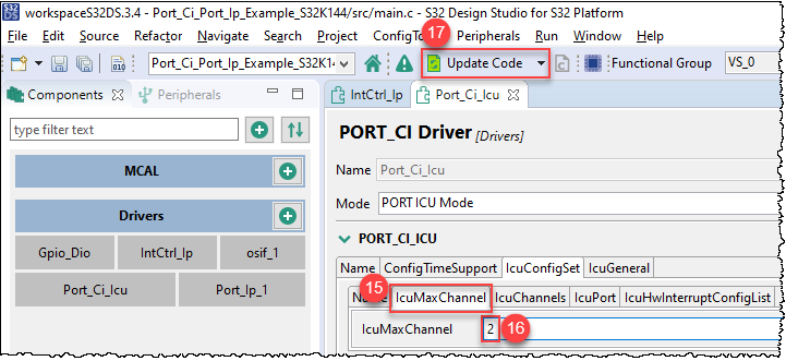

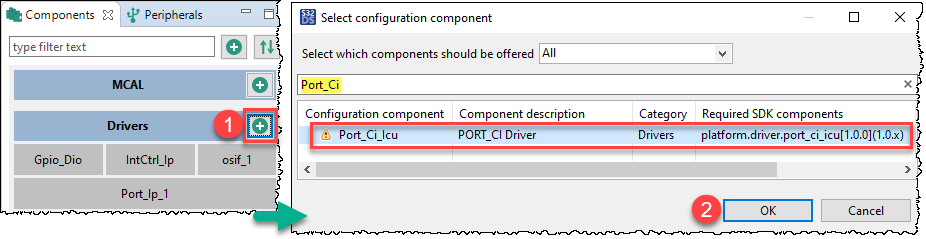

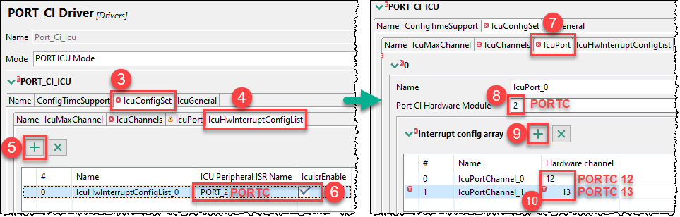

4. Add Port_Ci_Icu component
Locate and then select the ‘Port_Ci_Icu’ component from the list and click OK. Follow the steps below to configure it.

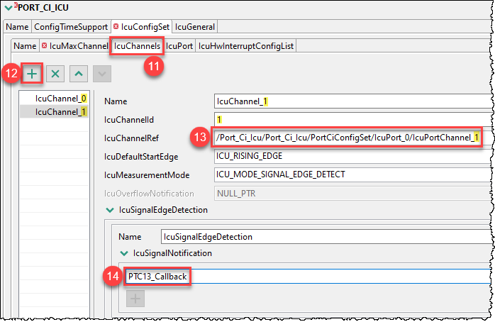

Selecting PORT_2 for ICU Peripheral ISR Name and select IcuIsrEnable at step 6 actually refers to PORT C used in this example. In order to use the GPIO interrupts of the onboard SW2 (PTC12) and SW3 (PTC13) buttons, you need to add one more channel in step 9, and select Port CI Hardware Module and Hardware channel in steps 8 and 10.
The button circuit has a pull-down resistor, and it will be pulled high after being pressed, so the rising edge trigger is selected. In step 14, add IcuSignalNotification for PTC12 and PTC13 respectively, that is, the notification after the corresponding GPIO pin input captures the rising edge (there is no need to clear the interrupt flag here, the RTD driver has already done it).

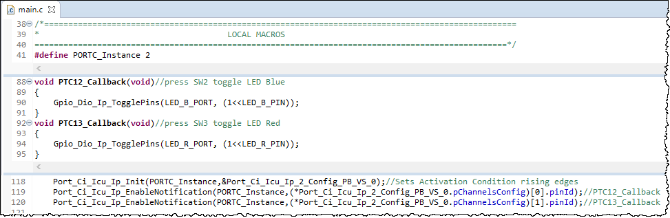

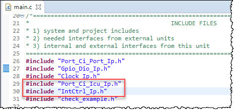

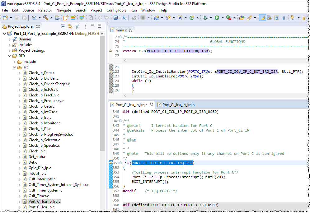

5. Include the headers for the drivers used in the application
6. Add Port_Ci_Icu drivers
Port_Ci_Icu_Ip_Init initialize the rising edge of PTC12 and PTC13 set by the S32 Configuration Tools. Port_Ci_Icu_Ip_EnableNotification enable the Callback of PTC12 and PTC13 respectively, and we toggle the blue and red LEDs in the corresponding Callback.
7. Add IntCtrl drivers
IntCtrl_Ip_InstallHandler installs the PORT_CI_ICU_IP_C_EXT_IRQ_ISR interrupt handler generated by the S32 Configuration Tools.
