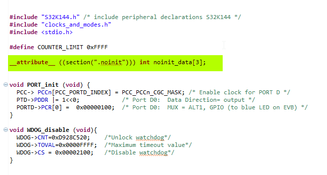

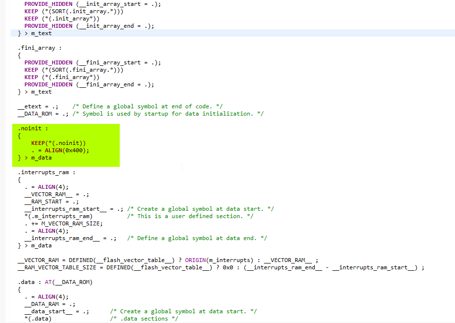

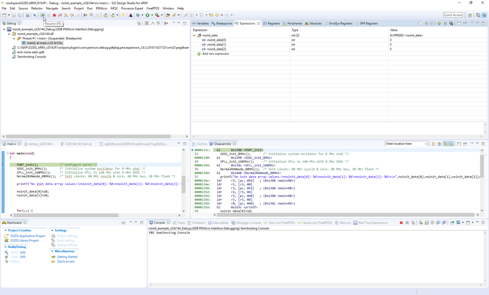

After startup - uninitialized RAM is set to 0 by startup code (startup_S32K144.S). If you need access to data stored in the RAM after reset is performed, you can  add these variables into .noinit section. You need to update your linker file and add .noinit section aligned to 1024 bytes before _RAM_START is defined:
In code assign your variable into .noinit section:
Example usage:

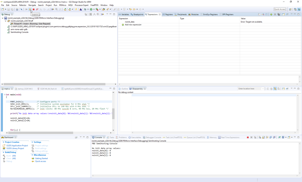

Import attached example into S32DS for ARM, build in and start debug session. Resume target

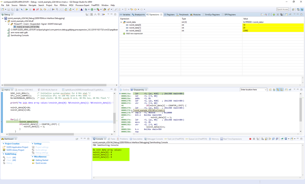

and suspend program execution:
In semihosting debug console you can see that noinit_data are set to 0. The board is in state after power ON:

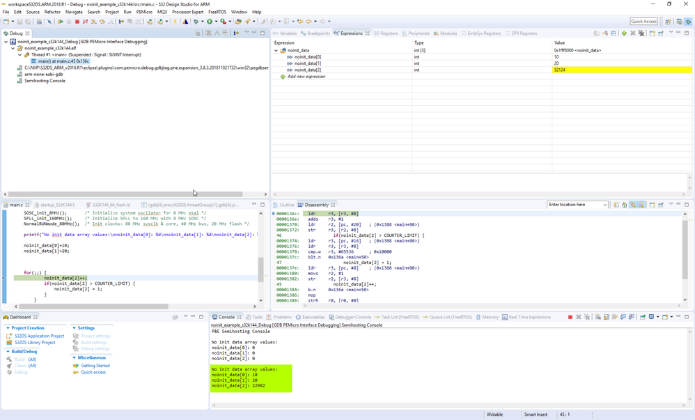

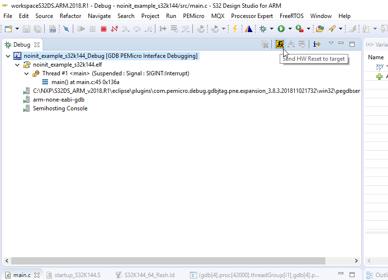

Reset board and let's check if data remains in RAM memory:
After resume, you can see in semihosting console (or expressions view), that data remains unchanged:

there is a bug in example - .noinit section needs to be aligned to 0x400.
Jiri

    I have diffrent opinion. At startup code, S32K will Init ECC RAM and it will clear all RAM(_RAM_START  to _RAM_END) . So,when I reset S32K, the Value is 0.
This code is jump !

__attribute__ ((section(".noinit"))) int noinit_data[5];
when  the s32k144  is  reset  by  wdog,   the noinit_data  is  keep  old value!
