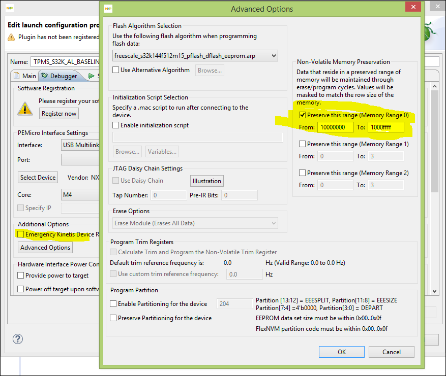

Please check, Below sequence and configuration
1) PE Configuration
2) UART Output
3) Firmware.
Main()
Init_EEPROM()
Problem:
When Write-Read Sequence OK
When only Read Sequence -NOK
Please, can your tell me anything I'm Missed out?

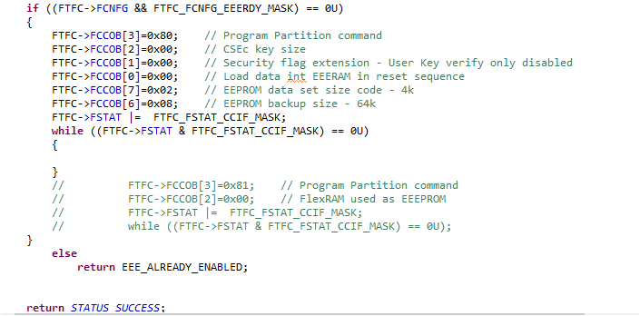

As I mentioned - there is bug in the Init_EEPROM (current example version is fixed). Please use binary & instead logical one:
if ((FTFC->FCNFG & FTFC_FCNFG_EEERDY_MASK) == 0U)
Emergency kinetis device recovery overrides Memory preservation - So don't use it. Also don't use Partitioning - it will be done by Init_EEPROM.

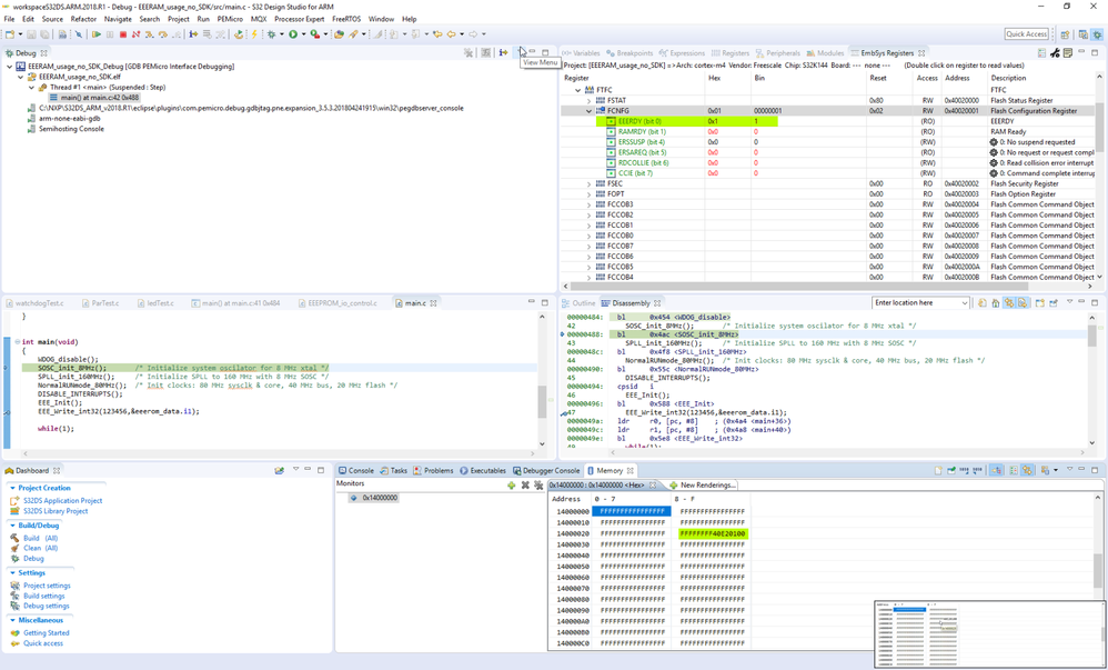

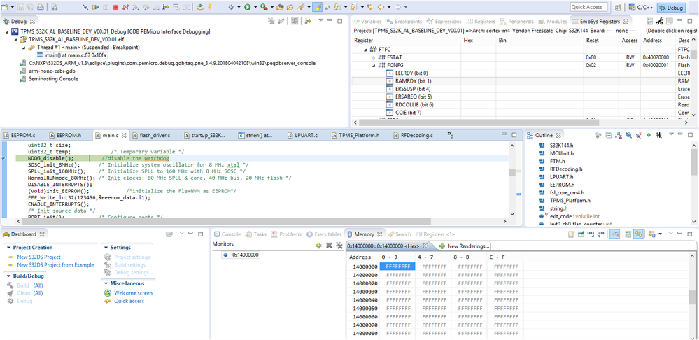

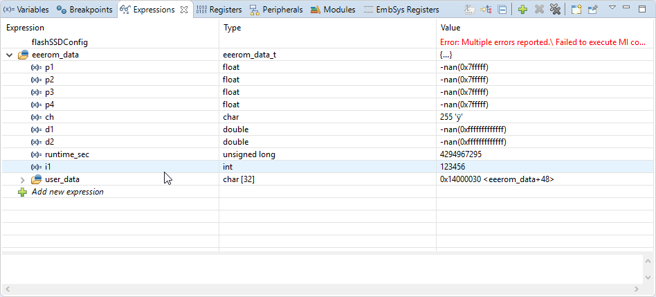

For me is settings from example working okay. Debug settings:
Newly started debug session - one step after WDOG_Disable() (just after last one when partitioning was performed):
You can also check data
Hope it helps.

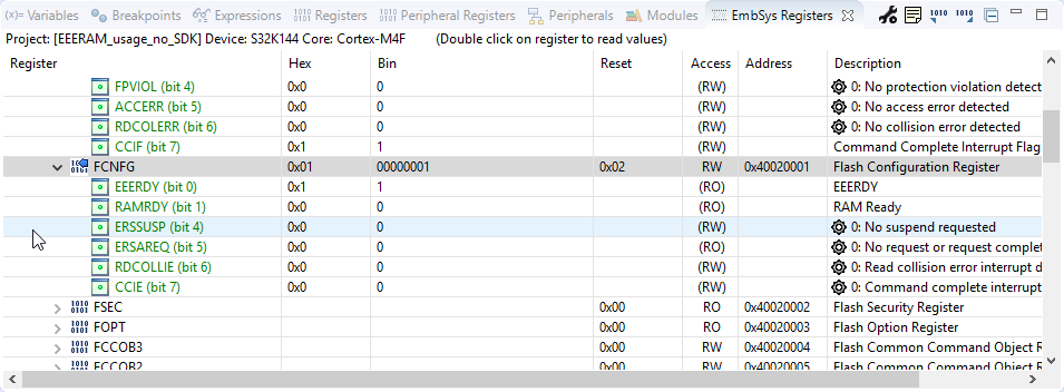

Please check if the FTFC->FCNFG->EEERDY bit is set to 1 before you run EEE_Write. It looks like that in your config is EEERAM area used as standard RAM.

Thanks for your Info,
Now I can able to get back the Written data in FlexRAM, But I have another problem is that Re-Flashing  will erase the Written Data,

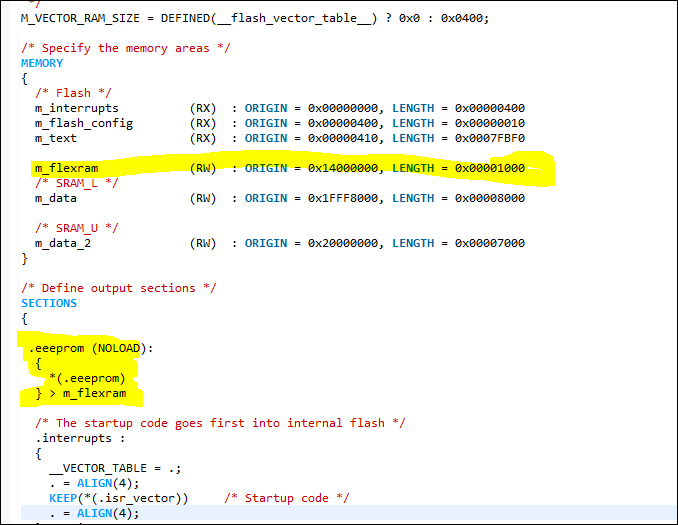

what should I do for overcoming this issue?
Should I modify the linker file?  which part of the linker file has to change?

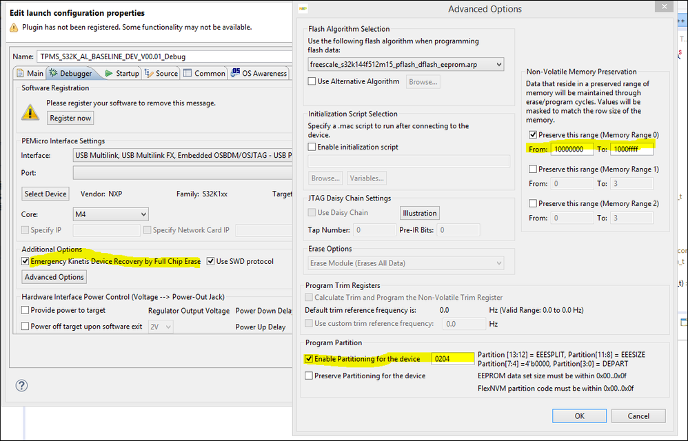

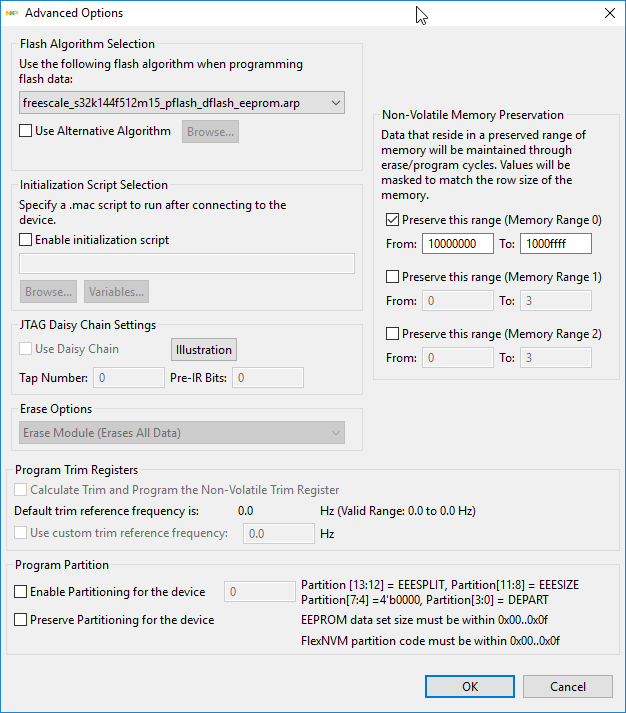

If you have preserved DFLASH memory (full DFLASH is from 0x10000000-0x1000FFFF) - PE Micro doesn't rewrite your stored data.
Also be sure that there is unchecked Emergency kinetis device recovery and you didn't perform partitioning via PE Micro.

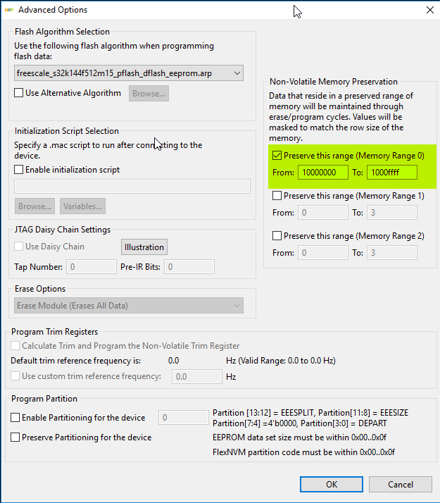

Yes below my setting,
The sequence is that,
►Write FlexRAM (14000000)
►Reset
►verify the structure variable mapped to EEPROM.(14000000) -OK
►Modfity the Application Build and Flash by OPENSDA on EVB Board.
►Reset
►Verify the structure variable mapped to EEPROM(14000000) data will be erased. -NOK
I have preserved the D-Flash Range, why data has been overwritten?
My Requirement is that
if the user configured the data only once should not be erased by updating the Program(Re-flash).This just program update not the configuration data update.
well - that's exactly for what memory preservation is used - and is working okay. There must be different issue with your project. The fundamental is - EEERAM partitioned as emulated EEPROM (FTFC->FCNFG->EEERDY = 1 ), and memory preservation. The example at very top is working for you? If it is possible - can you please share your project with me? I'll look at it.

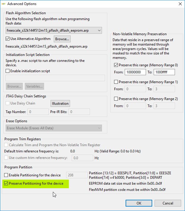

finally - I can reproduce the issue - thank you for keep going this thread. I didn't realize that in my case there was not change in the code. So - when there is code change, the DFLASH is preserved, but the emulated EEPROM partition is removed -> stored data are gone. I tried use partition with PE Micro, but for some reason pegdbserver always crashes. I'll try to findout some workaround.
Jiri
The preserve partitioning should do the trick - but it failed because of PE Micro bug:
I'm going to create bug ticket for PE Micro.

I am quite confused about EEE_int() function in this example (S32K144 EEPROM usage - No SDK)
As my understand (based on AN11983 document : using the S32K1xx EEPROM Funtionality) :
After flexNVM is DEPARTitioned to emulated EEPROM (4KB flexRAM)  [ 3.1.1 S32K1xx program partition comman] :
FTFC->FCCOB[3]=0x80; // Program Partition command
FTFC->FCCOB[2]=0x00; // CSEc key size
FTFC->FCCOB[1]=0x00; // Security flag extension - User Key verify only disabled
FTFC->FCCOB[0]=0x00; // Load data int EEERAM in reset sequence
FTFC->FCCOB[7]=0x02; // EEPROM data set size code - 4k
FTFC->FCCOB[6]=0x08; // EEPROM backup size - 64k
We need setting FlexRAM used as RAM [ 3.2.1.1 FlexRAM used as RAM ] :
FTFC->FCCOB[3]=0x81; // Progran command
FTFC->FCCOB[2]=0x00; // FlexRAM used asEEEPROM
To use FlexRAM as emulated EEPROM (can write/read data in FlexRAM and this data then will be recorded)
But in your example, Setting FlexRAM used as RAM was commented out (so, data still is written normally).
Could you tell me why is that ? Thank you first.
sorry for delay. Well - there is nothing special about this commented code - I just forgot to clean it (it remains there from some testing stuff). It is a while when I did this example, but if I remember it correctly - by default is FlexRAM enabled just as normal RAM without Flash Backup. If you set it as Emulated EEPROM - FTFC->FSTAT->RAMRDY is set to 0:
Do you have some issue with this example? I tested it right now - and it works as expected.
Jiri
Hi Jiri!
Is this "preserve partitioning PE Micro" bug solved yet?
Or is there any other working solution?
Just installed S32DS 2.2, and fully updated (also all PE Micro up to date) but no luck! (Same on S32DS-18)
Same problem on 2 computers Win7 64bit...
Tested with both OpenSDA and Multilink Universal.
I'm using the other SDK EEPROM example. (Referred in top post)
Everything seems to work, except when you use "preserve memory range", the pegdbserver always crashes, and can not load/flash the target successfully.
With OpenSDA:
Connection from "127.0.0.1" via 127.0.0.1. Connection from port "57803" to 6224
Connection from "127.0.0.1" via 127.0.0.1. Connection from port "57804" to 7224
Searching for FreeRTOS Kernel Symbols...
rsp_qC - qSymbol: 707843757272656E74544342
pxCurrentTCB not found. FreeRTOS analysis not enabled.
Copyright 2018 P&E Microcomputer Systems,Inc.
Command Line :C:\NXP\S32DS_ARM_v2.2\eclipse\plugins\com.pemicro.debug.gdbjtag.pne.expansion_4.5.3.202002032127\win32\pegdbserver_console -device=NXP_S32K1xx_S32K144F512M15 -startserver -singlesession -serverport=7224 -gdbmiport=6224 -interface=OPENSDA -sL
OpenSDA detected - Flash Version 1.19
CMD>RE
Initializing.
Target has been RESET and is active.
CMD>CM C:\NXP\S32DS_ARM_v2.2\eclipse\plugins\com.pemicro.debug.gdbjtag.pne.expansion_4.5.3.202002032127\win32\gdi\P&E\supportFiles_ARM\NXP\S32K1xx\freescale_s32k144f512m15_pflash_dflash_eeprom.arp
Initializing.
Initialized.
;version 1.05, 12/03/2019, Copyright 2019 P&E Microcomputer Systems, Inc. All rights reserved. www.pemicro.com [s32k144f512m15_x_pflash_dflash_eeprom_rev2]
;device freescale, s32k144f512m15, pflash_dflash_eeprom
;begin_cs device=$00000000, length=$14001000, ram=$20000000
Loading programming algorithm ...
Done.
CMD>PA 0204
Started.
Done.
Programming sequency is : erase, blank check, program, and verify {default}
CMD>VC
Verifying object file CRC-16 to device ranges ...
block 00000000-000019EF ...
Calculated CRC-16 does not match block. (File = $186D, Device = $9EBD)
Current content of flash does not match application to be programmed
CMD>EM // Get stuck here for ~50s.
Preserving data range $10000000-$1000FFFF before erase ...
Done.
Erasing.
Module has been erased.
Reloading programming algorithm ...
done.
Re-programming preserved data range $10000000-$1000FFFF ...
Done.
Error communicating to target processor - try a RESET.
CMD>PM
Programming.
Processing Object File Data ...
Programmed.
CMD>VC
Error loading CRC-16 algorithm.
Error loading CRC-16 Algorithm.
Error verifying flash of device
Error occured during Flash programming.
PEmicro GDB Launch Failure : Error during flash programming. Terminating debug session.
pegdbserver crashes...
With Multilink Universal:
Connection from "127.0.0.1" via 127.0.0.1. Connection from port "57868" to 6224
Connection from "127.0.0.1" via 127.0.0.1. Connection from port "57869" to 7224
Command Line :C:\NXP\S32DS_ARM_v2.2\eclipse\plugins\com.pemicro.debug.gdbjtag.pne.expansion_4.5.3.202002032127\win32\pegdbserver_console -device=NXP_S32K1xx_S32K144F512M15 -startserver -singlesession -serverport=7224 -gdbmiport=6224 -interface=USBMULTILIL
P&E Interface detected - Flash Version 10.42
CMD>RE
Initializing.
Initializing.
Initialized.
Done.
CMD>PA 0204
Started.
Done.
CMD>VC
CMD>EM // Get stuck here for ~25s.
Done.
Erasing.
done.
Re-programming preserved data range $10000000-$1000FFFF ... // Get stuck here for ~5s.
Error! Last command failed.
Error Erasing flash of device
Hi Jiri,
I'm going through this thread and finally understood there is a bug in PE Micro & you have raised a ticket for the same.
I would like to know the expected time to resolve this issue. Kindly share the same.
Raju
unfortunately PE Micro won't fix it. Here you can find more details:
https://community.nxp.com/message/1269942
Jiri
