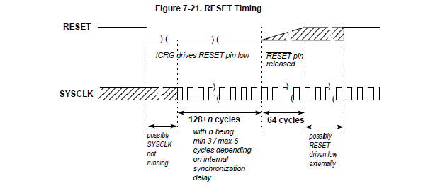

Please check capacitance on the RESET pin.
For example: The DEMO9S12XHY256 board has 100nF capacitor at RESET pin and 10KOhm external pull-up. The board is assembled by the 8MHz crystal.
If we omit internal pull-up and internal capacitance of RESET pin, the time constant t=R*C is 1ms. In this case, the POR reset vector is always used for all type of resets.
The RESET pin is tested after 64 SYSCLK cycles from RESET pin release. For MCU reset, the SYSCLK=OSCCLK. So, it presets 8us time window where the voltage at reset pin should reach a high level which is necessary for correct COP/CM reset source recognition. If we stay with 10kOhm pull-up, the maximum capacitor value at RESET pin should be below approximately 800pF.

Please let me know what is connected to the RESET pin on your board.
Unfortunately, I am not experienced with the Trace32 tool. But, if LED signalizes new MCU start after unvalid ARMCOP register writes, it looks like correct behavior.
Anyway, the COP_ISR() code is useful only if you need to know the reset source (POR, COP, …) and you want to apply different codes per this reset source.
If the MCU behavior after a reset should be identical for both POR and COP resets, you don’t need to bother with COP_ISR() and capacitance on the RESET pin. In this case, you may simply watch RESET pin for testing COP reset.

Hi Kim,
Thank you for these details.
If you want to use COP_ISR() code, you have to disassemble C94 from your board.
As I already wrote above, the maximum C94 capacitance only approximately 800pF may be connected to the RESET pin for correct recognition of COP as the reset source. Higher capacitance (10nF in your case) will lead to the situation that POR reset vector will be used for all kinds of resets – COP/CM resets are detected as External pin reset.
The optional hardware solution is here:
I hope it helps you.
