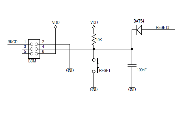

kimchan_eb
Hi Radek,
As for RESET pin, please refer to this:
Enough for this pic? If not I may have to ask my colleague for I don't know much about hardware.
Thanks.
Br,
Kim
8,512 Views
RadekS
Hi Kim,
Thank you for these details.
If you want to use COP_ISR() code, you have to disassemble C94 from your board.
As I already wrote above, the maximum C94 capacitance only approximately 800pF may be connected to the RESET pin for correct recognition of COP as the reset source. Higher capacitance (10nF in your case) will lead to the situation that POR reset vector will be used for all kinds of resets – COP/CM resets are detected as External pin reset.
The optional hardware solution is here:
I hope it helps you.
Radek
