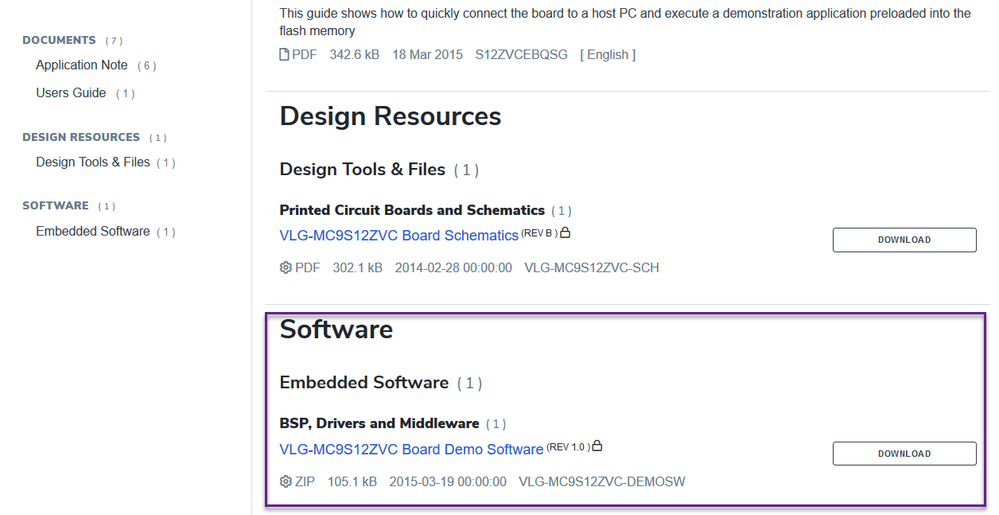

Actually, there is S12ZVC demo that utilizes ADC
It can be downloaded here:
VLG-MC9S12ZVC Evaluation Board | NXP
