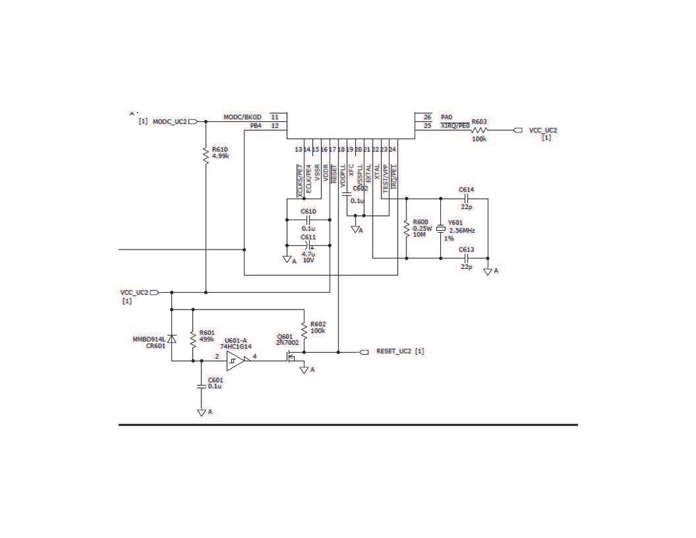

Using a MC9S12C32 controller in a fairly wide temperature application and have occasionally seen the controller hang at hot operating temperatures.  Have noticed a sensitivity on the clock (XTAL) line - probing this signal or adding a small amount of capacitance seems to alleviate the problem, but do not see any noticeable problem with the oscillator signal itself.  The oscillator is a Pierce configuration at fairly low frequency - 2.56MHz.  Has anyone run into this kind of problem?

Have observed a software-generated time interval shifting by 10-20% over temperature even though oscillator signal itself appears to be very stable - seems to indicate a shift in the (internal) clock frequency.

Hi Steve,
Thank you for more details.
Do you use PLL for generating bus clock or not?
If you use PLL, there missing low-pass filter between XFC and VDDPLL pins at your schematic.
If you don’t use PLL, the XFC pin has to be connected to VDDPLL pin.
Please look at Figure 9-2. PLL Loop Filter Connections in RM.
PLL filter calculator is attached.
I hope it helps you.

I would like to see the schematic design.
If it is confidential please create a Case (service request) and sent it to us.
If there is no indo about type of the oscillator please add it.
