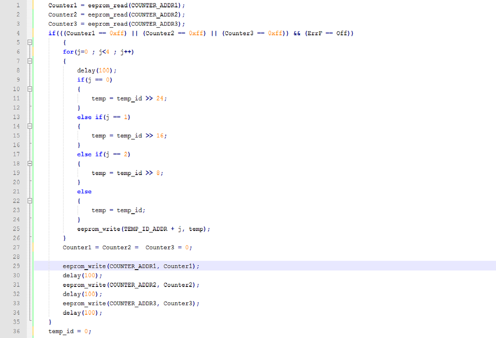

sourabhpatil
Hi RadekS,
System cannot hangs directly on the EEPROM command.
When I ON-OFF the system continuously then after some iteration system hangs.
System hangs means it doesn't come out of the one while loop which is before EEPROM read/write operations, but if I remove EEPROM
read/write then it is working OK.
Software doesn't read EEPROM in any interrupt.
I haven't implemented any exception in software.
In attachment you find the EEPROM read/Write commands.
Sourabh.

Hi Sourabh,
Thank you for more details.
1.    What means “ErrF==0ff”, shouldn’t be there “ErrF==0xff”?
2.    If I understood correctly, you want write 32bit number into EEPROM. The smallest portion of EEPROM which could be programmed is one word = 16bits (Program EEPROM command could program 1..4 words). It doesn’t have any sense to divide temp_id into bytes, you could write whole temp_id variable by single command. Programming address must be aligned to word (global address [0] = 0). Target area of EEPROM must be erased prior programming.
3.    It seems that you don’t handle error codes from EEPROM routines. Therefore you don’t see that your commands failed.
Please look at EEPROM write implementation in my example code.
You could use for example such code:
error = EEPROM_Program(TEMP_ID_ADDR, temp_id, 2);
instead your huge for loop.
I hope it helps you.
RadekS
