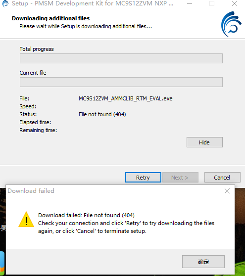

The program of MC9S12ZVML128_PMSM_Sensorless_SingleShunt cannot be downloaded
1,795件の閲覧回数
fanlikang
I am curious why this program cannot be downloaded on the official website.123.png123.png

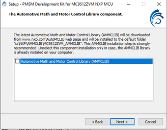

lama
general procedure....
https://www.nxp.com/design/development-boards/automotive-motor-control-solutions/magniv-and-s12-solu...
lama_0-1690359755297.pnglama_0-1690359755297.png...install..
If the installation fails then uncheck following cell
and install the AMMCLIB separately from…
https://www.nxp.com/design/software/automotive-software-and-tools/automotive-math-and-motor-control-...
