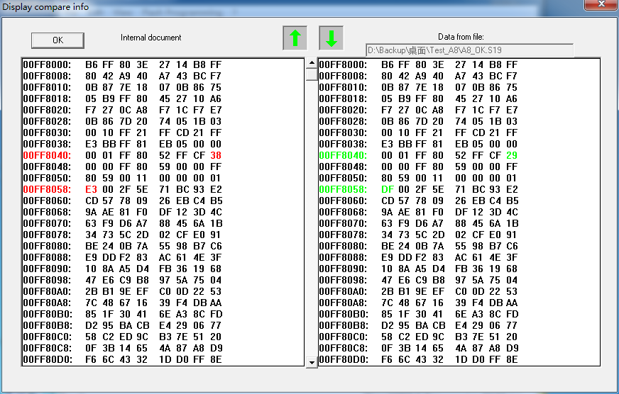

    IC S9S12ZVL32FOMLF LQFP-48 does unpowered ESD,the Flash data is rewritten,The data is shown in the figure below,red is abnormal code, green is normal code, all are read from IC.
    After the circuit board is powered on for about 10 minutes, the PWM output waveform of one channel of the IC is abnormal.
    Why Unpowered ESD causes this phenomenon? Can flash not be rewritten through software enhancement.

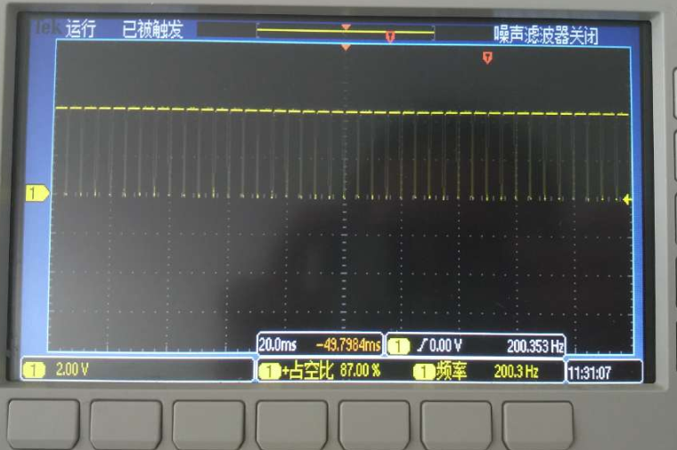

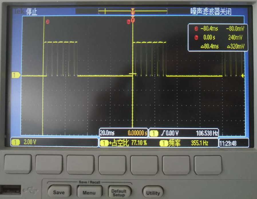

      The sample is not connected to the harness for unpowered ESD test. For the + 15kV air discharge of metal parts, after the discharge, we use CodeWarrior to read the internal code of the chip and compare it。After that, we find different code problems.
      The PWM output is normal at the time of power on, and the waveform is abnormal about 10 minutes later.
                   Figure1  Before the ESD test                            Figure2  After the ESD test
        When we rebuild the program to IC, everything is back to normal. Now we can be sure that the flash code has been changed when there is electrostatic interference, it is near the chip。
