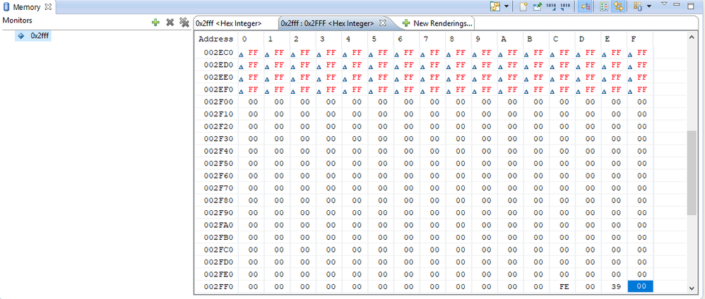

an example of prm file. See modifications in bold.

Result of the modifications is.....RAM 0x2e00~0x2eff is not used by application for variables and it is filled by patter 0xff at the start of the code automatically. RAM 0x2f00~0x2fff is used for STACK.

The filing the stack by known pattern and check how much from it was rewritten by application code is common approach for debug testing whether your stack size is adequal. Typically, we reset MCU by debugger into Startup() code (prior stack initialization), fill stack by debugger and let code run. After some time, we stop CPU and watch size of used stack.
