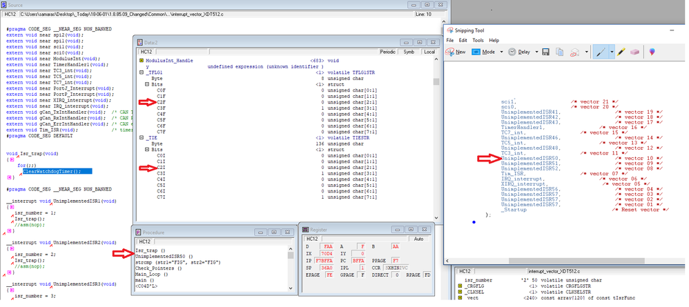

Eric_t
Hi Ladislav,
Finally we got some progress.
We have an unimplemented interrupt of TC2.
It is a bit strange because we never enable TC2 interrupt.

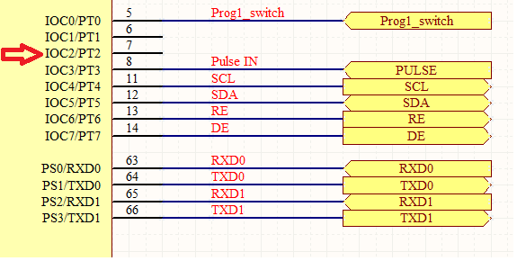

As you can see at the attached picture, the procedure window shows UnimplementedISR50 (in our case is TC2 interrupt), data window shows _TIE.C2I = 0 (TC2 interrupt disable), _TFLG1.C2F=0 (TC2 interrupt flag clear).
Since TC2 interrupt (_TIE.C2I) is disable, TC2 interrupt flag is clear (_TFLG1.C2F), TC2 should never fire interrupts.
I have attached a picture that shows the connections of PORT T.
Our design left PT2 pin unconnected, but firmware set it as output.
(PTT = 0x30; DDRT = 0xF6; RDRT = 0xFF;)
Any ideas why TC2 fires interrupt?
6,581 Views
lama
could you please provide me a project to be able to check entire setup? This issue is not know to me from HW point of view even I am working with the devices for more than decade.
If yo do not want to share it with public you can send it to me via support system. (here is the procedure explained How to submit a new question for NXP Support )
Please, insert into question and/or subject part Assign to Ladislav into Auto 16-bit box.
(One possible issue, PT2 is set to output compare (OC) mode and disconnected from pin logic and enabled. When OC event happens then interrupt is generated.)
Ladislav

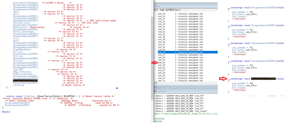

Eric_t
Hi Ladislav,
Our implementations sets interrupt at 0xF310 location (IVBR = 0xF3).
As you can see at the attached picture, UnimplementedISR54 (in our case COP watchdog reset) occurs.
Since "COP watchdog reset" is at fixed address, UnimplementedISR54 interrupt should never fires.
We have moved interrupt (IVBR) to another location and now some other Unimplemented interrupts fires.
It seems that there is some kind of problem with interrupt vector.
Probably TC2 interrupt never fires, it is just some kind of problem of the interrupt vector table.
I want to attached a file with the interrupt vector and the configuration if controller but I do not know how to do it.
6,581 Views
