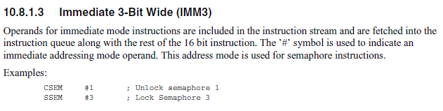

Hi Rajesh,
The functions __csem(sem_id) and __ssem(sem_id) you did not declare the function prototype before, that's why you see this warnings.
According to reference manual instructions for lock and unlock a semaphore are SSEM and CSEM.
You could use two address modes:
For the CSEM
In monadic address mode, bits RS[2:0] select the semaphore to be cleared.
For the SSEM
In monadic address mode, bits RS[2:0] select the semaphore to be set.
Please see the example code above, in the file xgate.cxgate are used instructions SSEM and CSEM.
