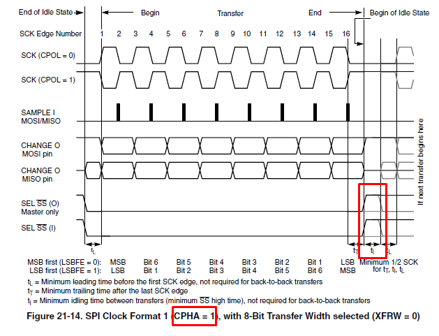

When I use SPI within XEP100 to write to  and read data   from an RAM chip(FM25640),I found the program stop in while(!SPI0SR_SPIF) ,I dont know how to solve this problem,anyone who have a good idea give me some suggestion,thank you!
Here are init ,write and read programs.

RadekS
Hi  &#21016; &#38134;
I am slightly confused from your CS(SS) bit configuration. The SPI0CR1 and SPI0CR2 configuration specifies, that SS pin is driven by SPI module. While CS_D=ON; commands looks like manual driven SS pin.
Anyway, you selected CPOL=0 and CPHA=0. In that case, bytes (or words if XFRW=1) must by divided by SS pin line toggling (SS line is always deasserted and reasserted between successive transfers for at least minimum idle time)
So, if you use manual driven SS, you must toggle SS pin twice between bytes.
Possible solutions:if
1. If you use manual driven SS, add code for SS pin toggle between byte transfers.
2. Use SS pin signal generated by SPI module
3. Use CPOL=1, CPHA=1 configuration (SPI Mode 3 per FM25640 datasheet)
Important note:
Please be aware, that while(!SPI0SR_SPIF); command cannot be debugged in stepping mode. The SPIF flag is cleared by read SPISR register with SPIF == 1 and then read SPIDRL register. That reading is applied also by debugger when you step over code – debugger clears SPIF flag by register reading when CPU halt.
I hope it helps you.

921996194
Hi Radek,
Thank you for your suggestions. I tried the third soulution(Use CPOL=1, CPHA=1 configuration), and it worked.I used the CS as an I/O port, not the SPI module.Although I dont know how it worked .Thanks a lot .
Ben
2,701 Views
RadekS
Hi Ben,
You are welcome. I am glad that it works now correctly.
Yes, the CPHA = 1 is most typical solution.
This difference is visible also on SPI waveforms in RM:
