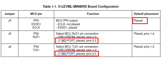

I tried with the default configured "SCI1" module, but the "SCI1" module is not working. The issue with "SCI1" module is as I connect external device to "SCI1" port, transmitted data  from MC9S12ZVML128 doesn't arrives on the port pin.
(I did all jumper configurations as described in user manual, still "SCI1" port dont work)

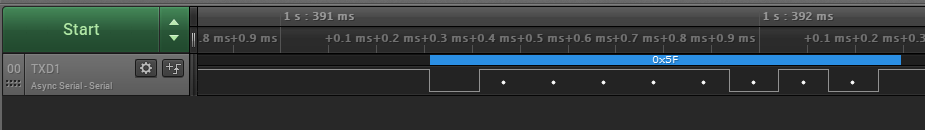

I have received information that you have still an issue with the SCI transmit on the S12ZVML-MINIBRD.
So, I have made for you a very simple test code without interrupt which just transmits data through SC1 on the S12ZVM-MINIBRD. Please, refer to the attachment.
I have verified that data are transmitted on the TXD1 pin (pin number 3) of the J7 port.  Is this what you need? If not, could you please elaborate your issue?
My board settings and tool:
- Debugger: USB multilink interface connected to BDM (J3)
- CodeWarrior 11.1
- 12 V power supply
- J8 and J6 position 2-3
Important note: SCI1 should be routed to PS2, PS3 pins (because only these pins are connected to J6/J8)
MODRR0 = 0x08; //Route SCI1 to PS2, PS3 pins
Please, could you try it and let me know how it works? You can load the code as-is into the MCU.

1) I am sure that you have checked transmission through SCI1 (USB to Serial Terminal) and it works fine, I too experienced it before.

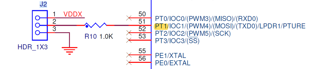

But the major issue is when I connect external device (e.g. ESP32) on J7 SCI port (Pin 2: RXD, Pin3: TXD), I couldn't see any data. (I kindly request you, please connect the external device on J7 SCI port and observe it) . as you said that you have verified that data are transmitted on the TXD1 pin (pin number 4) of the J7 port, pin number 4 is not used for TXD1 (Its GND), please verify again.

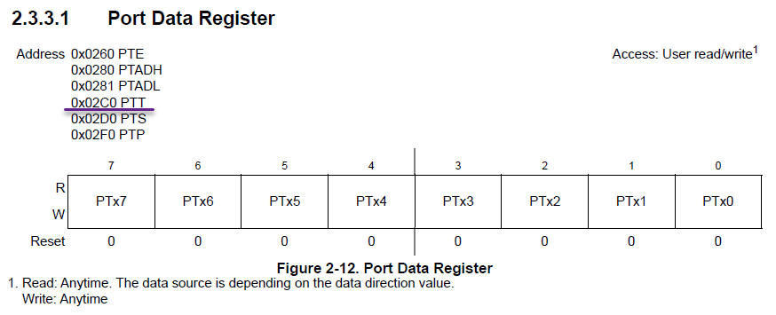

2) Regarding my second question related to PT1 on J2, I want create an interrupt on PT1 and run the motor, I pulled PT1 on J2 High (by connecting it to VDDX), Unfortunately, it doesn't work. (I kindly request you please check and confirm, Is Port T pin (PT1) a dedicated hardware pin capable of receiving external interrupt request?).
I would like to inform you, in S12ZVML-MINIBRD User Manual (Document Number: S12ZVML-MINIBRD_UM 1.0 04/2014) in chapter 5, it is clearly written that the motor can be controlled using the J2 header, placing the jumper short bar to J2, pin 1-2.

The S12ZVM MCUs do not support pin interrupts on PT1.
Please see the S12ZVM RM rev2.13
The SW for the miniboard is not controlled by the PT1 pin but by FreeMaster (ctrlStates.usrControl.switchAppOnOff variable).
The document: S12ZVML-MINIBRD_UM 1.0 04/2014 is from 2014 and the SW has been changed since then.

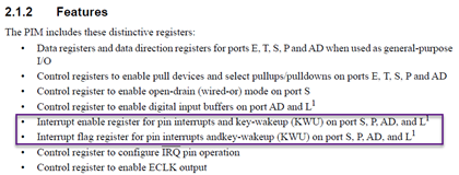

swapnil_chougul
Hello Daniel,
I wold like to address you in the document available on NXP  portal (https://www.nxp.com/docs/en/quick-reference-guide/S12ZVMLMKQSG.pdf ) it is clearly written that motor can be run/stop with the junction J2, which is connected to Port PT1.
could you tell me, the S12ZVM MCUs do not support pin interrupts on PT1 then why it is described in manual??

danielmartynek
Hello Swapnil,
The document does not say anything about interrupts.
BR, Daniel

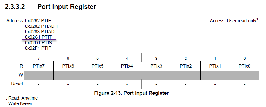

24,496 Views
danielmartynek
Hello Swapnil,
Out of reset, the PT1 pin is a digital input.
If the pin was open, it would be floating.
If J2 is in position 1-2, the pin is connected to VDDX, the state of the pin (log. HIGH) can be read by the SW.
Similarly when the pin is connected to the ground.
But the current version of the SW does not do that.

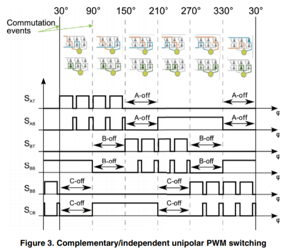

Regarding my third question to control the PWM channels, I want to configure PMF module in "Complementary low side fixed" mode, by referring document below.
I hope this application not is for all S12ZVM MCU, if I am wrong please let me know.
Is there is any additional application note for S12ZVM MINI Board (S12ZVML128 MCU)??

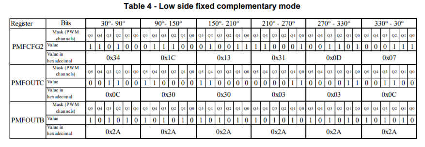

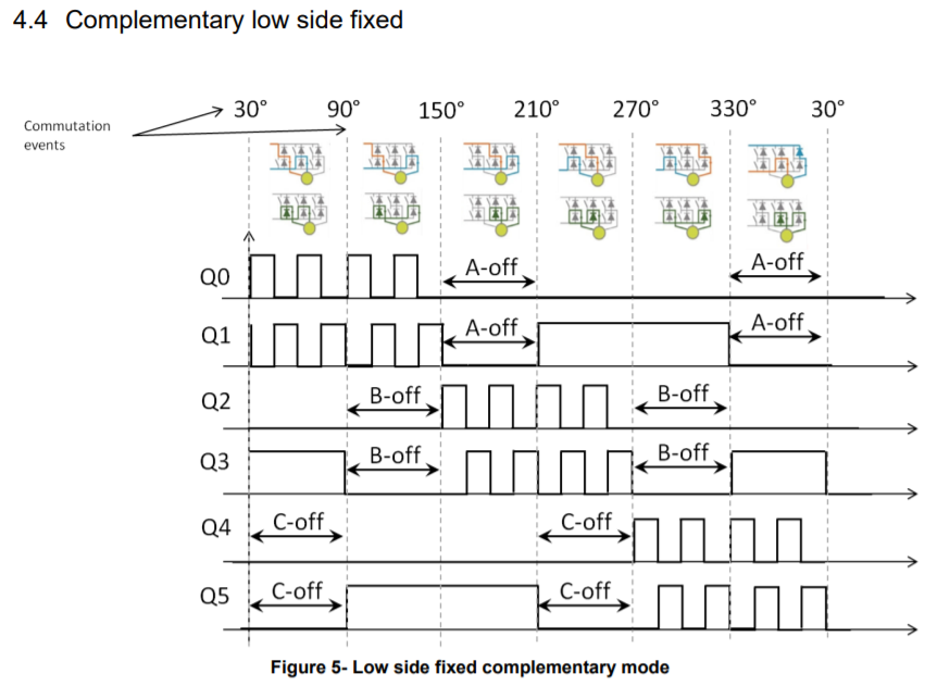

24,497 Views
danielmartynek
Hello Swapnil,

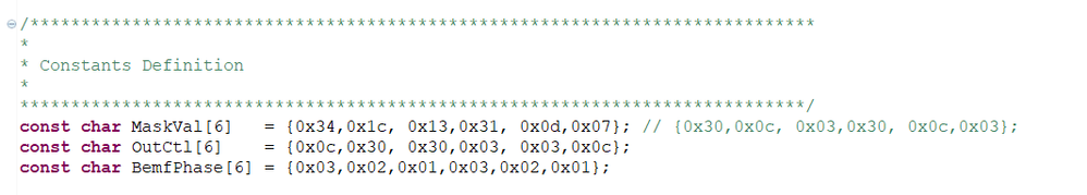

The AN is for all the S12ZVM derivatives, it shows use of the PMF module.
The S12ZVML-MINIBRD_SW software already utilizes this so called “Complementary low side fixed” mode as you can tell from this table (MC9S12ZVML128_BLDC_Sensorless.c):
* Constants Definition
const char MaskVal[6] = {0x34,0x1c, 0x13,0x31, 0x0d,0x07}; // {0x30,0x0c, 0x03,0x30, 0x0c,0x03};
const char OutCtl[6] = {0x0c,0x30, 0x30,0x03, 0x03,0x0c};
const char BemfPhase[6] = {0x03,0x02,0x01,0x03,0x02,0x01};‍‍‍‍‍‍‍‍
24,497 Views
swapnil_chougul
Hello Daniel,

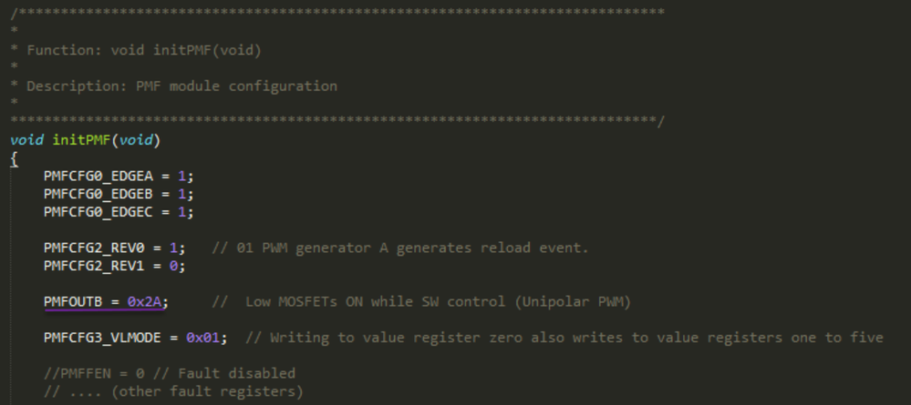

if you see in the AN S12ZVM derivatives, it shows use of the PMF module.
Register PMFOUTB hex values to control PWM channel is 0X2A as per the AN but in the Application code the values used are 0X03, 0X02 and 0X01 respectively, which doesn't  make any logical sens with the Application Note S12ZVM derivatives.
could you send us the AN where we can find the reference of this values(0X03, 0X02 and 0X01) used in the application code.
Thanks.
Swapnil

dianabatrlova
Please first, let's solve the first query because it is related to this thread.
1. I'm very sorry it was a typo I mean J7 SCI port pin 3 (TDX1 as I said). I edited my answer.
Actually I connected logical analyzer to J7 pin 3 TDX1 pin and I can see the data. (refer to the first image). Please, can you do the same?
So, please, could you tell me if you tried the simple test code which transmits 0x5F data? Have you seen the data on J7 SCI port pin number 3?

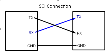

swapnil_chougul
Hello Diana,

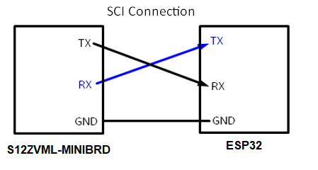

As I told you before, the major issue is when I connect external device (e.g. ESP32) on J7 SCI port (Pin 2: RXD, Pin3: TXD), I couldn't see any data.
When I transmit any data, I can see it on J7 SCI port pin number 3 ,only if I connect logical analyzer or Oscilloscope, but as  connect external device external device (e.g. ESP32)  I couldn't see any data.
I kindly request you, please observe it by connecting any external hardware at the J7 SCI port.
I have also tried with different Hardware's, but there is no change with the result ( No data appears) .
I am also attaching the video, kindly have a look.
Thanks.
Swapnil.
24,497 Views
dianabatrlova
Hello Swapnil,
I made some tests and I connected external device (Devkit S12ZVL128) to S12ZVML-MINIBRD through SCI.
And I'm able to receive and transmit data by S12ZVML-MINIBRD and also, by an external device.
 I assume that your issue could be in SCI settings of your external device or in SCI connection.
 I recommend you to check the baud rate, parity, stop bit, start bit settings, etc.
Please, check the connection with the external device.
 I assume that the issue is not on our side.
Diana
24,497 Views
swapnil_chougul
Hello Diana,
I am really wondering about your tests.
I would like to inform you, with the following settings( Baud-rate:9600, Data Bit: 8, Stop Bit: 1, Parity Bit : None(0)) pastedImage_1.png
SCI connection, (USB to SCI) jumper J6 and J8 placed, pins 1-2 , S12ZVML-MINIBRD is able to transmit and receive the data. That implies the all the SCI settings are correct.
But, SCI connection,(J7 to SCI) jumper J6 and J8 placed, pins 2-3 , S12ZVML-MINIBRD is unable  to transmit and receive the data.
The connection with external device is not too complicated.
I believe your assumption that issue is not on your side.
Personally, I am not satisfied with your assumption. I have already sent an Video from our side for addressing these issue.
I kindly request you, please suggest an effective way to address our issues and find the effective solution.
Swapnil.
24,497 Views
dianabatrlova
Hello Swapnil,
If you see the TX data on a scope when ESP32 is not connected, but you don't see them when ESP32 is connected, then, the issue is certainly in your HW.
Diana
24,497 Views
swapnil_chougul
Hello Diana,
As you told, you made some tests and connected external device S12ZVML-MINIBRD through SCI.
 And you are able to receive and transmit data by S12ZVML-MINIBRD and also, by an external device.
I kindly request you please send us the code you used for test, the specifications of device ( useful for SCI) and settings of the deceive you connected.
Swapnil.
